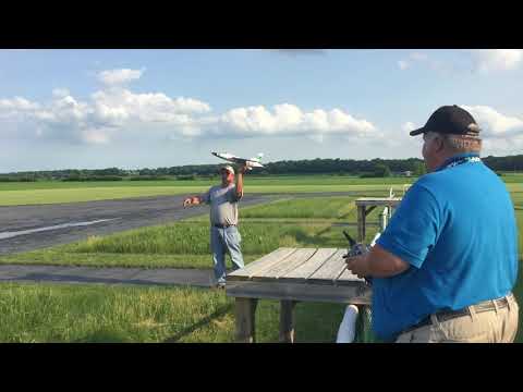

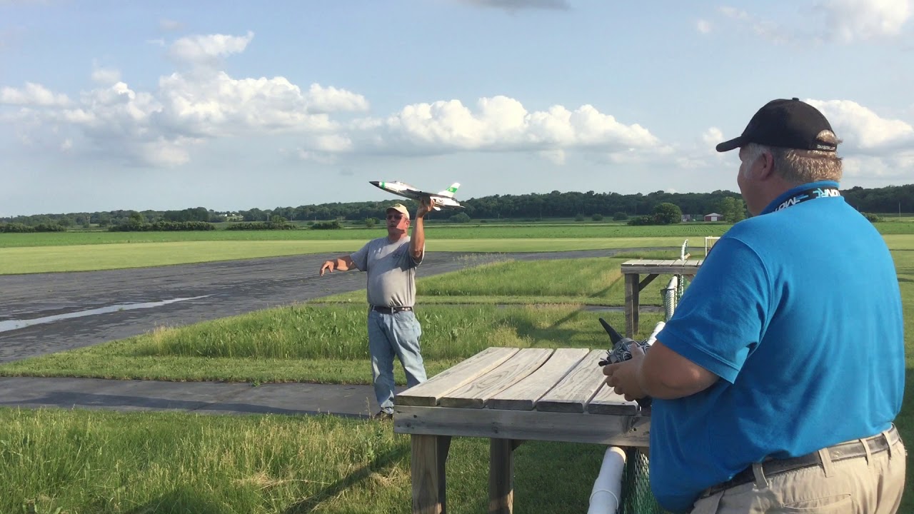

                • Well my maiden did not go well, a hand toss right into the water on the runway. Watch all 13 seconds of the video. The motor does not work, I'll try it again once I know it is dried out.
                    • Nothing wrong with your plane.... just saying.
                      • Needed a much more aggressive throw I think. When pilot Robert Petrinčič did his he really gave it a heavy rip into the sky

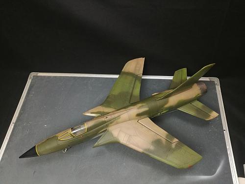

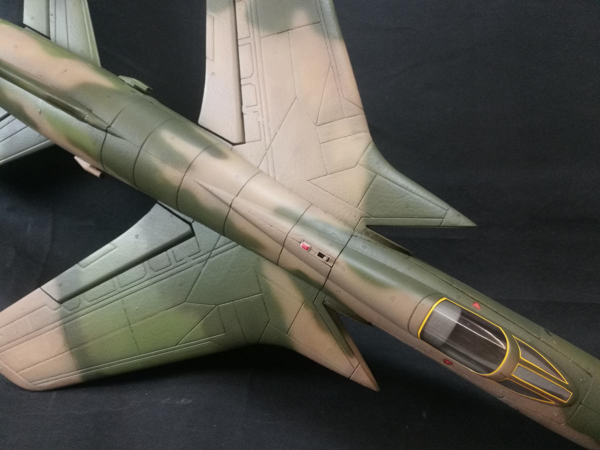

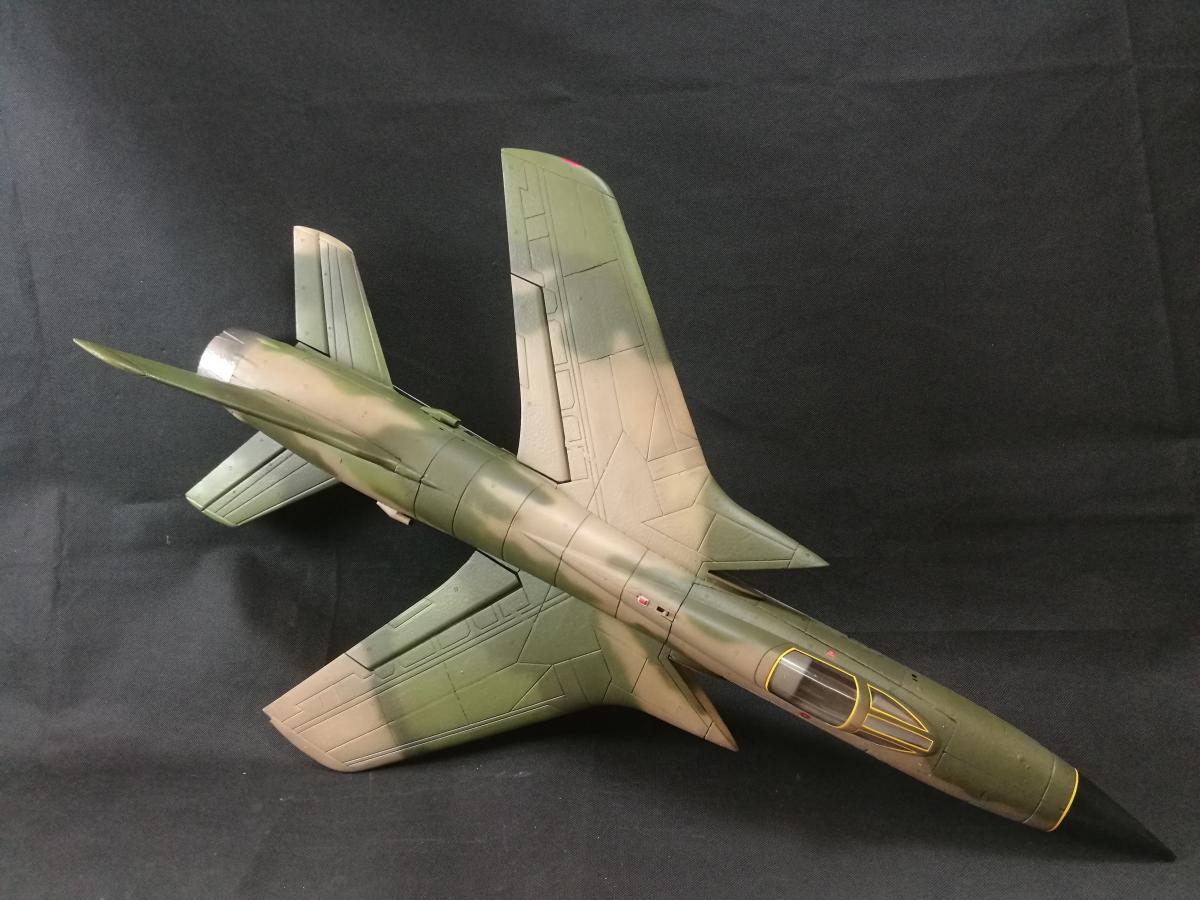

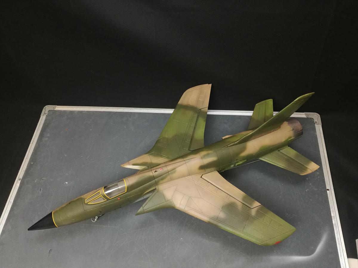

                                    • Filming a tutorial video and this is the result. Stay tuned for the video itself next month. The 3DPUP files (rear fuse inlet blisters, pilot, and beacons) will be gradually uploaded over the next week or so. Attached first are two of them.
                                      Click image for larger version  Name:	IMG_20181022_053617.jpg Views:	1 Size:	113.2 KB ID:	157514Click image for larger version  Name:	IMG_20181020_042749.jpg Views:	1 Size:	78.4 KB ID:	157513
