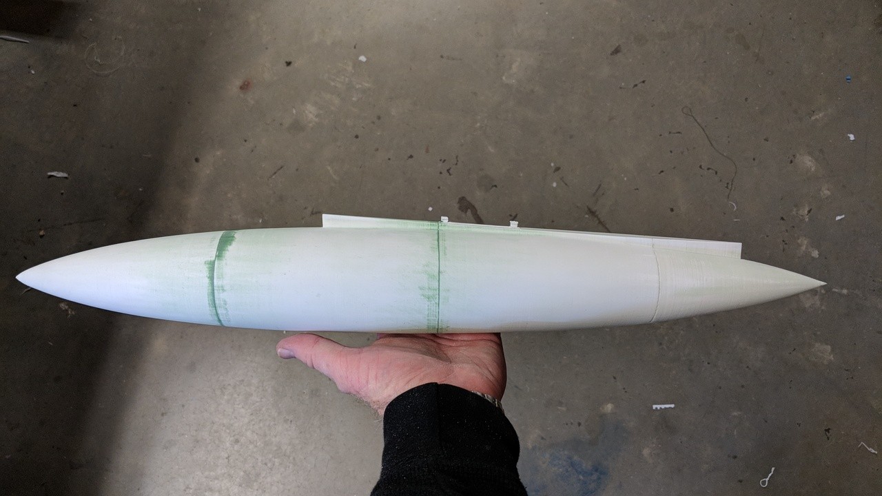

          • I have completed some ordnance / external storea and uploaded them to thingiverse.
            SU23 . STL files are constrained for a print bed of 200mmX200mmX180mmadded Pylon
            600 GALLON centerline fuel tank and pylon---- Updated to better scale and pylon mountAdded Hollow version
            A big thanks to rcjetdude for the help with the 600 gal centerline tank.

                              • I added the flange files to thingiverse. Flange ring 1,2,3 the are in order from front to back. Note, these will only work with spiral or outer shell only prints.
                                • After assembling the fuel tank with spiral printed tank sections and the joiner rings with contact cement, no sanding, no filling, no paint or primer my tank comes in @1.9 Oz.
