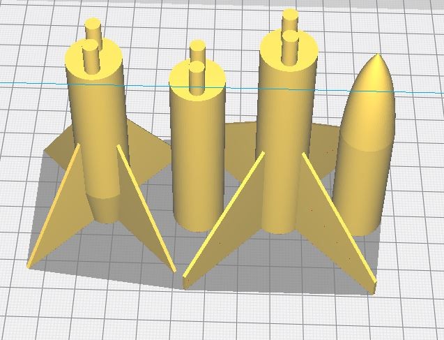

                                Ok, here is the file, I've set this up to be a full print, within a Z limit of 100mm which is a personal restriction of my printer
                                Note this file is in imperial units, and should be imported in inches) the diameters should check out to be 0.6933" or about 17.6mm
                                Other Notes:
                                I recommend using rafts particularly at the fins, and supports in the hollow areas of the cylinders and the bottom of the cone
                                I went with about 10% interior fill pattern, and this still weighs in at about 47grams in PLA ( but we all need a little nose weight anyway it seems)
                                4 fins forward and rear are included, but you may only need 3 depending on your mounting method.
                                There are no indexes include to align the sections, a bit of modelling skill will be required.
                                The fins are compression fit, and you may need to trim/sand/chamfer the edges to get them into the slots, depending on the shrinkage of your material and accuracy of your print.
                                If you are an absolute scale nut, this is not that, it's designed to fit well on this model and give the appearance of a full scale missile.
                                If anyone really needs or wants this broken into individual components, let me know, or the cad file is available as well.
                                Use at your own risk, and good luck!

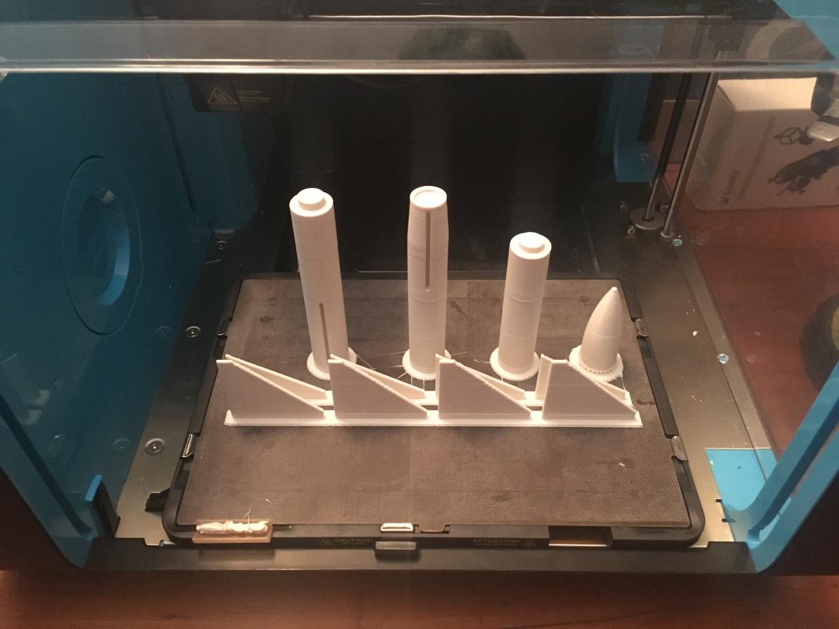

                                I think Estes may make smaller rockets than this!
                                8.5 hour print, I'm seeing a few offsets, nothing a little prep work won't cure , I could have gone for thinner layers, but I think for their purpose these will be fine, and I hadnt done a full set print yet, wanted to prove the file was good to go
