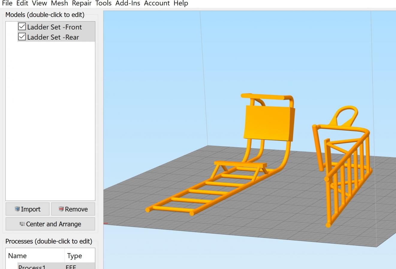

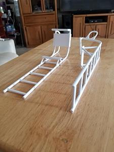

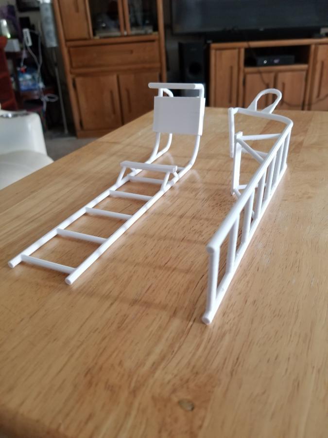

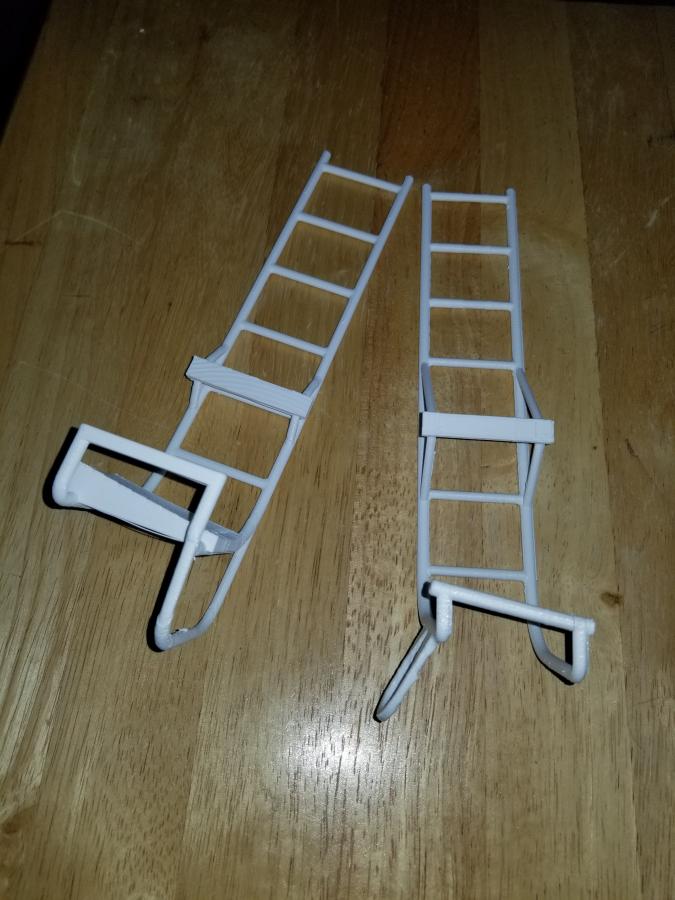

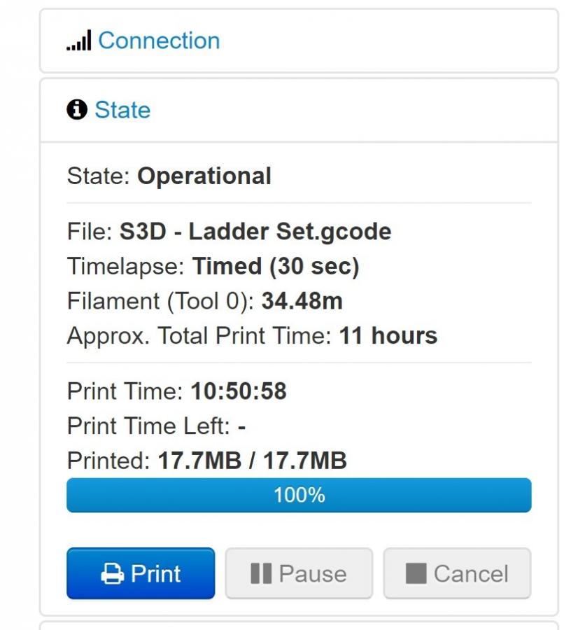

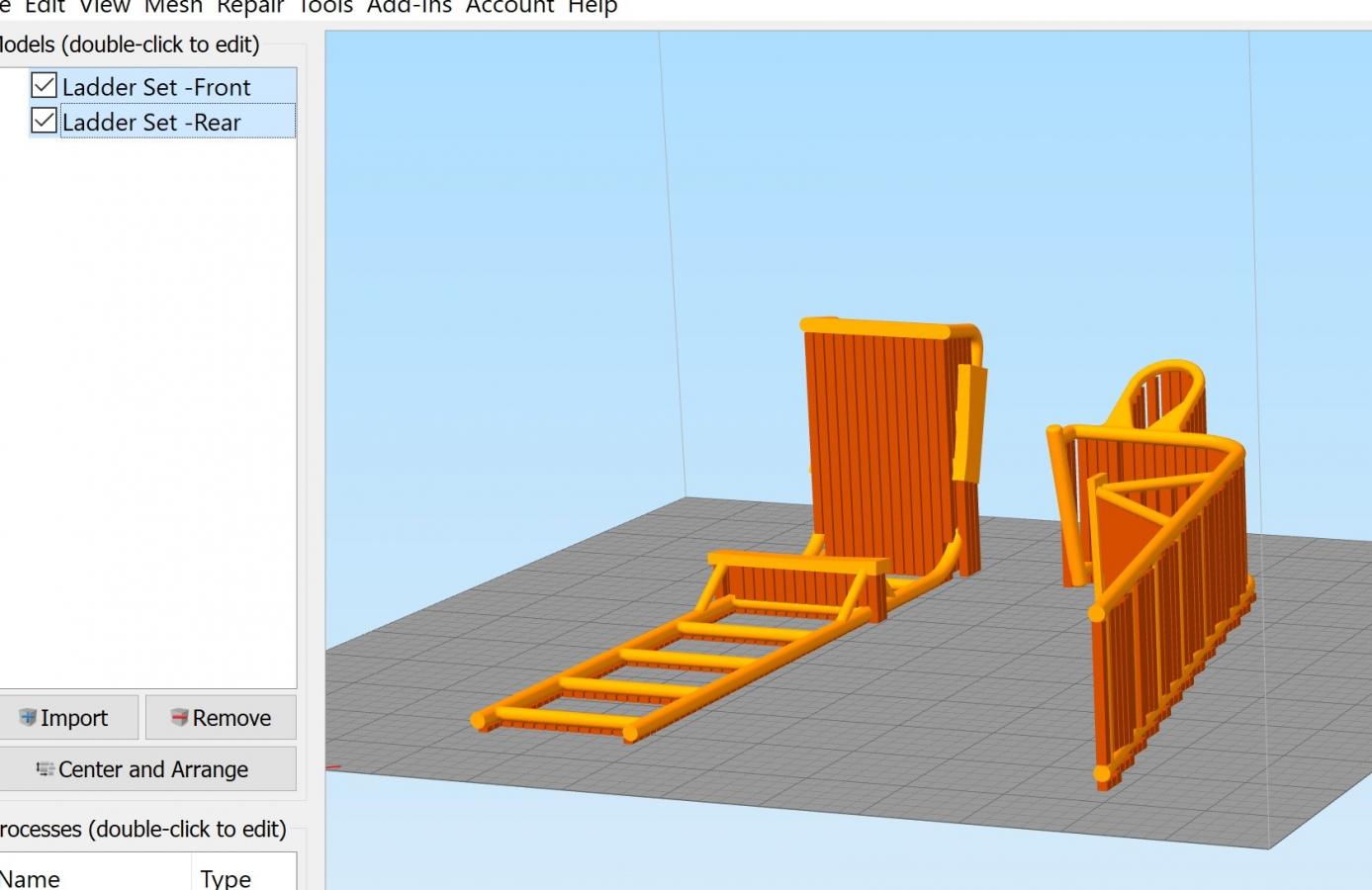

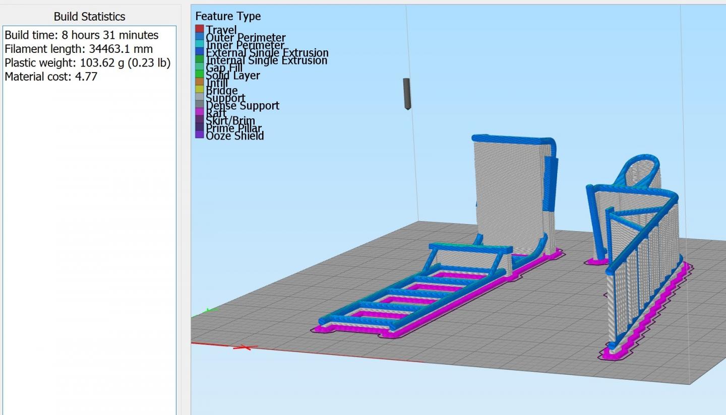

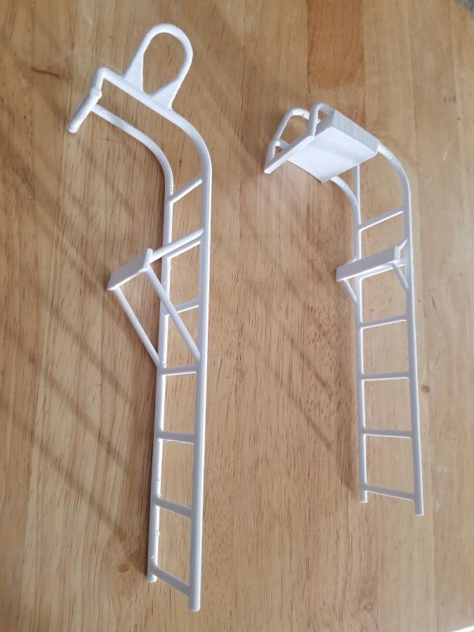

                  #48

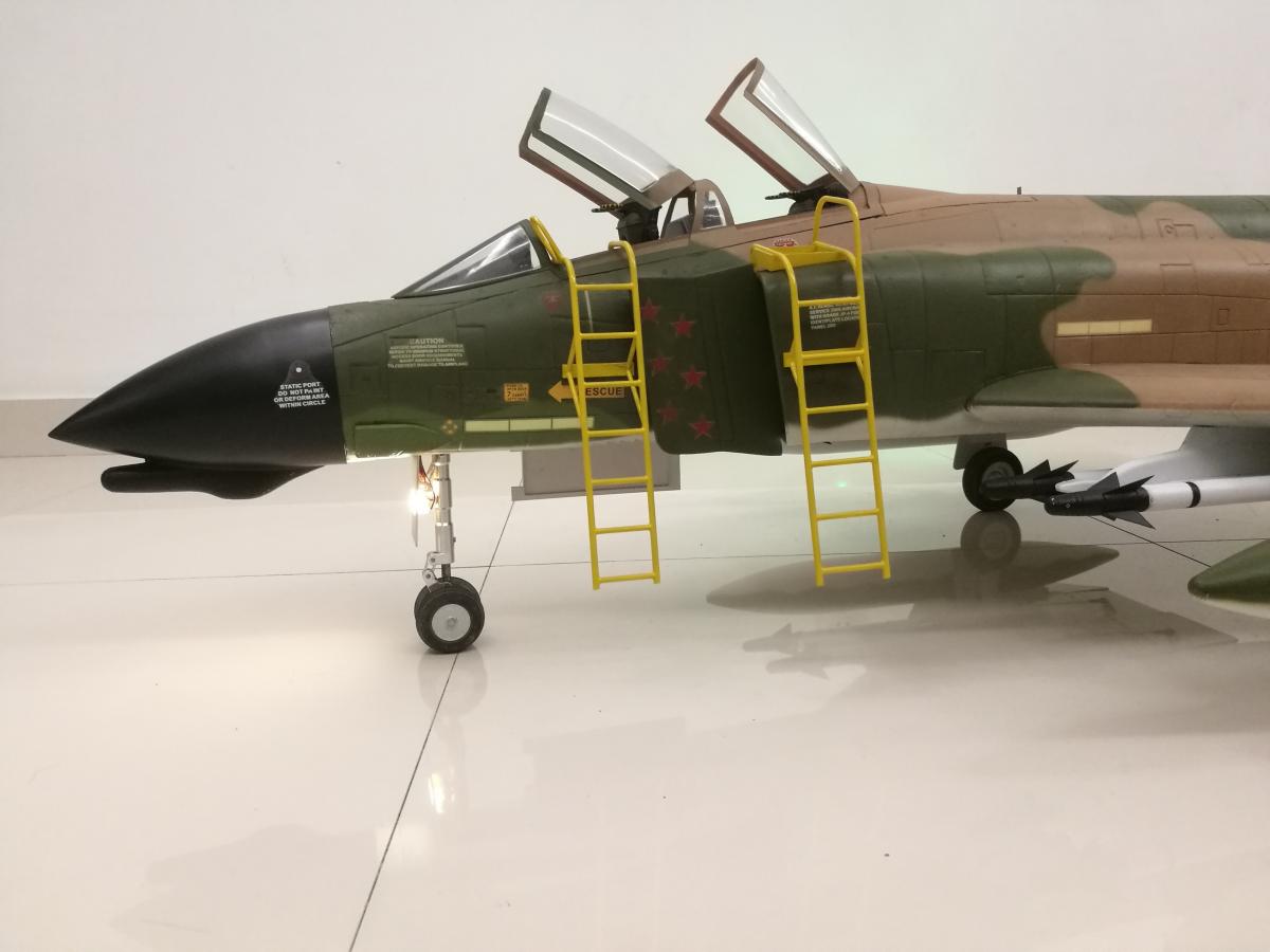

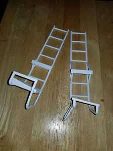

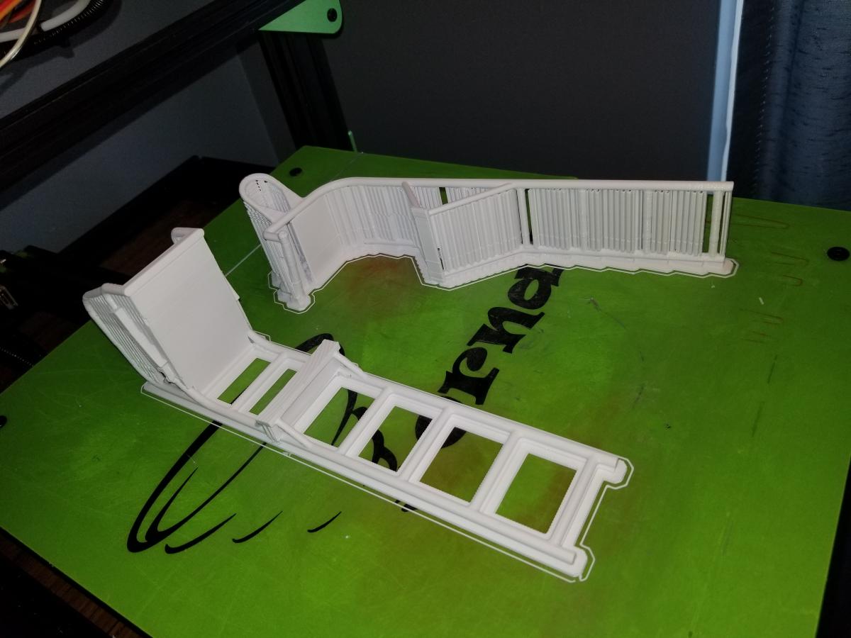

                  1st attempt at printing the ladders. Trying different placement positions to see if it affects final print quality and removal of supports.
                  Click image for larger version  Name:	F-4 Ladders.jpg Views:	1 Size:	90.4 KB ID:	125042Click image for larger version  Name:	F-4 Ladders Supports view.jpg Views:	1 Size:	96.3 KB ID:	125043Click image for larger version  Name:	F-4 Ladders Layer View.jpg Views:	1 Size:	107.7 KB ID:	125044Click image for larger version  Name:	20180325_123705.jpg Views:	1 Size:	88.8 KB ID:	125045Click image for larger version  Name:	20180325_125834.jpg Views:	1 Size:	74.6 KB ID:	125046Click image for larger version  Name:	20180325_130000.jpg Views:	1 Size:	67.1 KB ID:	125047Click image for larger version  Name:	20180325_130238.jpg Views:	1 Size:	59.2 KB ID:	125048Click image for larger version  Name:	F-4 Ladders Print time.jpg Views:	2 Size:	62.2 KB ID:	125049
                  • Dirty Dee
                    • 768
                    • Northern Illinois

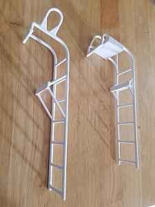

                    #49

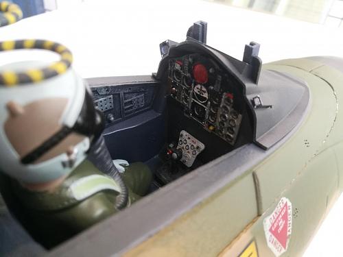

                    what layer height you using? looks like a good print
                    • Flash Jorden
                      • 77
                      #50
                      Using .2mm layer height. They both printed very well. I'm actually pleased with both of them. There a little surface roughness to them, so I'm going to try printing at .1mm just for S & G's to see what happens.

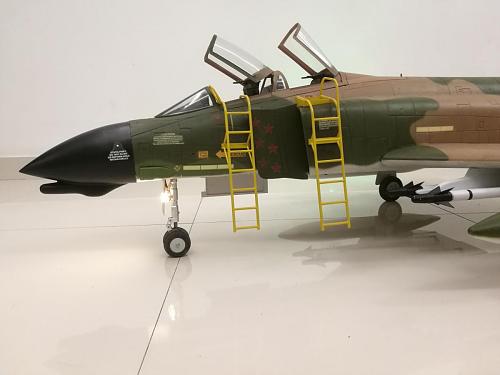

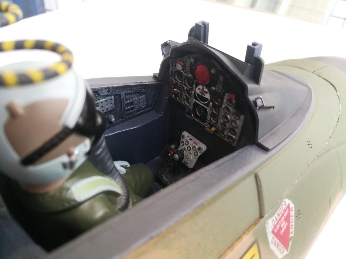

                        #51

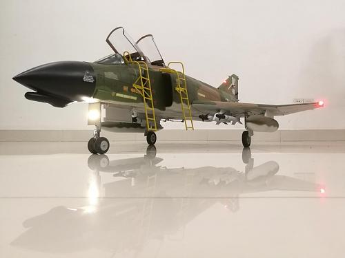

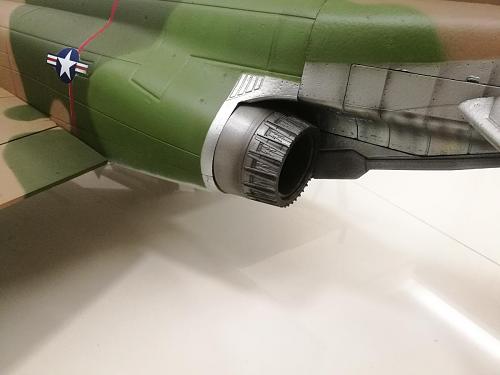

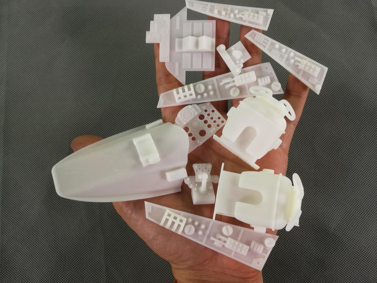

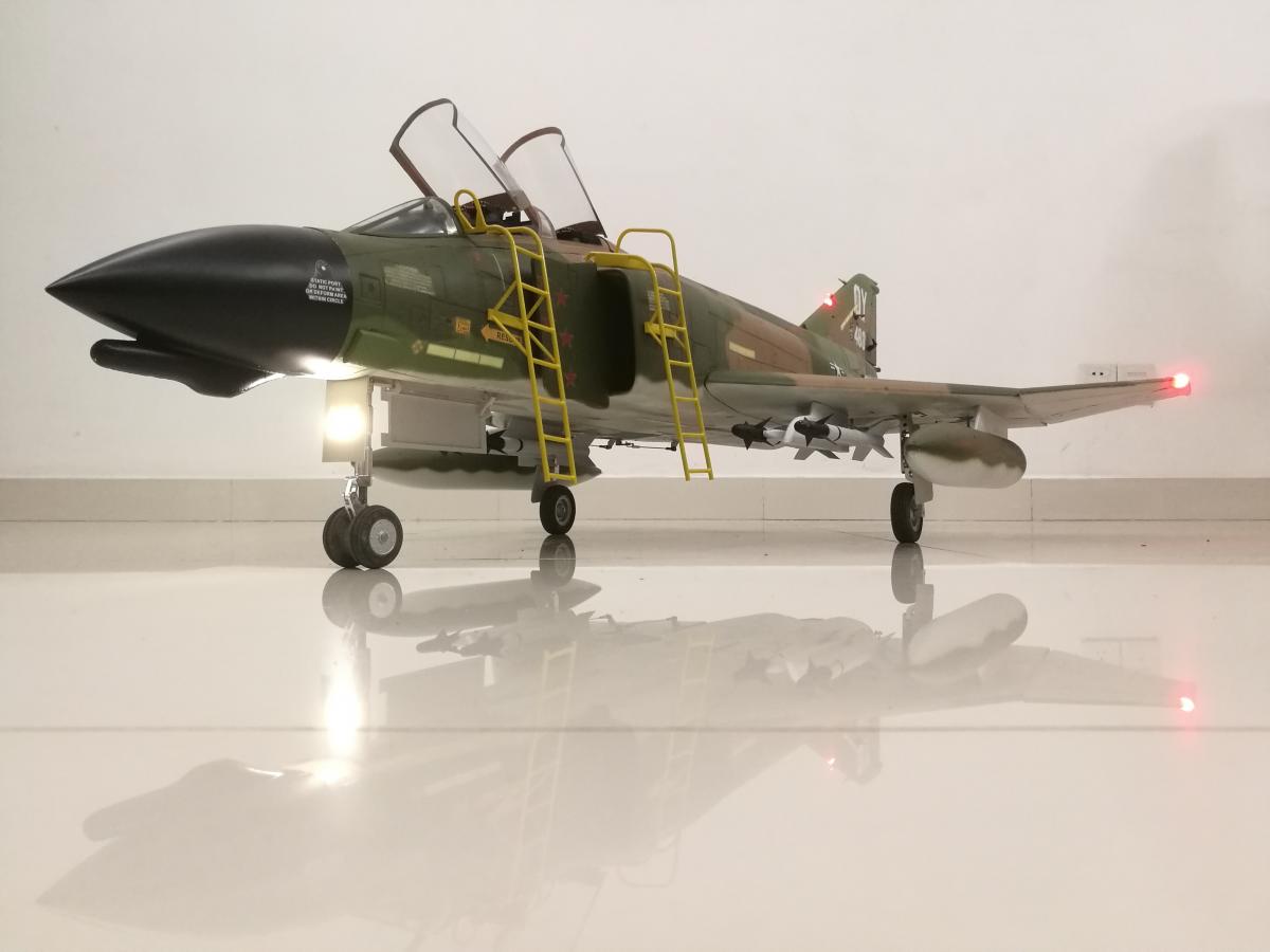

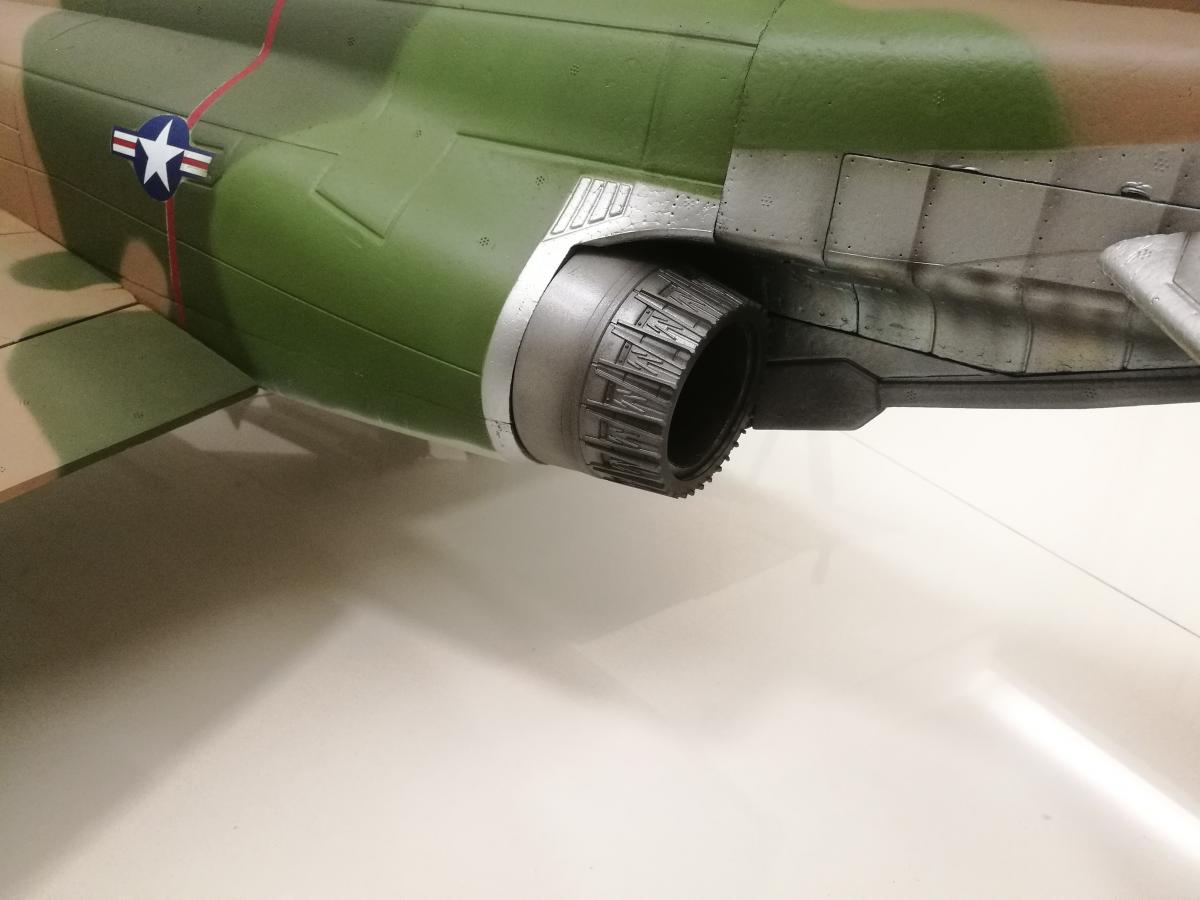

                        Here’s a better look at the finished product in place with little exhaust and weathering

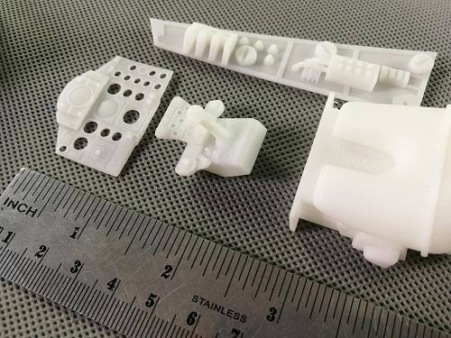

                          #52

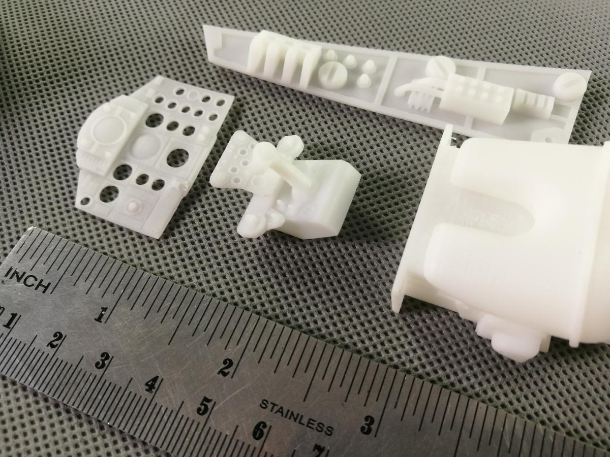

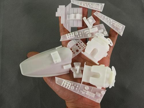

                          I love seeing the enthusiasm and ingenuity, guys, thank you for your support! A few responses and tips:

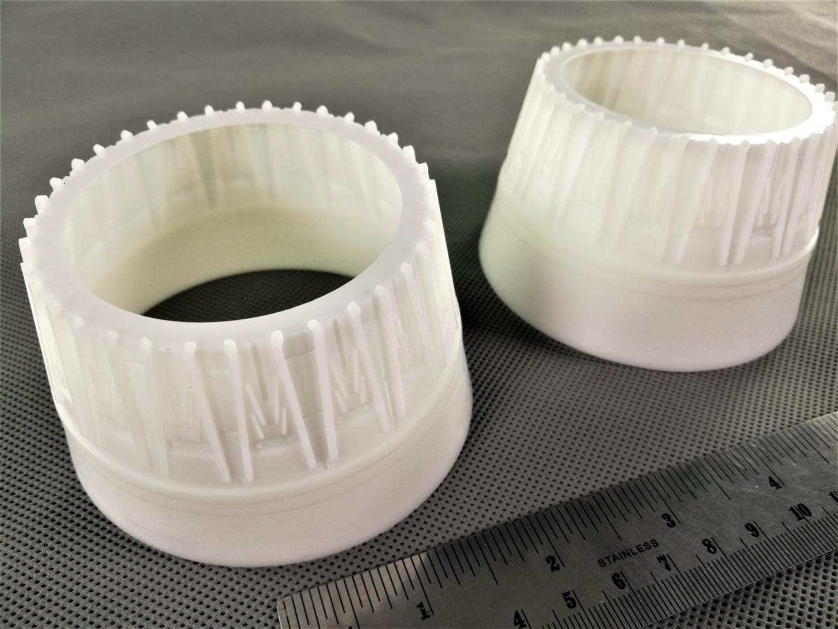

                          *RCJetDude, I know you already know this, but long overhangs will kill your efflux, so be sure to extend your stock foam nozzle's inner diameter outward to the lip of your custom extended 3DP nozzles.
                          *Acetone vapor smoothing has been shown to work for ABS and some types of PLA, but as always, test your specific filament first. Not all PLAs are the same.
                          *As some of you have commented, matching the print quality, resolution, and finishing of our industrial printers here at the factory isn't easy. We provide the files for free because we want people to try it, understanding that they're putting in their own time to work it all out. Some of us like to tinker. For those wanting to avoid all the technical aspects of taking a file to an actual high resolution print, I'd agree with the observation that our pre-printed sets are very reasonably priced.
                          *The nozzles are intended to slide over the stock foam nozzles in seconds, as shown in our installation video. Slicing the foam and the 3DP both to shorten to a more accurate total length is possible for those wanting even more accuracy, although be mindful that the foam nozzle's ID is not concentric a couple centimeters inward from the outlet, so don't cut too deep.
                          *Regarding reselling or otherwise monetizing our files, yes, for now we are not permitting such a thing. We want the files to remain free to help jumpstart interest in this initiative.
ID:	125440Click image for larger version
Name:	Cockpit Set -3.jpg
ID:	125437Click image for larger version
Name:	Cockpit Set -4.jpg
ID:	125439Click image for larger version

                                  Hey Alpha, while I did shorten the length of the foam nozzle about 5/8" I also maintained the ID of the foam nozzle on my 3DP nozzle. I noticed it is not concentric and I did not want to cut it back too far so I blended a little foam filler, not much, to smooth the inside of the foam duct and eliminate a small lip created by my part. My solid modeling skills in CAD are not there just yet to blend from one shape to another so I kept it simple and sacrificed some scale appearance but once painted I think it will look good and I don't think I have hindered it's performance any.
                                  So far, I have not been able to touch the quality of the 3D parts MRC will be offering. Nice job!
