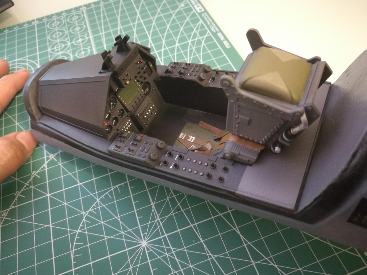

        Keep going on the Sparrow! I want to print a couple for the forward stations.
        The sky really is the limit with this 3DP stuff.
        That’s looking great!!

          This is for sure the coolest thread on the forum. Great work everyone, this is a lot of fun to keep up with.

                        Looking great ! What is the FS number for the F-4 interior color? I know all the German & US Interior colors from WWII, but not the Phantom. Thanks!
