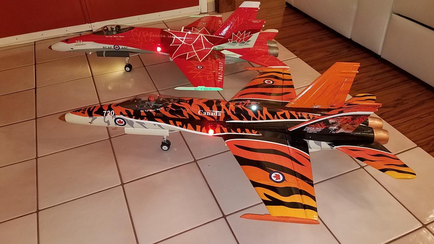

            Originally posted by Monki69
            Hi, I just bought a grey F18 and I want to remove all the decals. I tried using a hair dryer but I haven’t had any success. What do you recommend?
            Agree with Evan D. I've repainted 2 90mm F18's, both originally grey. Suggest you first paint a white primer over everything for better paint adhesion and so your final colors come out true.
            Like This: Both are now 8S, sweet! 🤙

              #6046
              What is your average flight time with the 8S setup?
              Rich

                    #6049
                    I'm using either an SMC 8S HiV 5900 (972 gr) or 4900 (840 gr). On the 4900, 5:30 and on the 5900 over 6:00, but I usually use the 4900 as it flies better with that pack and 60% throttle is great cruising speed, where the 5900 needs a bit more throttle especially on take off and therefor is not as efficient! The 8S power is outstanding for grass take-offs. If I was on asphalt, the 6S most likely would be fine with an SMC HiV 6S 5900 (750gr).
                    Thanks Hugh, I fly exclusively off pavement with 5000/5700 batteries and I average 5:00 to 5:30 depending on how extreme I get with the flying. What's nice about pavement and my full flap taileron setup is a shorter takeoff with 80% throttle.
                    Rich
