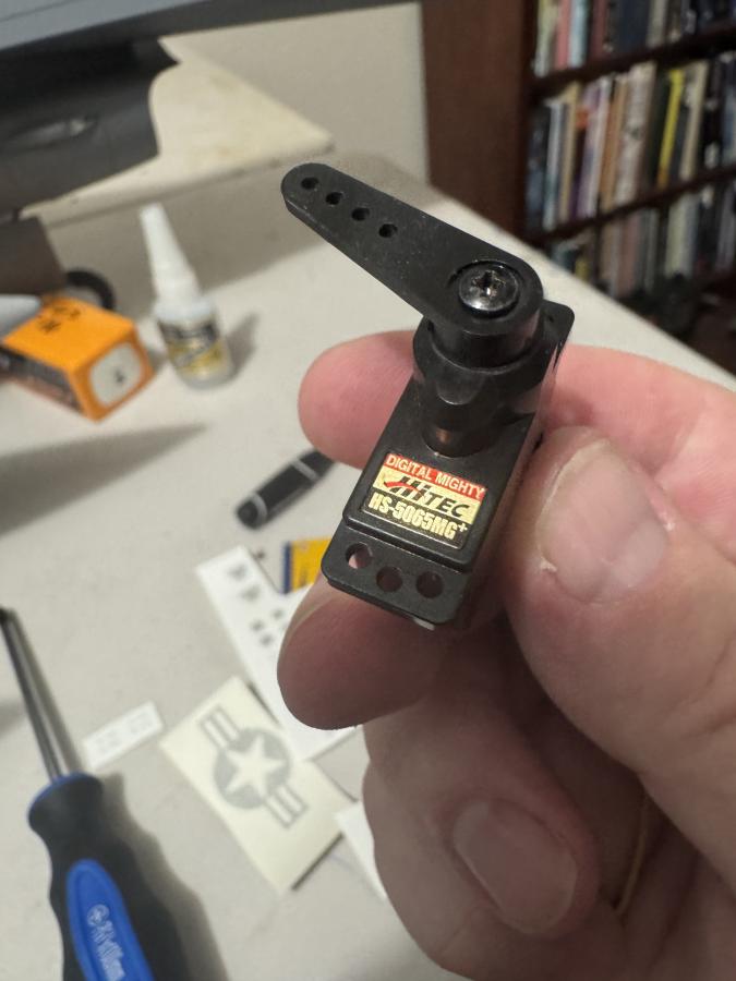

    I swapped ALL servos in my F-18's to Hitec. For the elevators I'm using Hitec HS-5065MG Ball Bearing Digital Metal Gear Sub-Micro Servo, all the rest are Hitec HS-5065MG Ball Bearing Digital Metal Gear Sub-Micro Servo. You will need the Hitec HFP-30 Digital Servo Programmer and Universal Servo Tester to reverse one of the elevator servos. Now, why did I do that? The flap servos failed on 6th flight and MotionRC basically said F-CAW-F when I requested service about the issue. They said the same thing when I purchased an ECM for the F-18 and the battery lead was WAY too short. They directed me to Amazon to purchase a battery lead extension. Anyway, I am very pleased with the servo upgrades. I have confidence now.

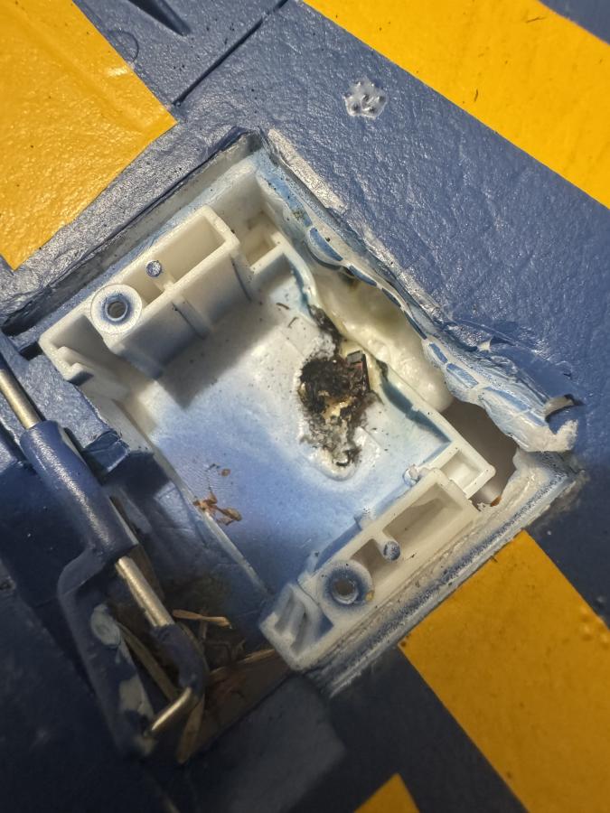

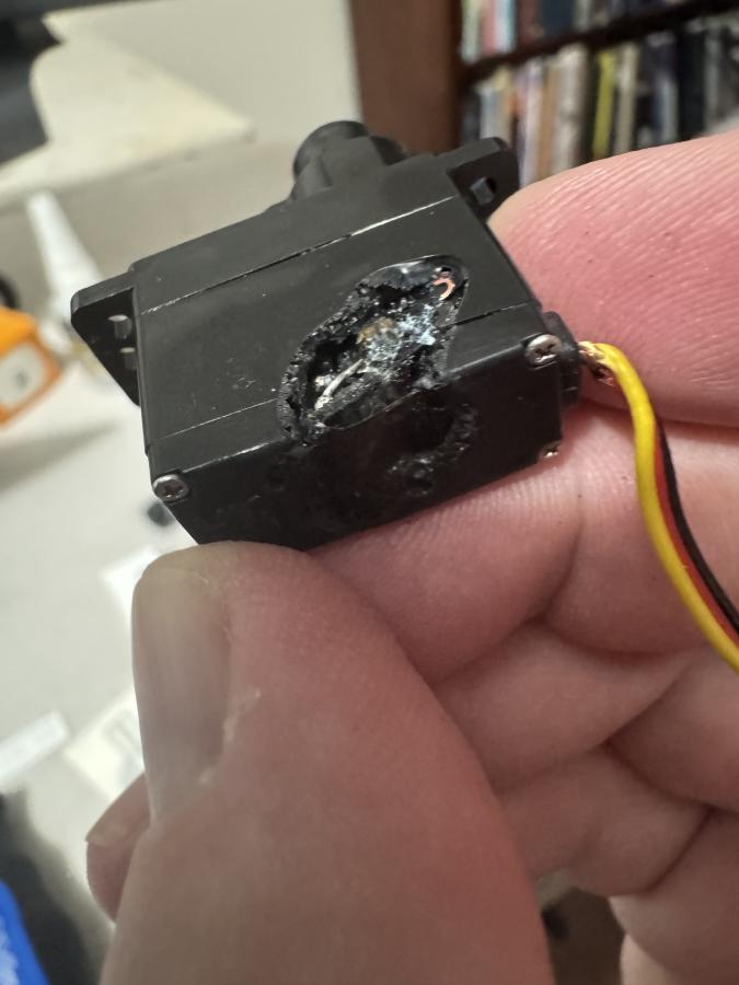

          Elbee is going to come after me for not following his voodoo-freeing ceremony to a tee! So this is what I get…
          So last weekend I went to remaiden. Plugged in the battery and started on all my preflight checks when suddenly I started to smell that dreaded electrical smell like something was burning. Suddenly I noticed one of the flap servos was smoking. EEEK!!
          I immediately unplugged the battery and discovered the Hitec servo started to melt which in turn started to melt the plastic housing.
          If any of you weren’t convinced this particular model of mine isn’t cursed, maybe this will persuade you.

            I kinda think Hugh has a point about locking this one in the closet and I'd toss in some Holy water before ya close the door. OTFL

          Aros, you know that might have been the issue all along. If the servo was acting up, the current draw could have been seriously drawing on the whole system giving you a brown out, fades, holds etc. Just something to look at.
            Well that could certainly explain why it was banking severely regardless of aileron input if the flap was down during flight which is how it was when I plugged in the battery!

                    Remember, these big multi servo jets can lose it pretty easily if the current through all the servos overloads the Rx. Lights, flaps down, retracts, and flight controls all run close together when setting up for landing. This makes the biggest amp draw and that's typically where brown-outs occur. There are quite a few things one can do to mitigate this problem. One of the easiest is to simply use a flight pack to run the Rx instead of the BEC. Batteries give a constant power feed. BECs pulse power. The low points from a BEC is what'll get you if enough stuff is running.
                    You can also plug in a capacitor into one of the Rx slots. They make 'em. It helps keep extra energy when you need it most. Heavier servo leads/extensions make a difference too. The MiG-29 originally shipped with 3 feet 30ga stock ext going back to the tailerons! That's a huge no no in the electrical world. And, folks wondered why it was dropping out of the sky!
                    If you have one servo hanging up and drawing a bunch of current from an already over-loaded BEC, it could be enough to dip the voltage to the Rx too low even for a split second, which can stop current from getting to the rest of the system.
