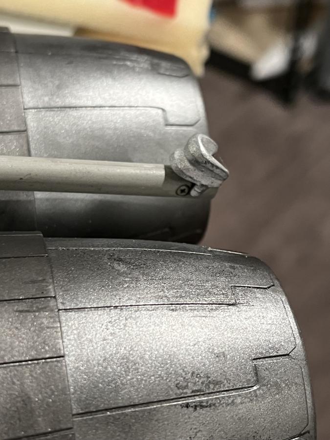

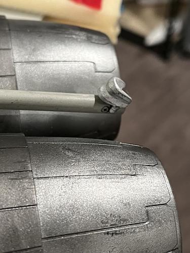

    did an experiment carving out a more scale tail hook end point "shoe" for the Hornet. First attempt out of basswood, might try another one but this one suits me, for now.
    Cheers
    Davegee

          #5784
          Originally posted by Elbee
          DG, Well it's like I always say, "If the more scale tail hook end point "shoe" fits, wear it." Best, LB
          Thanks, LB. This was V2, just "eyeballed" and dremmeled (is that a word?) from a small block of basswood. I can easily remove it for a V3 or V4 version, if I decide to go that far. For now, it'll work.
          Cheers
          davegee

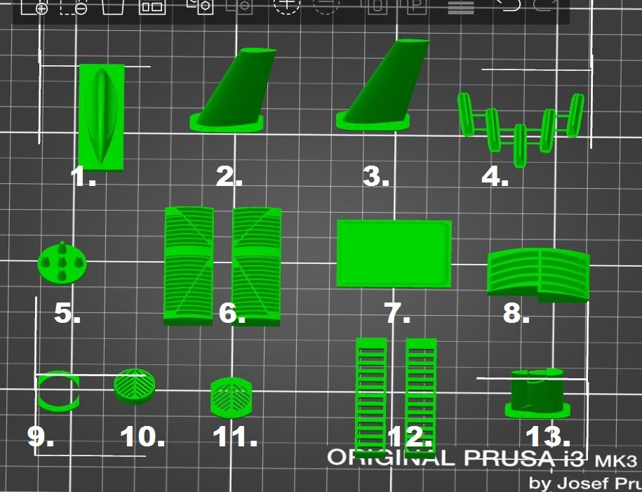

                                      https://www.printables.com/model/958...es-and-antenna
                                      Hornet Honchos.
                                      I know I am a bit tardy with these files.
                                      I've posted the 3DP files for all the fuselage vents, louvres, and antennae I added to my Legacy "BUG" on Prusa Printables.
                                      As usual these are downloadable for free. WooHoo!!
                                      Some of these parts require some 'foam surgery' which violates any warranty real or imagined, but nothing new about that.
                                      Any issues, let me know.
                                      Best, LB
