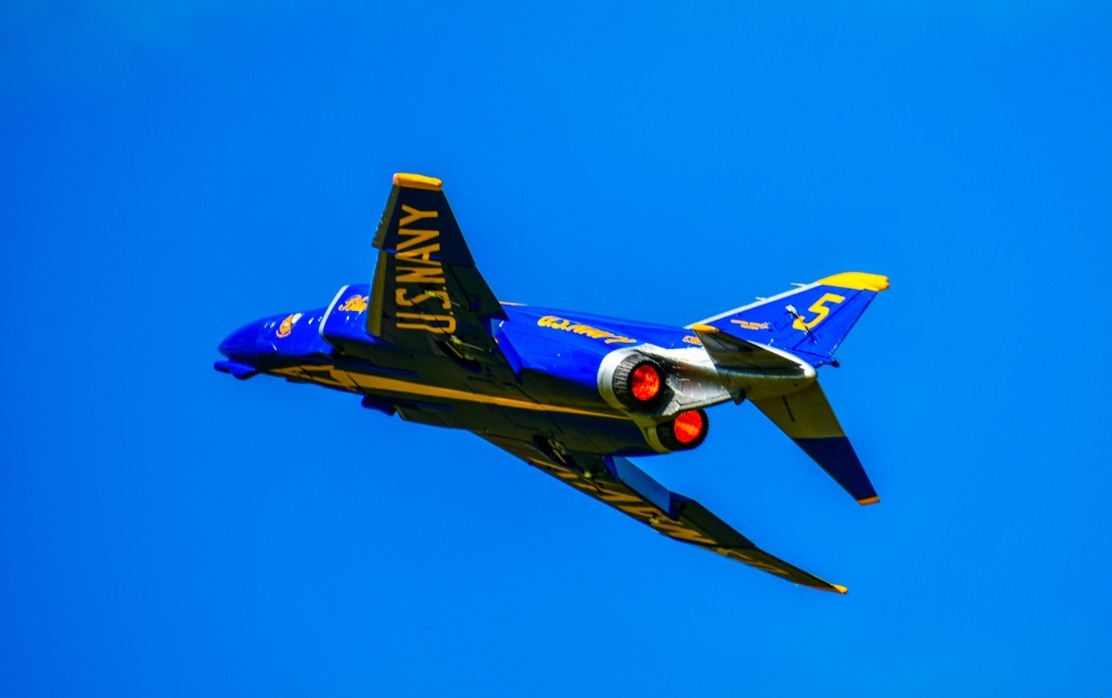

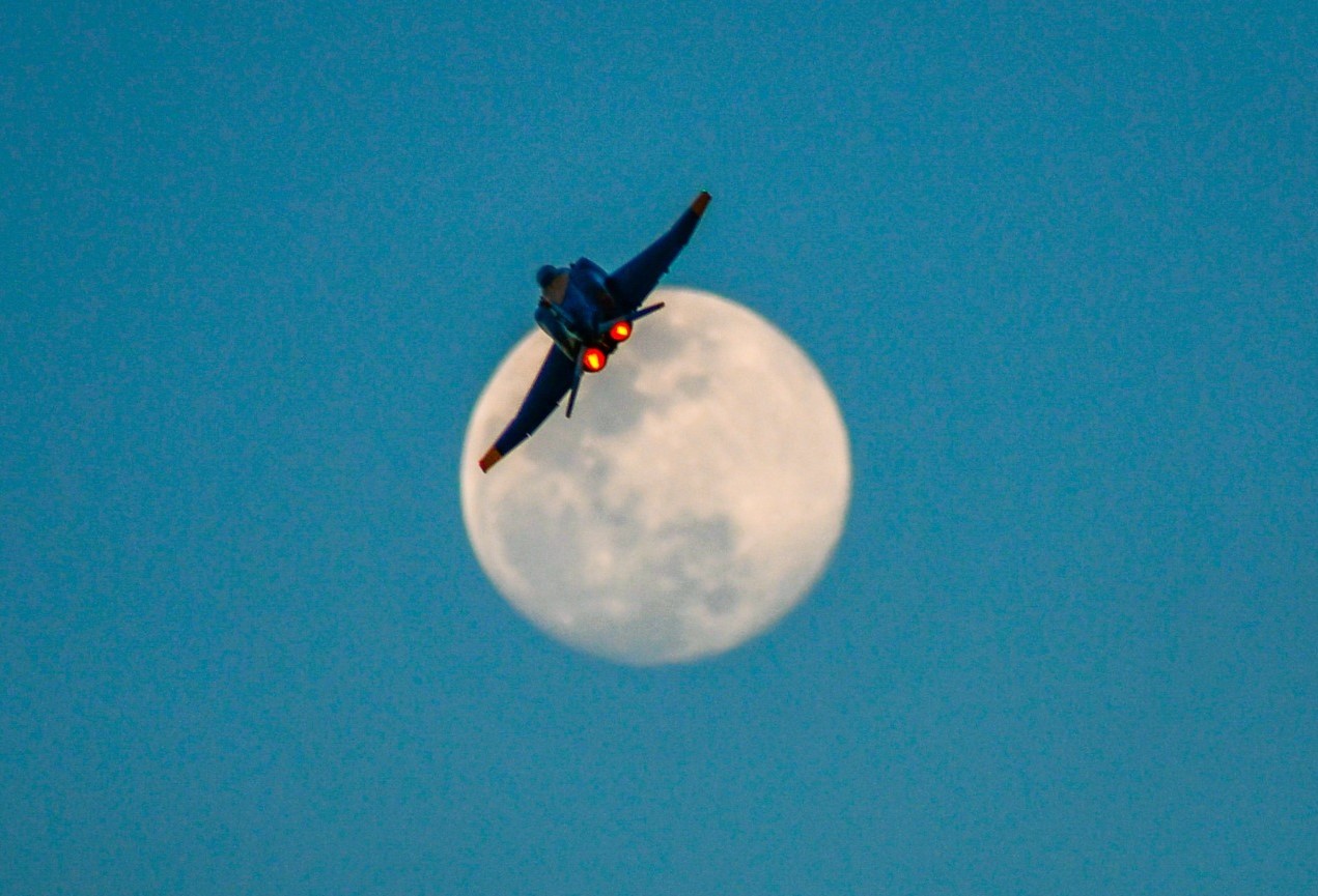

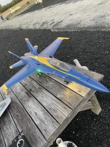

    Originally posted by InTheTubeDeep
    Nice Video, but you should have the F4 Blue Angel, on 8S, it flies much better! Bang Zoom, to the Moon Alice!
ID:	397972 Click image for larger version
ID:	397973 Click image for larger version
    Sorry, Couldn't Help Myself!

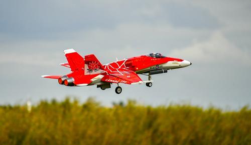

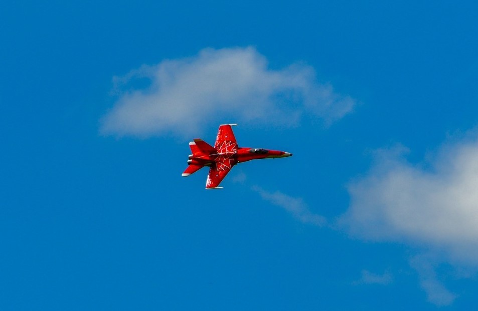

      No Really, got out last week and we got some great photos of the F4 8S Blue Angel, F16 8S Wild Weasel, one of My two 6S F18's the Canadian and a few others I put on a video below of just still photos.
      The F18 starts around 2:45 into the video if you want to skip directly there. Here's a couple F18 photos to wet your appetite:
      Click image for larger version  Name:	#2B.jpg Views:	0 Size:	90.9 KB ID:	397976 Click image for larger version  Name:	#6.jpg Views:	0 Size:	43.9 KB ID:	397977 Click image for larger version  Name:	#5.jpg Views:	0 Size:	38.4 KB ID:	397978

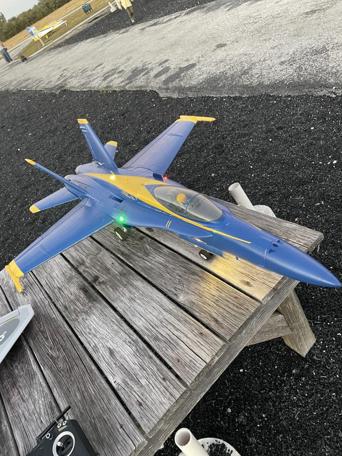

            Not the most forgiving jet, but indeed rewarding when dialed in. I had to do a rebuild as I lost reception and she went crazy on a high speed pass then flipped over.
            This very incident prompted me to buy a new Radiomaster TX16s and Lemon 7channel telemetry receiver with satellite, I had to become proficient in math and algebra to get her back up in the air. Smh.
            Click image for larger version  Name:	IMG_0262.jpg Views:	0 Size:	179.5 KB ID:	398163
