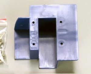

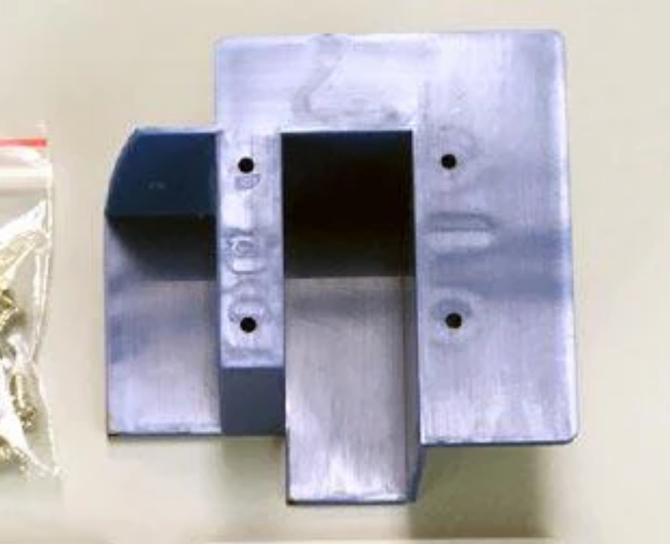

              Has anyone ever replaced the nose gear blue bracket? Mine snapped and came out of the foam cleanly. I got a new one but I see no realistic way of getting it in there. Trying to get 4 angles at once is pretty much impossible. I would like to not cut away any foam making it weaker than it already is if possible. Been angling this thing for 2 hours trying to find a way to get it in there. Half tempted to cut off the left side of the bracket and use some wood to make it fit tight again.
                • 8804
                #5647
                Are you talking about the nose gear "mount"? This thing? I'm surprised it came out cleanly. It's got so many "catch" points where pieces of the broken part would be sandwiched between foam.
                Click image for larger version  Name:	Screenshot 2023-03-04 164604.png Views:	0 Size:	449.5 KB ID:	372593
                Remove as much stuff out of the nose gear bay first - doors, retract, rods, etc.
                You will not get this piece back in without removing some foam. You may need to cut out small blocks of foam (slice with Xacto knife) where necessary so you can work it into place. Once you get it in place as a test fit, remove it and put epoxy where all the flat surfaces mate and shove the piece back in. Hold it in place till the epoxy cures (5 min. epoxy so you can hold it for that long). Once cured, epoxy all the little blocks of foam you cut out. This will wedge the piece in place be quite solid. However, this will make the next repair extremely difficult.
                  • 4852
                  #5648
                  Hawk4me, Copy xviper's advise.. If you use the "Kit Glue" (little white tube of clear adhesive) strength will not be a factor. It is the OEM and the foam will break before the glue joint. Cut away what you need to make a clean removal and re-install, but save as much of the EPO foam to replace and fill back in. If you can't find any of the OEM Glue, use Beacon Foam Tac adhesive available at Hobby Lobby and amizonian, obviously. Best, LB
                    • 8804
                    #5649
                    As Elbee just said, FoamTac repairs of this nature can be amazinly strong, particularly when used in a "sandwich" type of situation. In fact, the glue seam is generally stronger than the surrounding solid foam and any new cracks and tears will happen there rather than in the glue seam. I only use epoxy as my example because you only need to hold it for a few minutes. FoamTac will require you to hold it for much longer but this can be done by using a jig or stuffing wads of cloth or paper towels to hold it all in place while things cure.
                    • Hawk4me
                      • 18
                      #5650
                      I finally got it in there by cutting the back left vertical piece on the image shown above. After cutting that off i was able to wedge it in there enough with some effort to get it in. Used epoxy on the horizontal tab in the back. Then used CA along all the seam's to make sure it's in there good. I was surprised it popped out like it did very little damage to any foam in the gear bay. My guess is it was not glued in very well from the factory. Most of the damage from the "crash" was from the gear breaking off from the bracket and hitting the bottom of the fuse. Going to finish up the assembly tomorrow and see if I can reinforce anywhere as it seems to be a weak area due to how thin the foam is up front. Already see a spot on the lower edge left side of the bracket that could be beefed up a bit with some wood and I already have a wood bracket cut to go in some spots to. Thanks for the tips though guys I got it pretty much factory with no foam cutting so go me on that one lol.

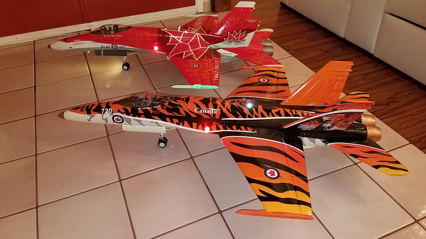

                                    #5658
                                    Better late than never they say...

                                      #5659
                                      Can’t top that! Awesome!!!
