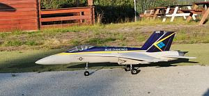

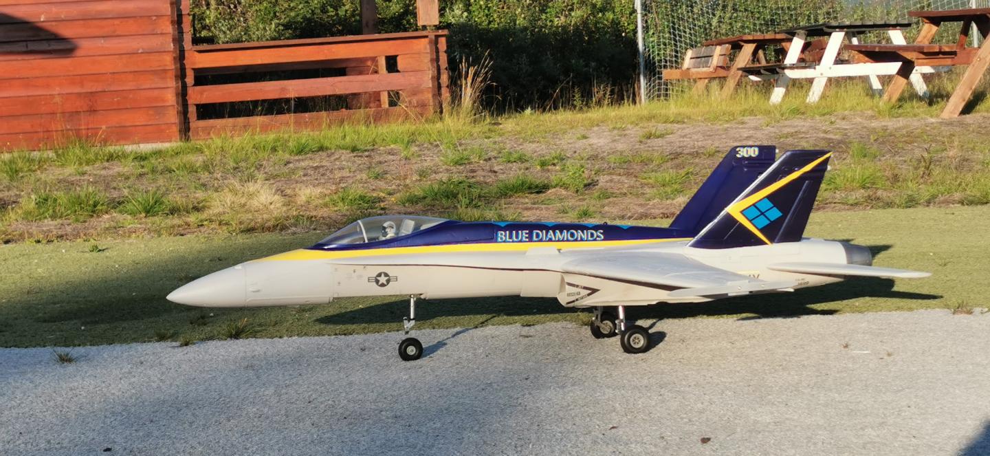

                                  • Did som repainting on my Fw Click image for larger version
                                    • Now that's what a "Blue Diamonds" should look like!
                                      Fly low, fly fast, turn left
                                      • Originally posted by rms View Post
                                        Did some repainting on my Fw F18
                                        RS, Nicely done, Sir. And what nuts-n-volts wrote is spot on. Super repaint. Best, LB
                                        • Smal movie of my Blue Diamonds..
