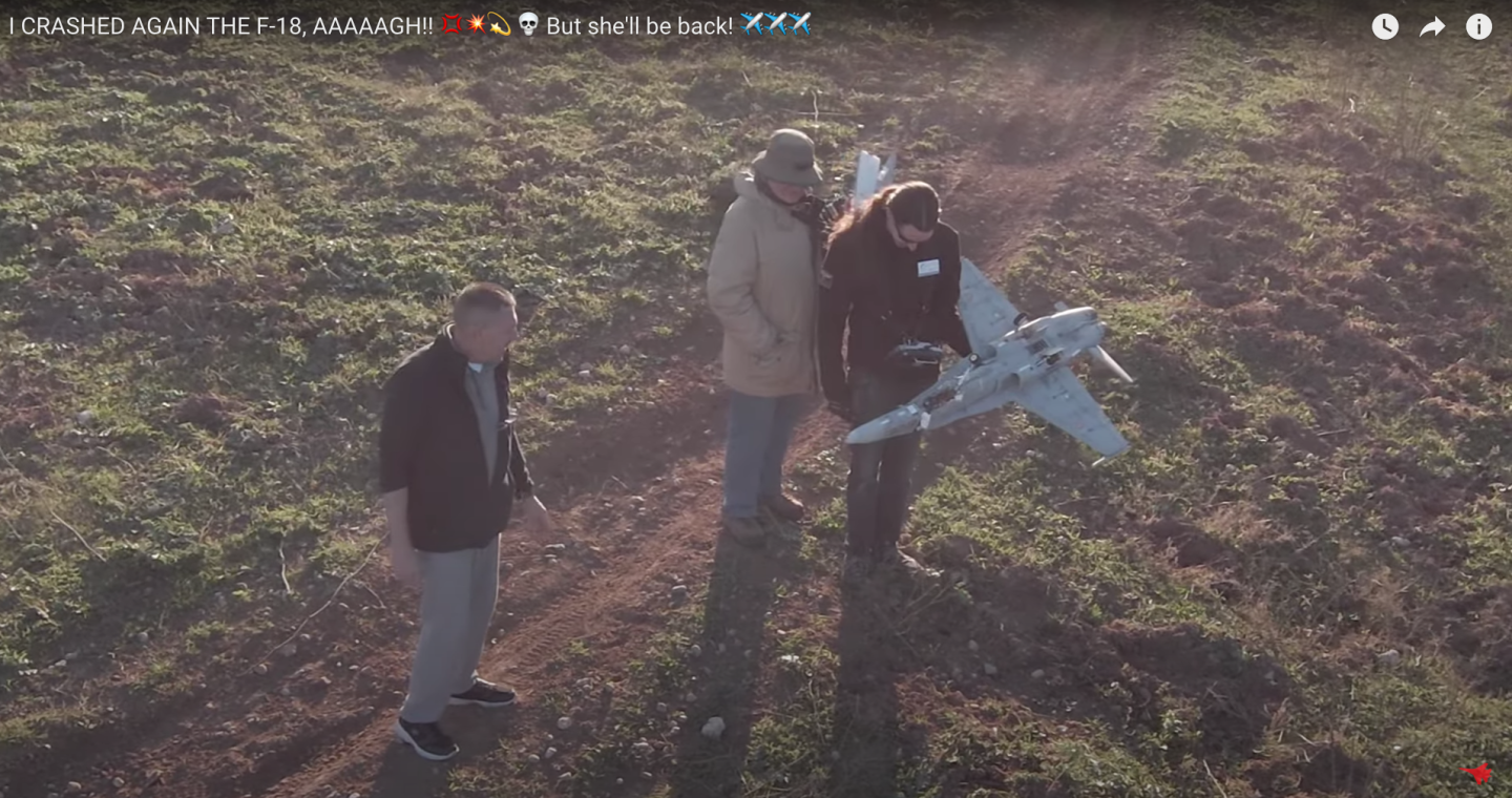

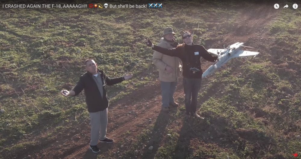

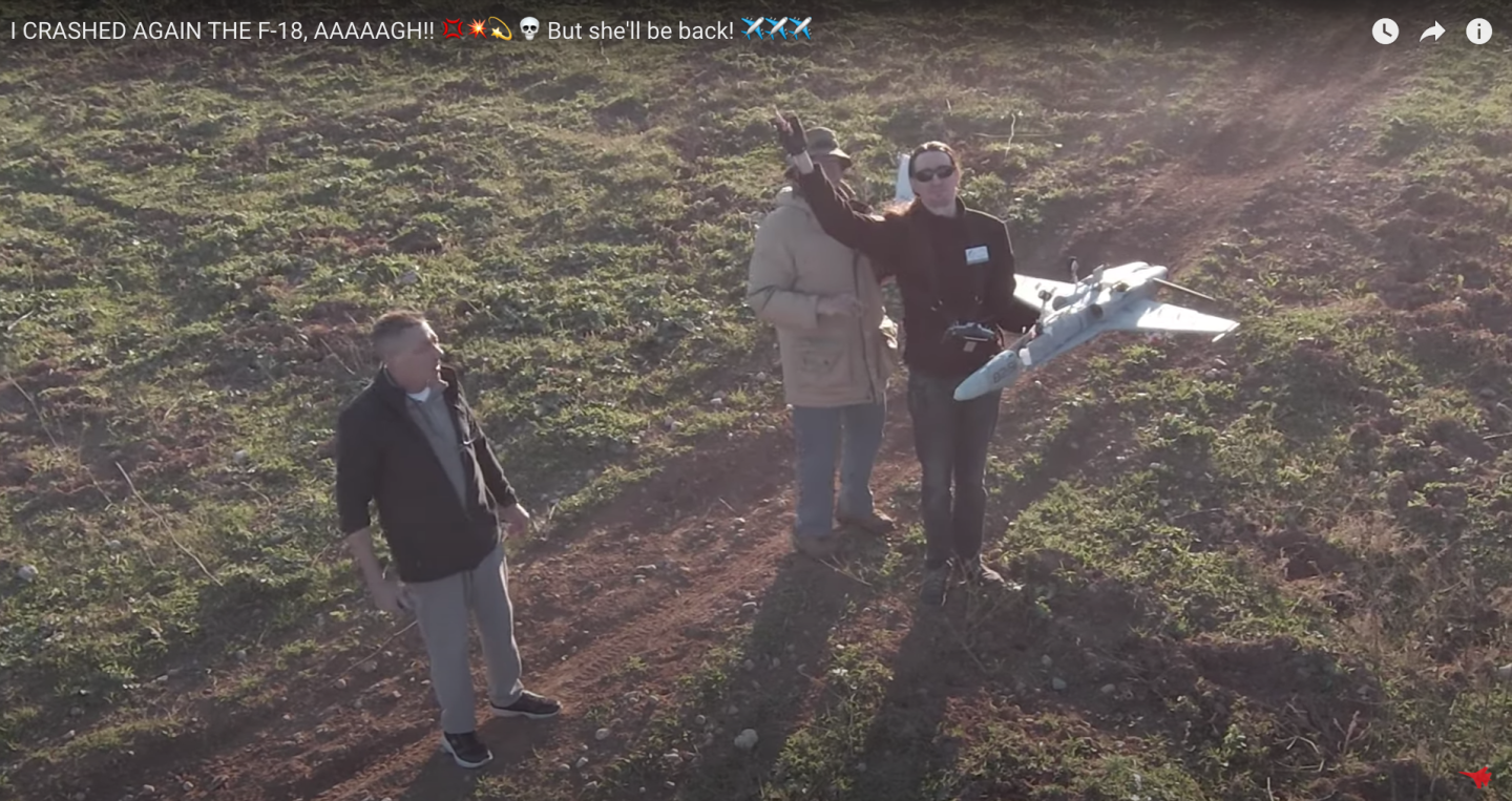

                  Oh, well... that happened again. :sob: ]
                  AG, just watched all the footage. My condolences, Sir. I presume you will rebuild her, I would. Best to you and yours, LB
                          Thanks Elbee, I plan on repairing her. It will give me some work though! ;)
                            :sob:

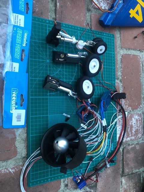

                            OHHHHhHH F**K!!!!!!!!!!!!!!!!!!!!!!!!!!!! NOOOOOOOOOOOOOOO...... ;((. Bloody Hell that sucks J looked like one of crashes! Damage looked same as my ocean dump on fusi exactly, easy fix for you brotha!

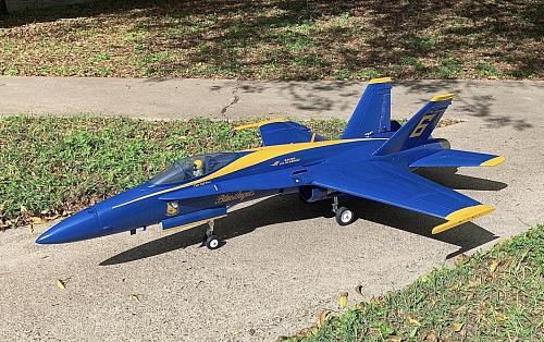

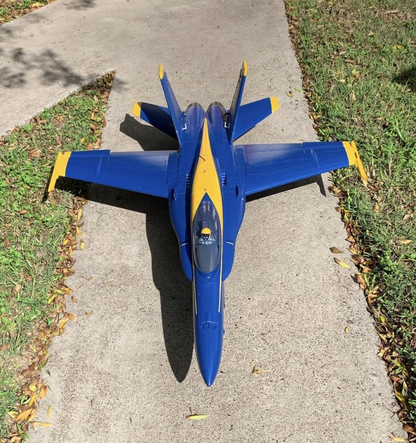

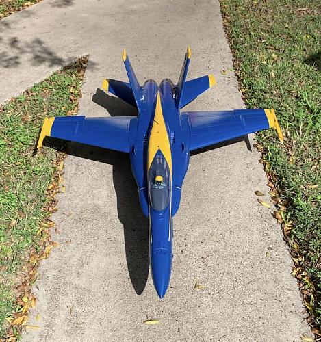

                                    #5617

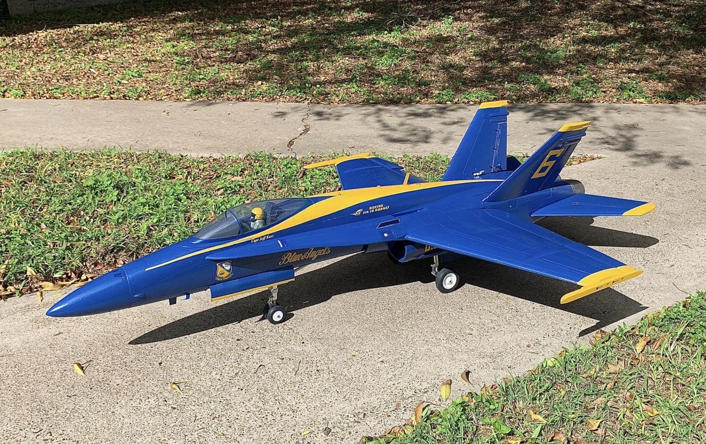

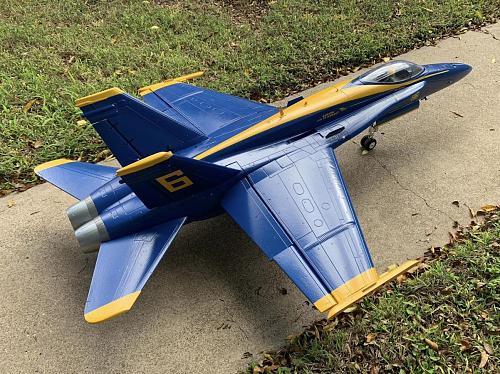

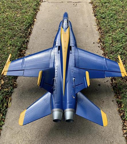

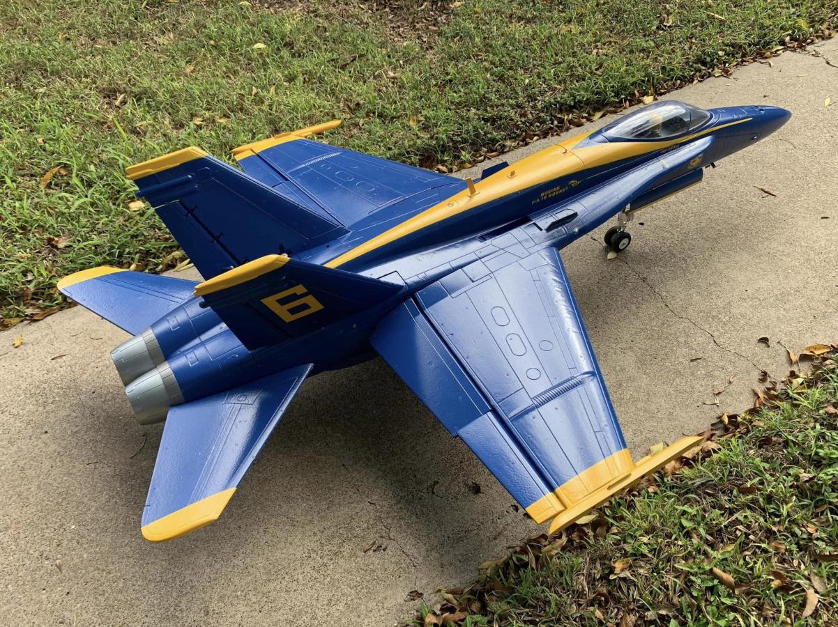

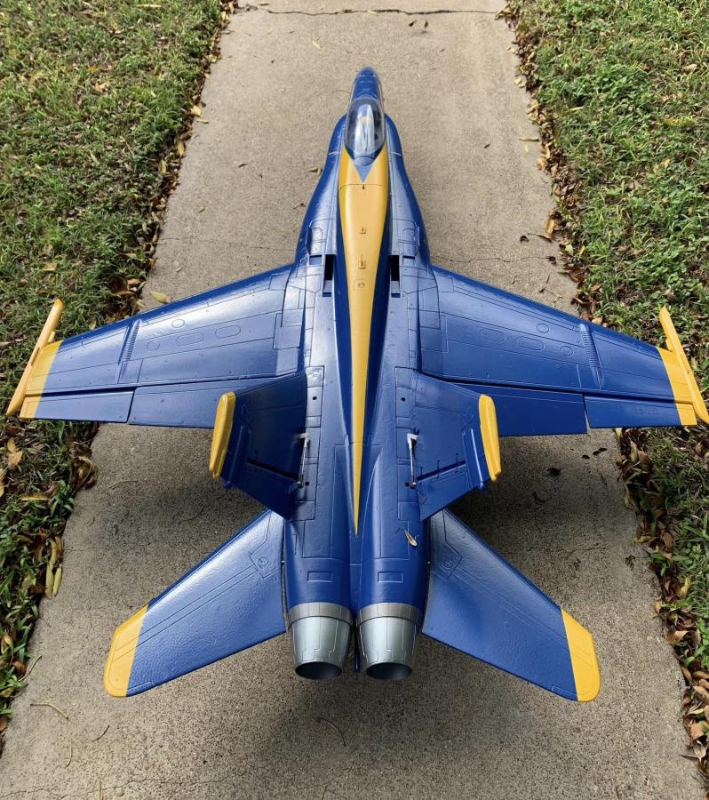

ID:	363603Click image for larger version
ID:	363604Click image for larger version
ID:	363605Click image for larger version
ID:	363606 I love the results after I applied the Minwax for that Blue Angels "shine".
                                      • 4852
                                      #5618
                                      JD, she is a beautiful thing. Nicely done. :trophy: How many coats did you apply for that "Blues Shine"? Best, LB
