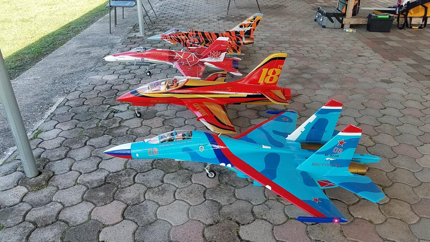

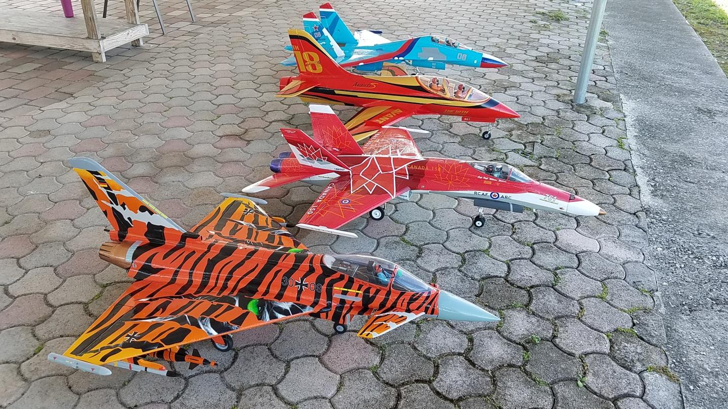

                        Aros, Todd, got out today with a few aircraft including the F18 getting 6 flights on it. Wanted to confirm the potential BS I posted above about the Spektrum gyro RX upgraded to plus being the ultimate game changer for the F18. Turns out after tweaking and zeroing in the RX gains it's all 100% true. And it's spectacular! You may not believe it, and I almost can't, but now the F18 is my absolute best flying/landing military jet, along with the TV installed Mig. The F18 flies better and lands easier than even the 90mm F16!
                        Took some harrowing flights to get there, but I've reached Nirvana. Performs like God intended it to when He designed it! All 6 flights, in 10mph winds changing directions, were absolutely perfect. Smooth takeoffs, rock solid with aggressive flying and the best butter landings I've seen. Can hardly believe I was even at the controls.
                        If I remember, you fly Futaba, so basically you're :poop: outta luck with the F18. I've only got about 60 flights on my 2 F18's, and each of those had their "oh no" moments. If I got home with little or just minor damage, I considered it a Super Bowl win. No longer. Turns out the F18, and only the F18, had weird issues with rudder gains. But when you get it right, Whooo Hooo! I'm using 40/45/12 normal flight gains now (R/P/Y). Others easily handled Yaw gains up to 50-60. On take offs, using 45/50/15 & landing gains 55/60/18.
                        Additionally, learned a technique from some "Pro" RC pilots relative to throttle on landing. First, after plugging in the battery, I trim the throttle up to about 60/70 so the fan never shuts down even at 0 throttle. Then, put a simple and seemingly innocuous mix in of when you drop throttle to 0, a 5-8 click of down elevator comes in. Results, with the plus upgrade, is virtually consistent absolute perfect butter landings.
                        So my F18's are going to be quite busy from now on. Maverick, move over!
