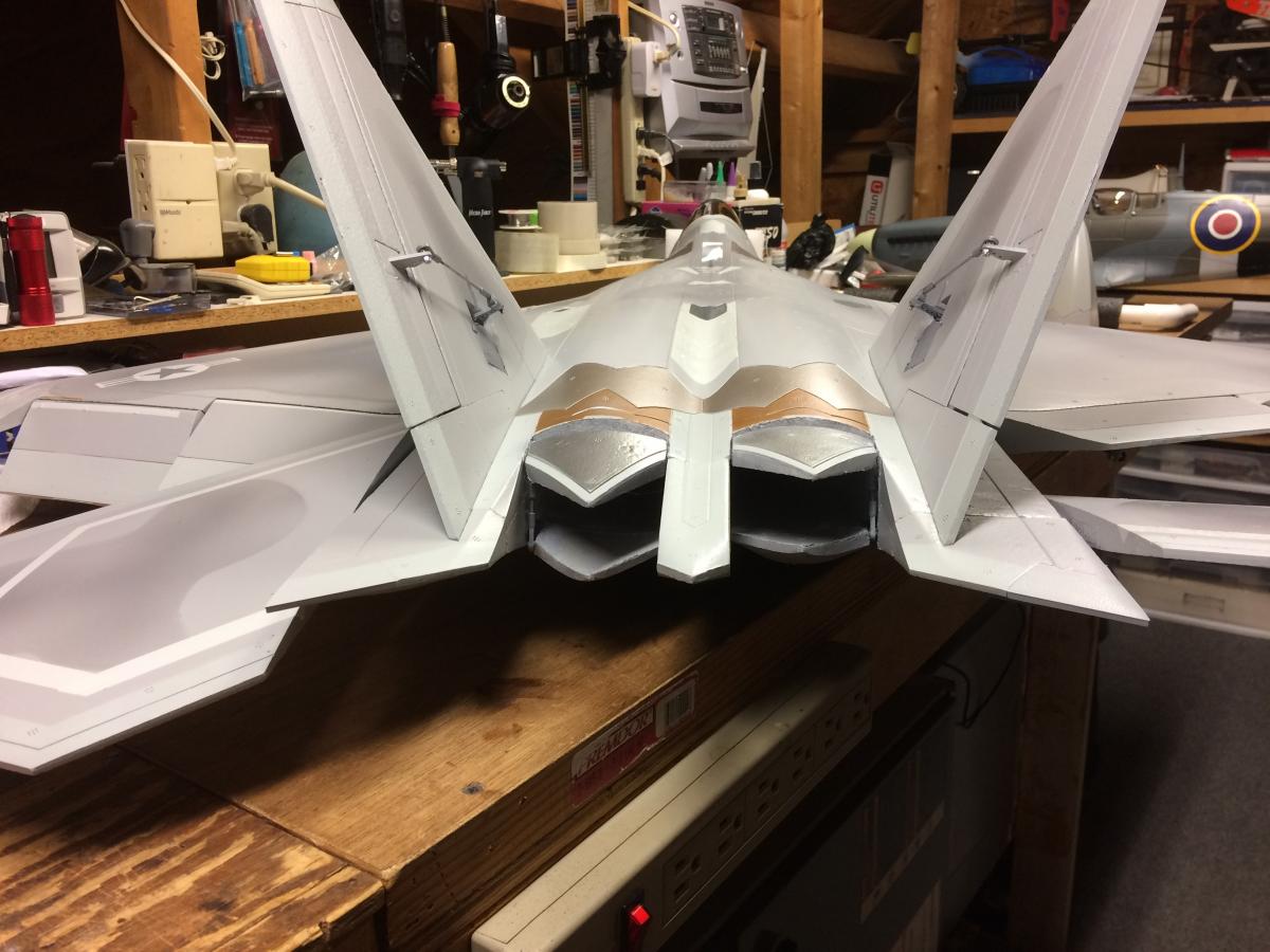

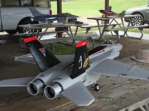

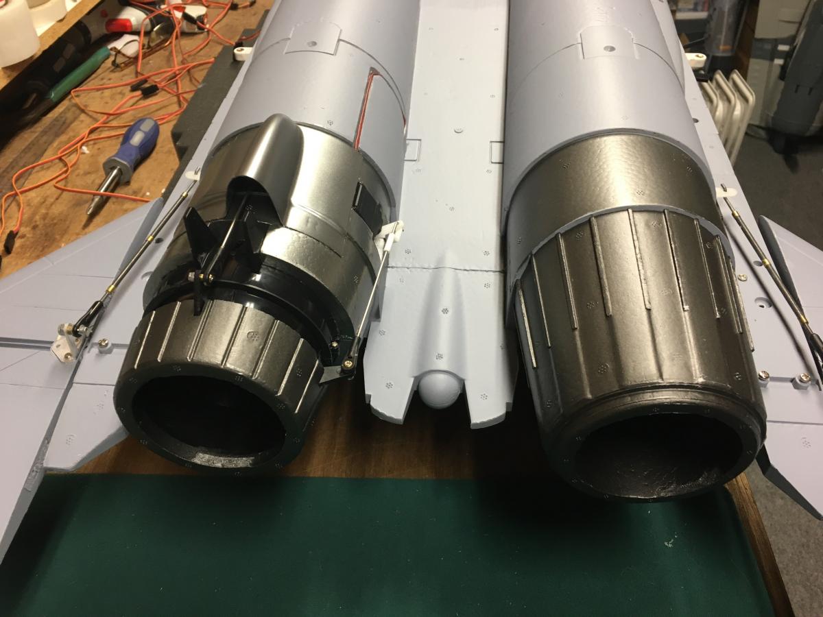

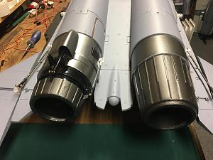

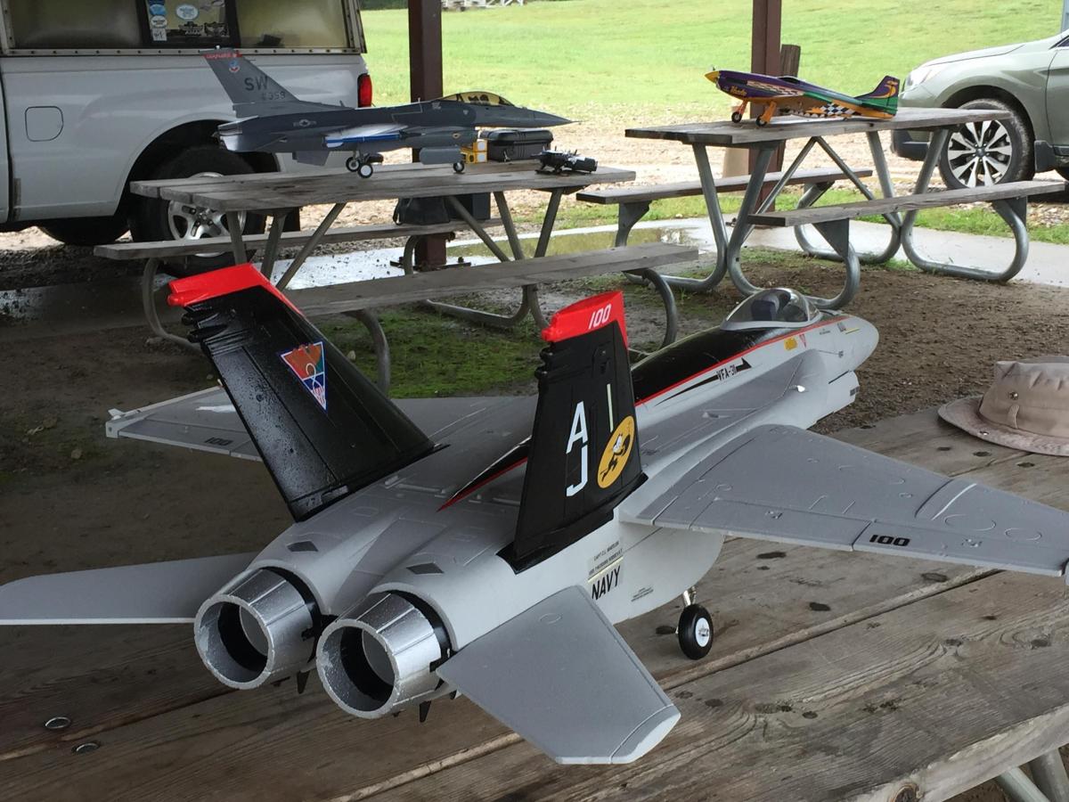

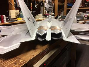

                • Many are very vocal anti TV... Even the F/A-18E that FreeWing used to have had a lot of people pinning the TVs down. When suggestions where made over the years many were vocal about not producing TV equipped aircraft.

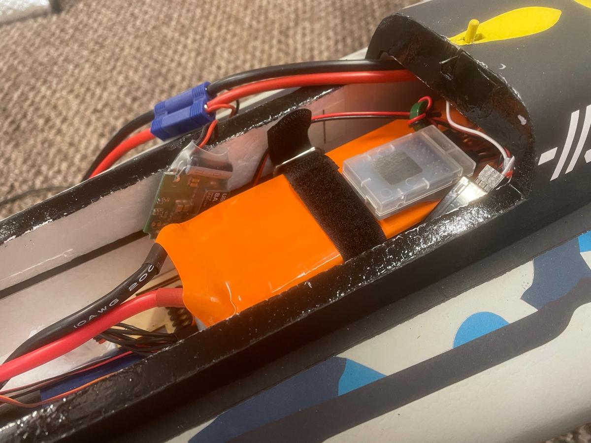

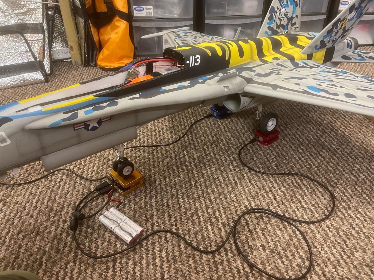

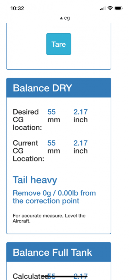

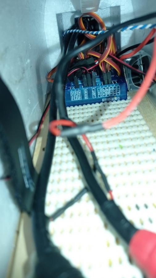

                                • Hello Hornets,
                                  Measured the CG today at 55mm from the mains on my Xicoy CG computer (that's 101mm from the wing root referenced to the manual).
                                  I had to relocate the Blue Box to under the battery tray to get that (as recommended so thanks for that).
                                  I'm curious, given all of the "lively" debate on the Mig-29 thread, has anybody needed to bypass the Blue Box on the F-18?

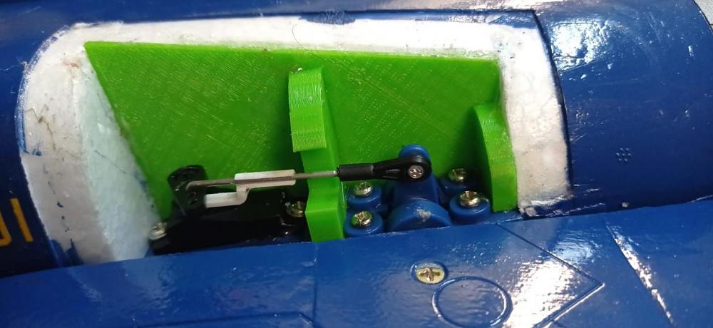

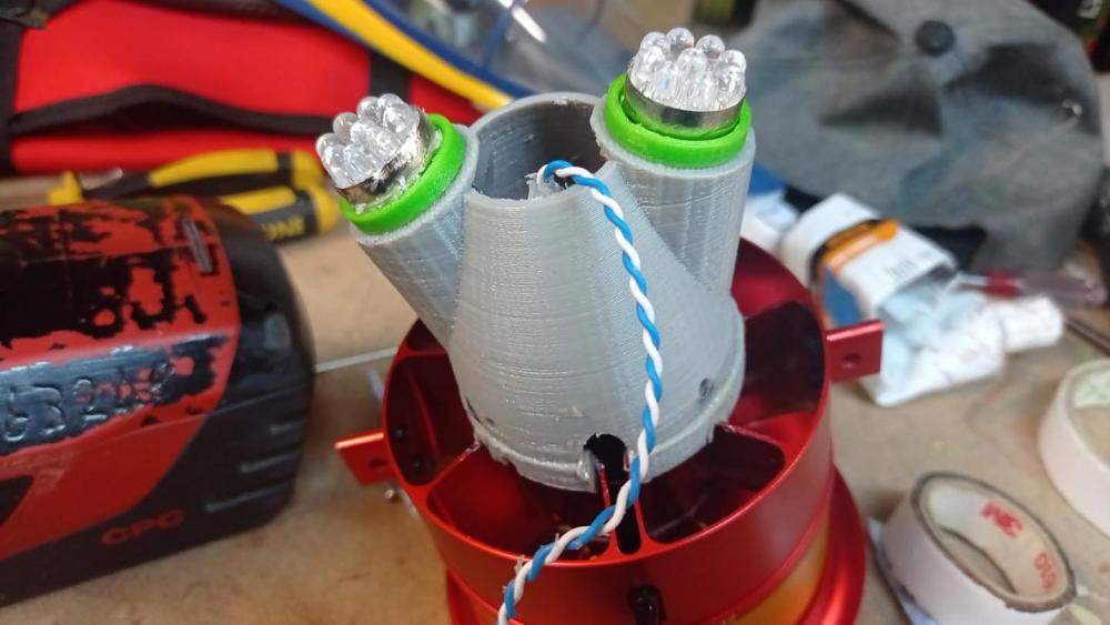

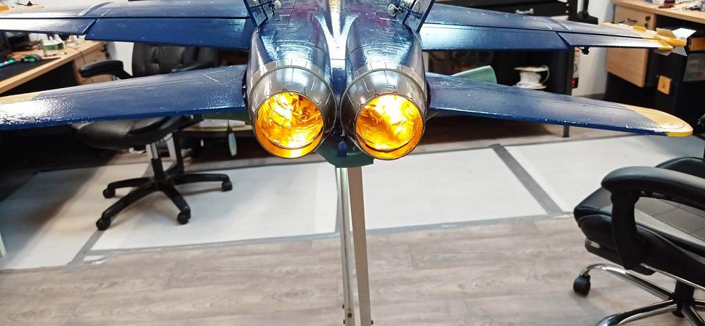

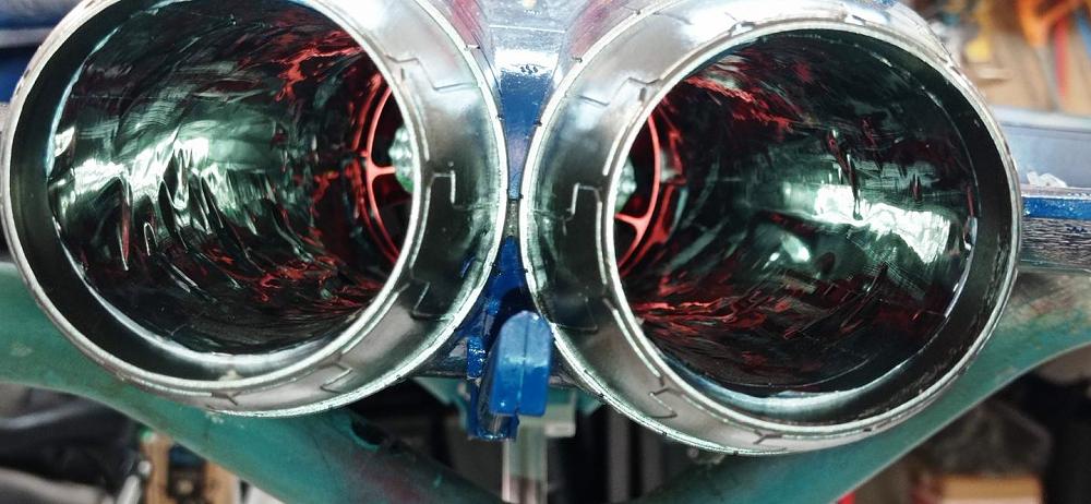

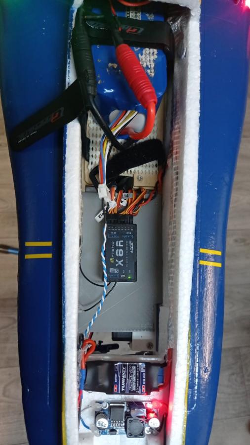

                                    I have also added a twin center burners on my Blue angel FA-18 Looks sweet! Also modded the canopy to put all wiring under the ply board and pushed all the way back so i can push my 8s 5000 mah Nanotec all the way back to get the correct cg.I Also installed a JP 90mm 1330kv 90mm full alloy edf 8s.

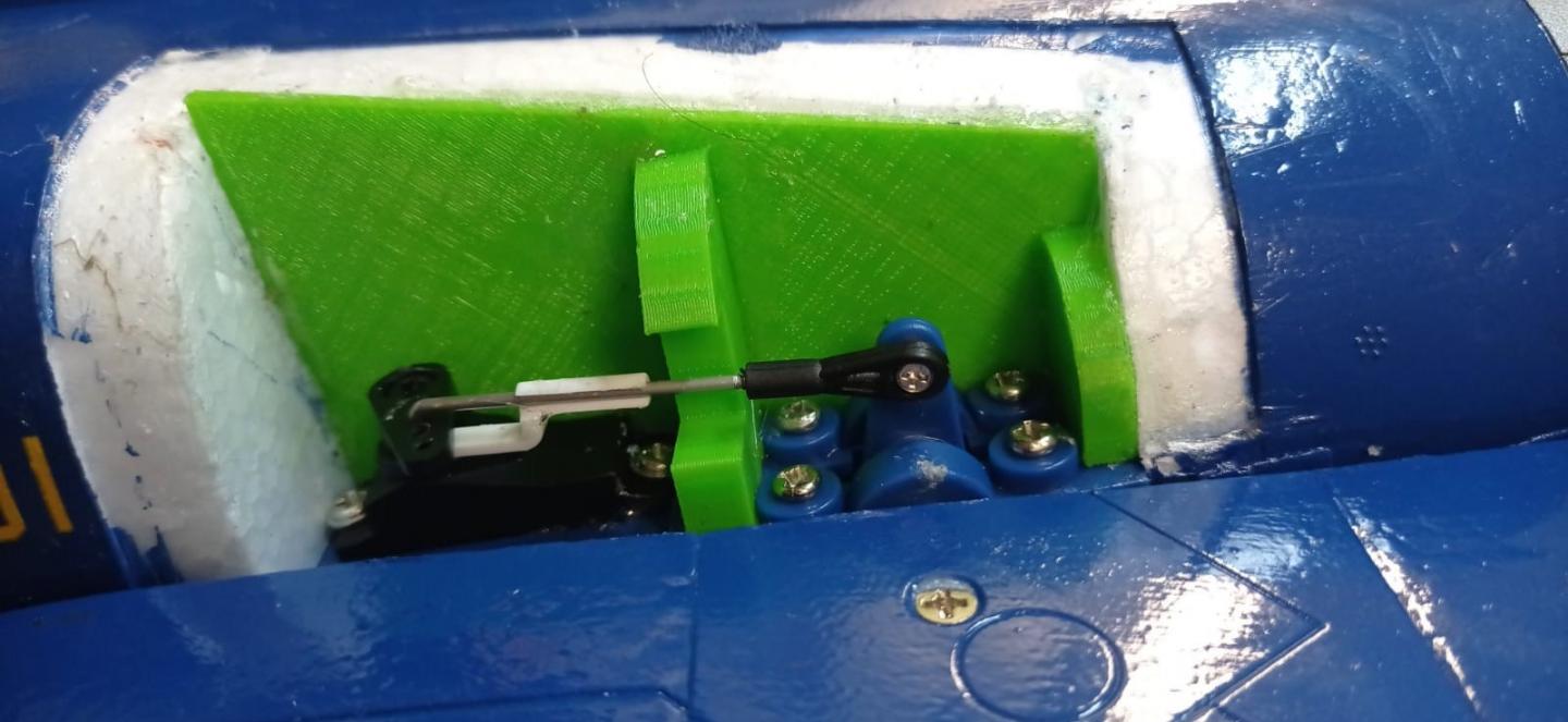

                                    Also with a 3D mod for the Elevator support Similar to RC Informers ply and metal one. Click image for larger version
Name:	F18 elev 3d mod.jpg
                                    I have not maiden her yet will do it soon

                                    • I bypassed the MCBe on mine except for lights, gear and flaps but did it to get the mixing I wanted.
                                        Needed or not, I bypass it for everything except gear, lights and wing-ribbon dependent stuff.

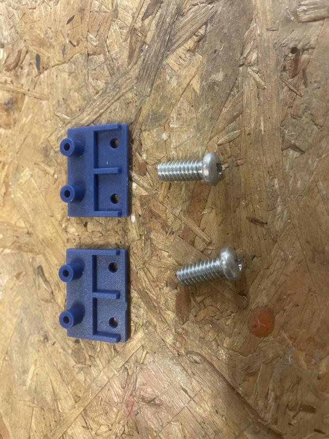

ID:	307045Thanks chaps, anybody know what the funk these are for:
