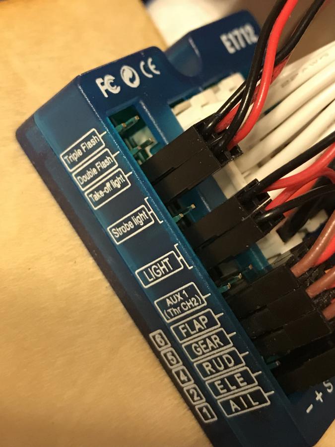

                                  #4916
                                  Finally got everything working except the beacon and the landing light? Both are plugged in to the blue box so not sure what the issue is.

                                      #4918
                                      You've tried connecting the beacon and landing lights to known working male connectors, e.g. navigation lights, and confirmed they are working?
                                      Have you connected the navigation lights to the LED connectors in question and confirmed it's a blue box issue?
                                      You haven't plugged them in reversed-polarity (black to ground, red to positive)?
                                      Can you post a clear picture of the LED ports with LEDs connected?
                                        I checked connectors in nav light slots and they both work fine. Lights themselves are fine there is another issue. Here is the pic
