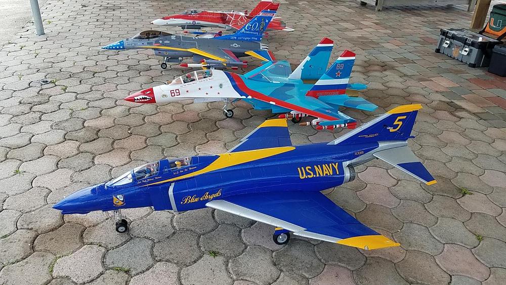

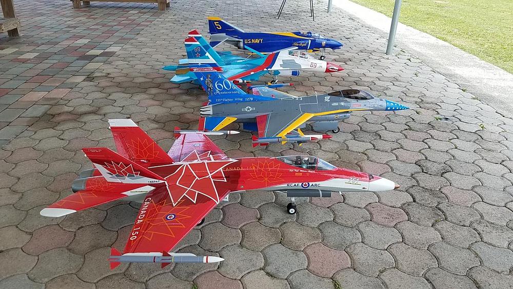

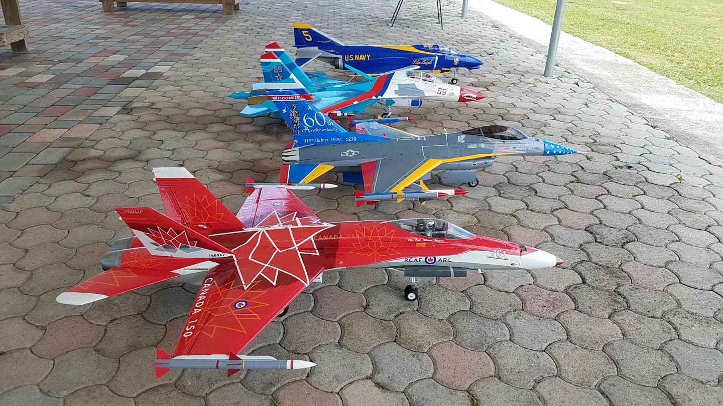

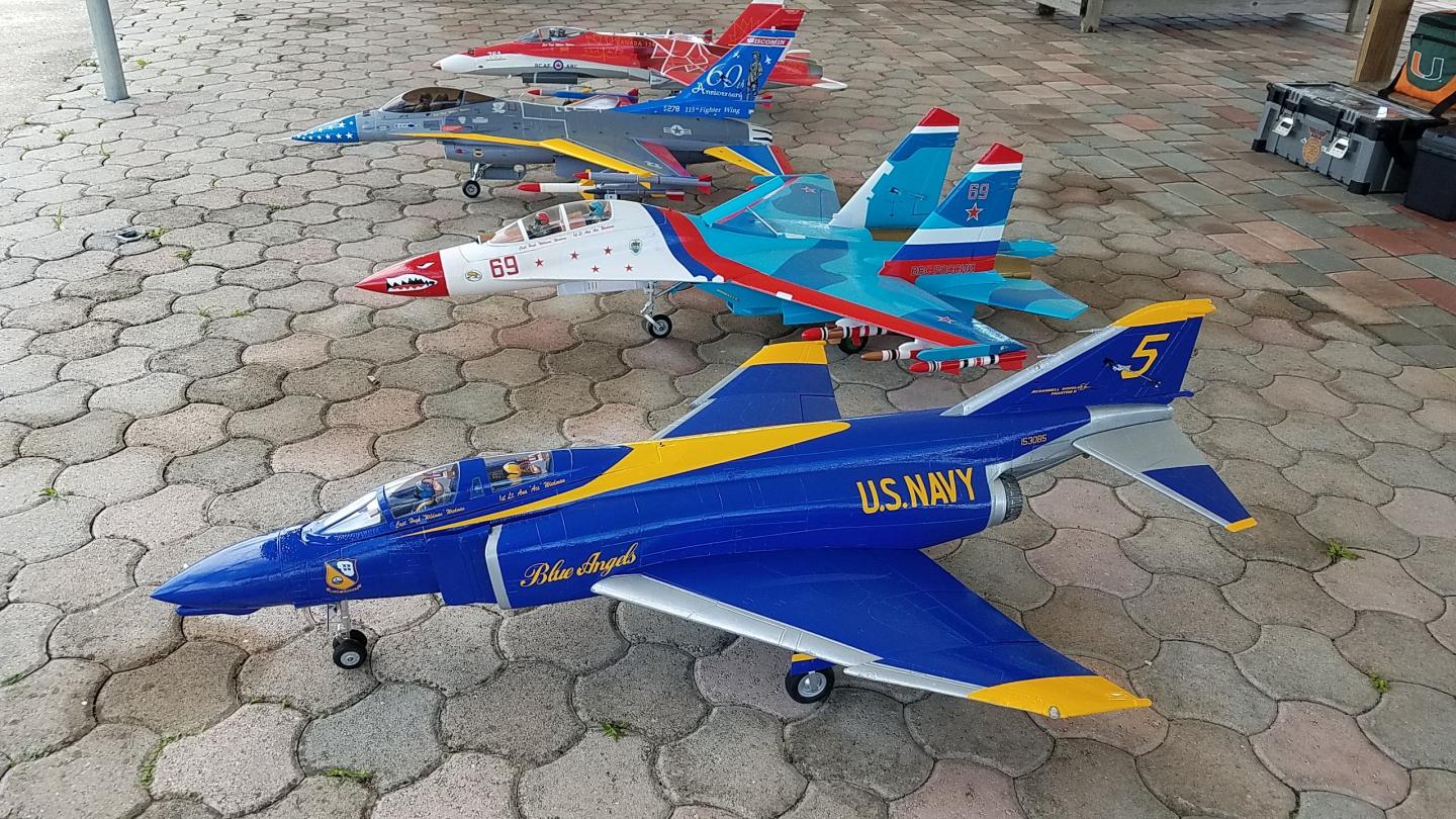

                          Was able to get these four out, The F18 Canadian, F-4 Blue Angel, F-16 (All three with the 12 blade inrunner, oh yah baby, gotta have it!!!) and the SU-30 with it's new FMS fans. As I said above, I'm starting to settle in at a CG of around 108 mm, anything more aft is a bit much for my limited ability, even with a gyro in it. Could be that a stiff 12-16 mph crosswind was giving me a few fits, but only with full flaps on landing, so I'll try it another day when winds are lighter and see how a more aft CG works. I still have a 2nd hornet in the box just received (trying to beat the May 15th price increase) ready to do another different repaint also using the 12 blade inrunner and although I have everything waiting, including paint and Callie's graphics, haven't gotten motivated to start on it yet. And sitting right next to it is the Mig in a box (also just received and hoping to avoid that price increase and got lucky as I got it before it went out of stock AGAIN!!!), along with it's TV nozzles, all the upgraded components and Callie's custom graphics. So today was either work on those two, or go out to fly! Looks like it may be awhile before these next two get done, or even started!

                          Hate to say it, as much as I love the F-18, especially considering I now have 2, but for some reason I much prefer the F-4 in the Blue Angel livery than the F-18 in the BA livery. Maybe I need to get one anyway, just to make sure!
                          Click image for larger version  Name:	20210513_122827.jpg Views:	0 Size:	290.8 KB ID:	312629
