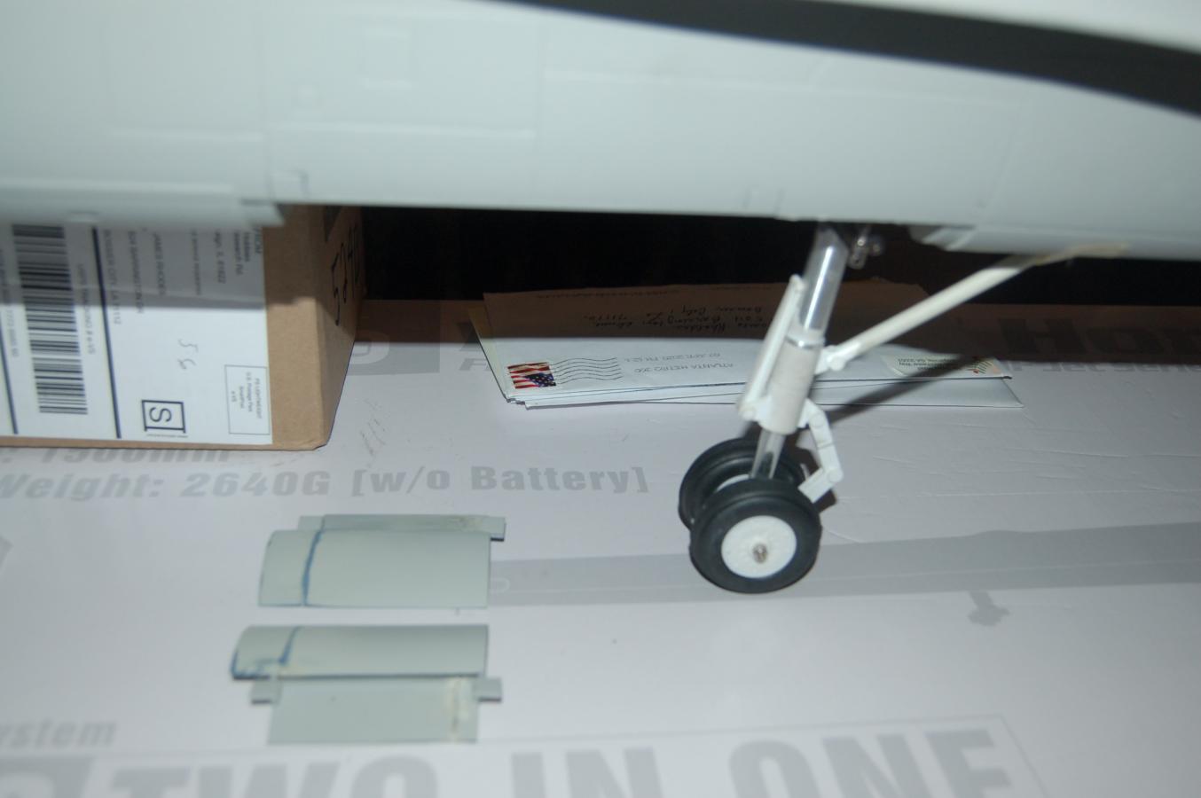

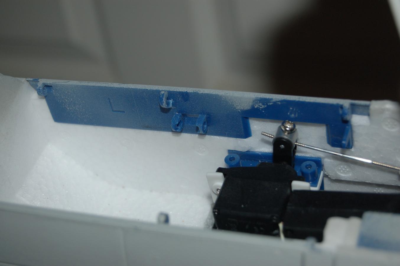

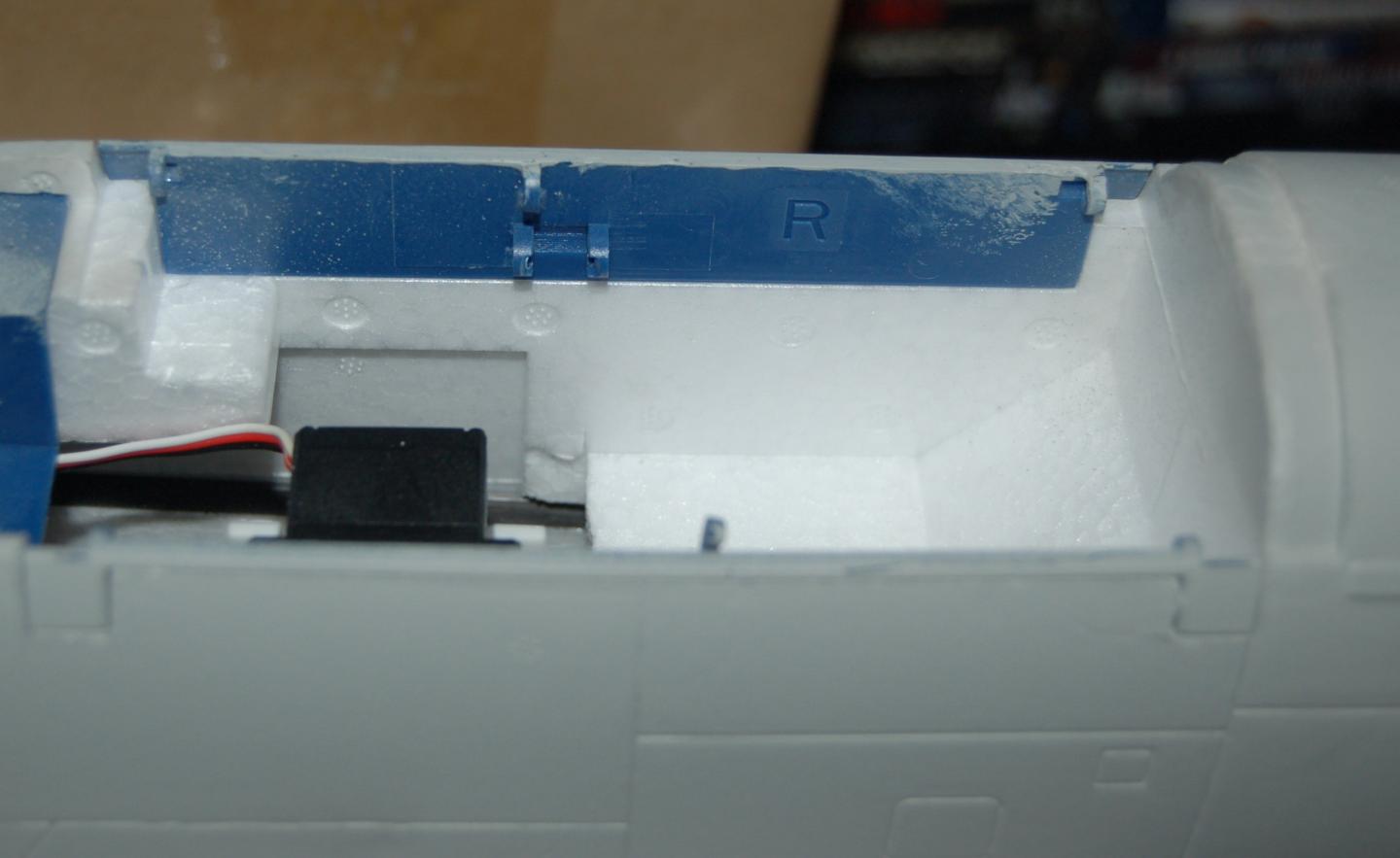

                        LB now that I have the cockpit done I'm working on the gear doors as you can see in the first pic. The second two pictures of the left and right support need to come out. How do you do that without cutting the foam and support then removing the foam from the piece then gluing the foam back on the jet? Also, the last pic show parts you made that I need to complete my mod. The wheel well doors I've made. Where does the piece for the ball link come from? I don't see anything in the scrap I have leftover from the material I can use to put the ball links on to attach the wheel well doors to the Futaba 3008M servos I just got in the mail. The pieces for the bulkheads, strut area and door and the brace door I need and would like to have them if they are available in a 3D file to be printed.. If you can provide that stuff for me I can move on to the other neat files shown as mods to the bottom front of the aircraft..

                          Dustman, Looks good so far and also it looks like you're about to begin the plastic/foam surgery; not for the faint of heart. Did you purchase the Freewing Nose Gear Plastic Parts Set from MotionRC? https://www.motionrc.com/products/fr...rs-blue-angels Those parts can be used to mod all the other Gear Door Parts. The painted 3DP parts in the picture are 'eye candy' with the exception of maybe the bulkhead which adds some rigidity to the fuse sidewalls once things are reglued into place. The ball link connects to a shortened plastic Control Horn glued to the NG Doors. I am currently at 12K feet enjoying some R&R with the Fam-Damily. Back home first part of the next week. I will check back with you and your progress then. I want to help if I am able. I'm at that filling, sanding, and priming stage and have not rebuilt that section entirely. Best, LB

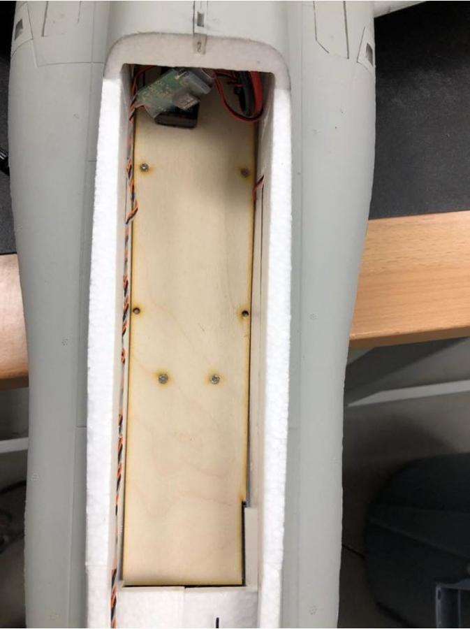

                            New battery tray coming to reinforce nose gear.
                            **this is prototype***
