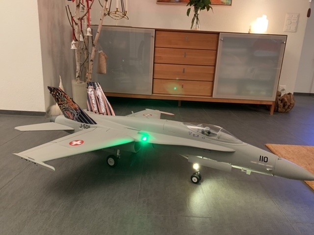

  • As soon as my flyingfield opens again this beautiful bird will have a maiden flight😁 (It is the livery of the lead plane of the fightersquadron 11 of the swiss airforce)
    • Swissalpsflyer hello and welcome to HobbySquawk, also waiting for openeing of the flyingfields again here. Unfortunatly your pictures are not uploaded!?

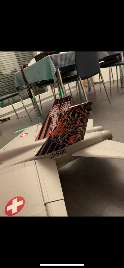

                • FINALLY saw one of these in person today! She's quite speedy and overall I was very impressed! My clubmate M. Troy went with a custom scheme on his.
                  • Jets and Wings Thank you hopefully this time it uploads the picture😅Click image for larger version

                              • Originally posted by Swissalpsflyer View Post
                                Looking good, like the Tigers on the rudders. Have fun flying her...

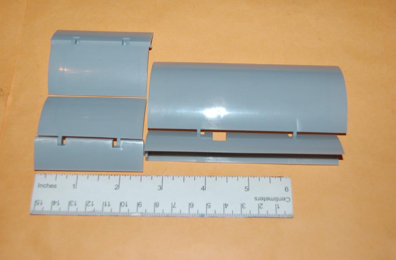

                                • I found these on the web. They are the doors to the E-Flite F-18. The small doors are 2 1/2" and the main door is 4 1/2" long. You think these will work.? I'm still waiting for your mod though LB. I'm anal and a visual person and looking forward to the pic's you provide on your door mod.
                                  • Originally posted by Dustman View Post
                                    DM, I am still waiting as well. My snag is the closure. In my world, trial and error is king, so right now it's been more error than success, though I am close. As for the E-Flite parts, don't know about fit. The opening of the Freewing is >8" long seam to seam if you include the molded in seat for the doors. In terms of the just the opening itself, 7" might work. Using the OEM Freewing parts is the simple part thus far, just some cutting and gluing. Actuating the 2 forward wheel doors has been my hangup as I would like to do that without using servos and there's not much extra space being this is a foamy and the wall thicknesses are great. In hindsight servos might have been easier and is still an option. Rest assured I will post something when there is something to post. Best, LB

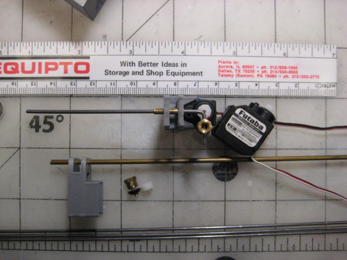

                                    • Hey Gang, No new news with the exception I abandoned the 'no servo' idea for the "NG' actuation. Could not find a solution that was accurate enough or consistant enough to suit. So with that in mind, I've been watching submarine vids by Bob Martin of Nautilus Drydocks because RCjetdude mentioned him in his forum of his 3DP build of the French Resolute (sp) submarine. Bob Martin reinvented a way to convert the 'rotational movement' of a standard servo to a 'linear movement' that keeps seals from distorting for his subs. I needed 'linear movement' so I've been fiddling with a design for the Futaba 3108 micro servo and finally after many failures, I got it right. All that written, I can actuate the NG doors though at the cost of one servo for each door. Hey, I tried not to use servos and this one escaped me. The design is specific to this servo pretty much. I will post the STL if you guys want but my guess is everyone will find a differing way to do this. I am getting 5/16" travel with zero servo buzz. Amazing to me. So big thanks to Bob Martin and to whomever he knows that designed this originally and of course to RCJD for building his sub and posting such great intel. More when appropriate. Best, LB

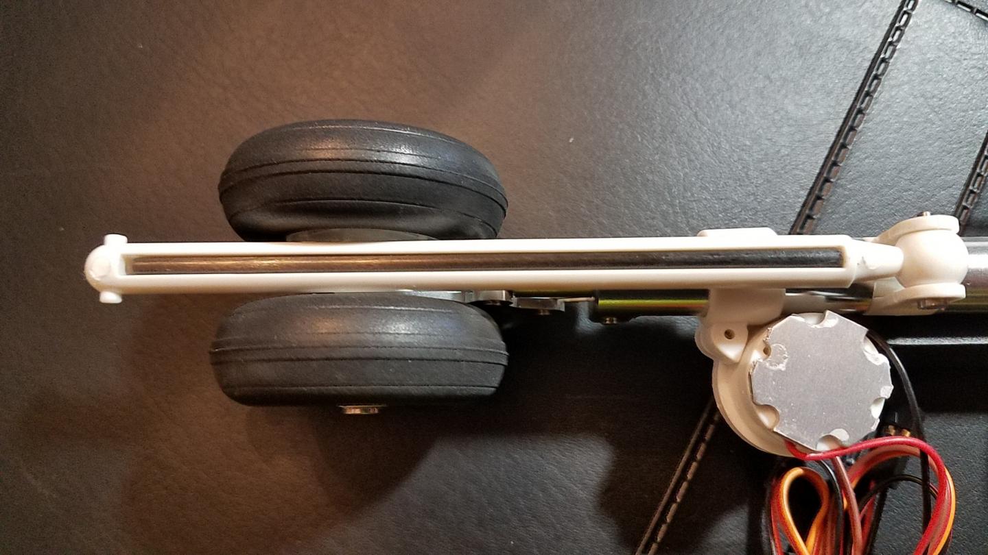

                                        Wish Alpha would consult with you before they finish designing a model! Truly ingenious!
                                          Elbee commented
                                          Editing a comment
                                          Can't take any credit for the design, only for the mod to fit the Futabla 3801. The concept can be adapted to any servo and built with other materials. I only wish I'd run across this when I was adding the "Tail Hook" Mod to my Phantom.
