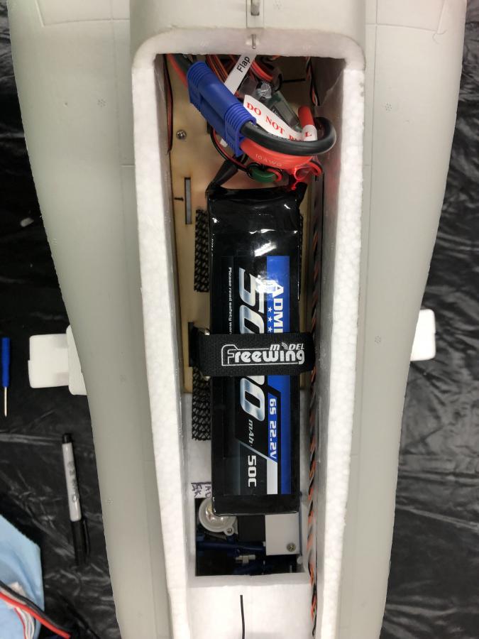

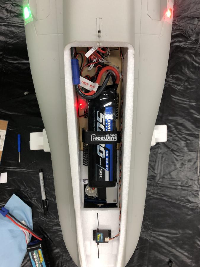

                                • Regarding cg it’s amazing I’ve seen guys use 70-100mm.
                                  Pilot Ryan and my good friend push admirals 5000 almost to the bulk head.
                                  Mine pictured below.
