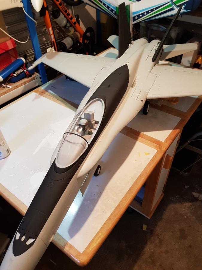

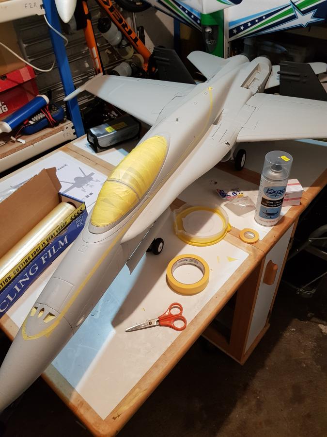

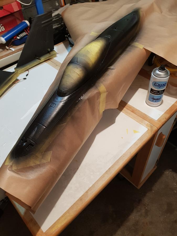

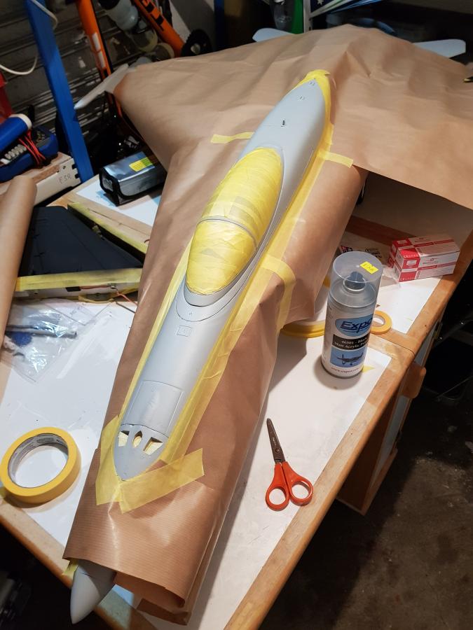

                  Good progress made tonight. Not bad for my first ever paint job. Painting is the easy part. It's all the prep before hand. Also really quite pleased with my free hand ability. Just freestyled the lines and curves and just went with what looks right. Of course I wont know how good the result is until I carefully peel off the masking tomorrow night. Really enjoying it though 😁

                    CB, Looks great thus far. What was your prep before the 'black' coat? More to the point, what did you do to limit the possibility of future 'gator-skin'? Best, LB

                      I generally carefully peel the Masking Paper while the paint is still Wet !! This allows the paint to Flow from the mask and lay a much better line. If you are waiting til tomorrow for something ...?? I'm not sure what exactly that could be. If anything, there may be some difficulty with Lifting of your Base or newly applied Graphics if it sits on there too long !! Just a cautionary note from a fellow AeroModler !!
                        #2871
                        Yep. Get the masking off ASAP.

                          Oh ok cheers guys. I'll get the masking off as soon as I can. Dont know if I'll have time before going to work though.
                          in terms of prep before the black went on. Err. Well i wiped the surface with an alcohol wipe. That's it. I do plan once all my decals are on to put a clear coat over the top as well.

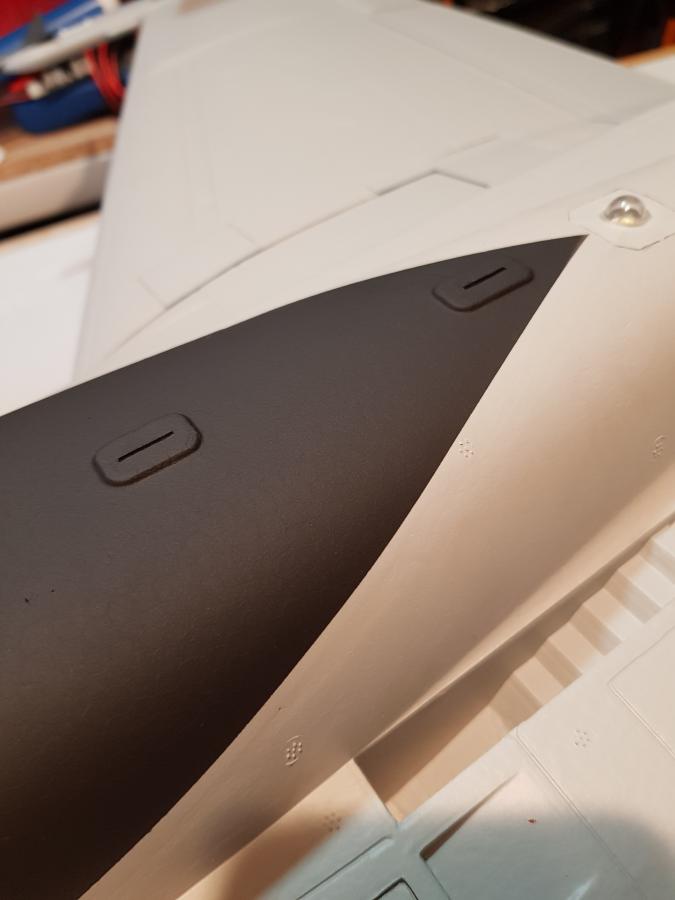

                            Just thinking what if I apply another coat of paint tonight and then peel the mask off while it's still wet. Would that work?
                            • thisguy65
                              • 509
                              #2874
                              masking tape pulls up the OEM paint. Use frog green tape and put it on your shirt or pants leg 3-5 times to dull the tackiness down.

                                It is frog tape that I used

                                  I'm gonna go give it another coat now before I have to leave for work and peel the mask straight off while that coat is still wet and hope that works

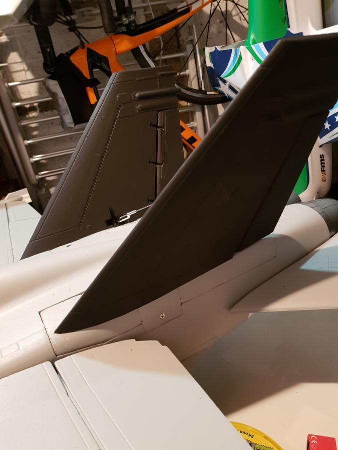

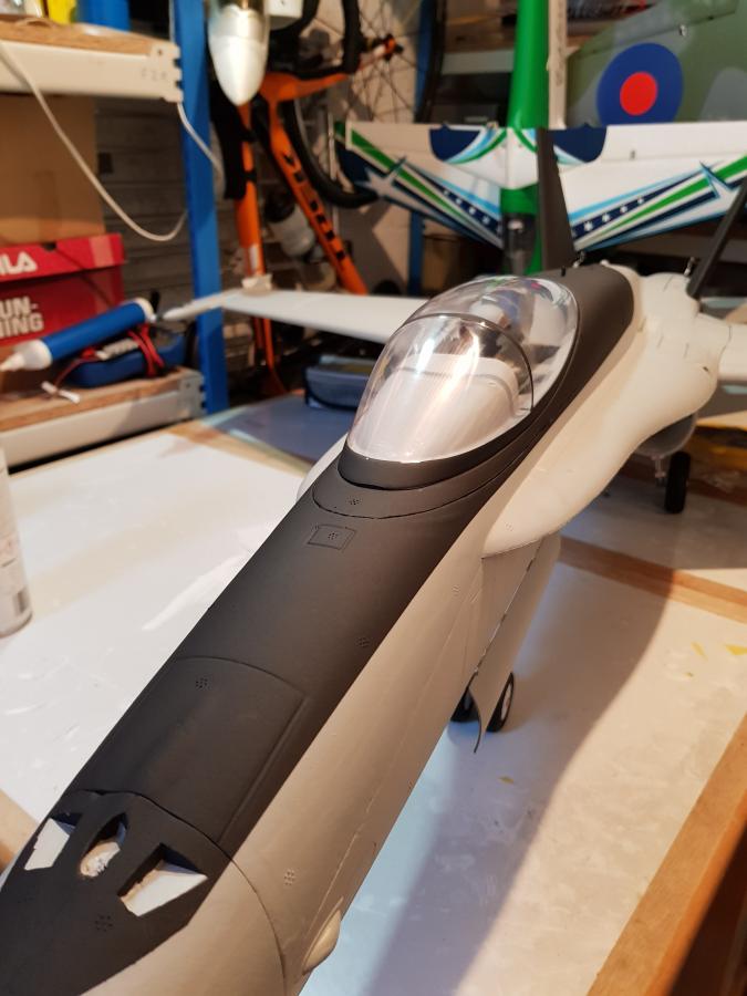

                                    Score 1 for beginners luck lol.

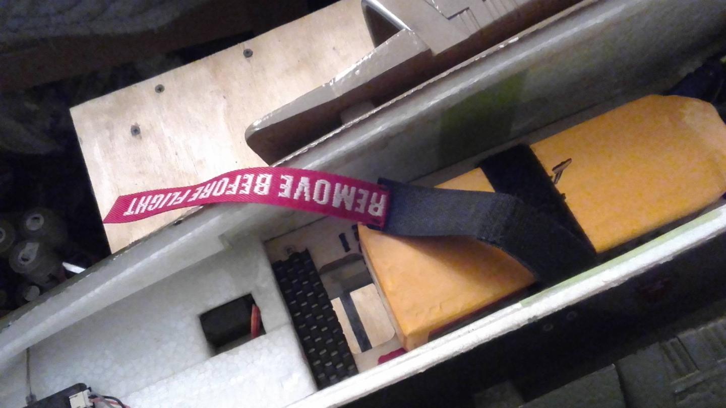

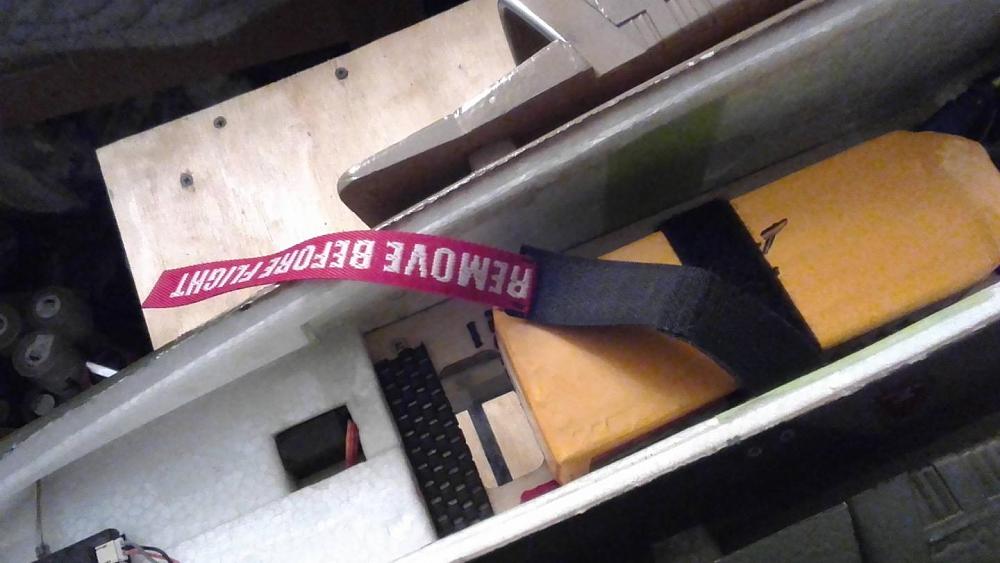

                                      Anyone else noticed that the velcro strap for the battery is very short. Can only just get it round my 4500 but it wont go round my 5000. Havent tried round the admiral 6000 yet. Gonna have to put a longer one in.

                                        CB, Now that's a clean line. Very nice. Best, LB

                                          They often are too short for my liking !! I sew on a Pull Strap whenever I need to extend one of mine. Cheers Click image for larger version
