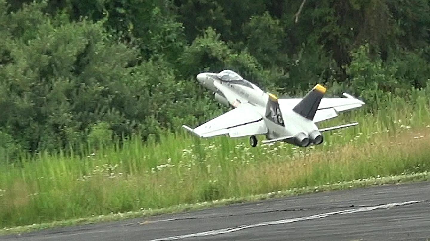

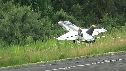

            Just learn to land the plane slowly. Any slower here I’d be going backwards.
            Click image for larger version  Name:	F5458D9D-61EC-47A8-92B0-4E9BF23B1E0D.jpeg Views:	0 Size:	153.1 KB ID:	210798
            • fredmdbud
              • 451
              #2826
              Ooooh, that looks like a tailstrike in the making ...

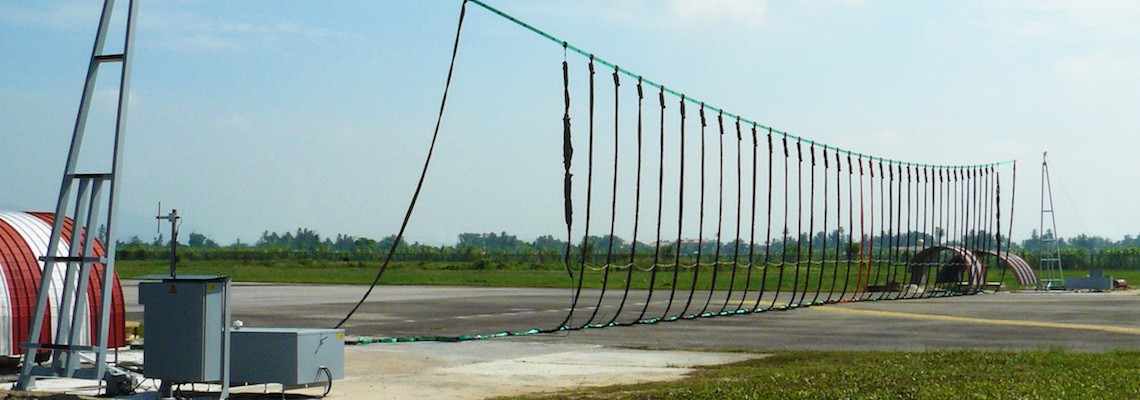

                #2827
                Originally posted by sisaksen
                How about making a functional arresting hook and wire? I would consider making a system if i fly off a paved runway. 😁
                This is more immediately workable …
                Click image for larger version  Name:	Net-Barrier-1140x400.jpg Views:	0 Size:	113.6 KB ID:	210803

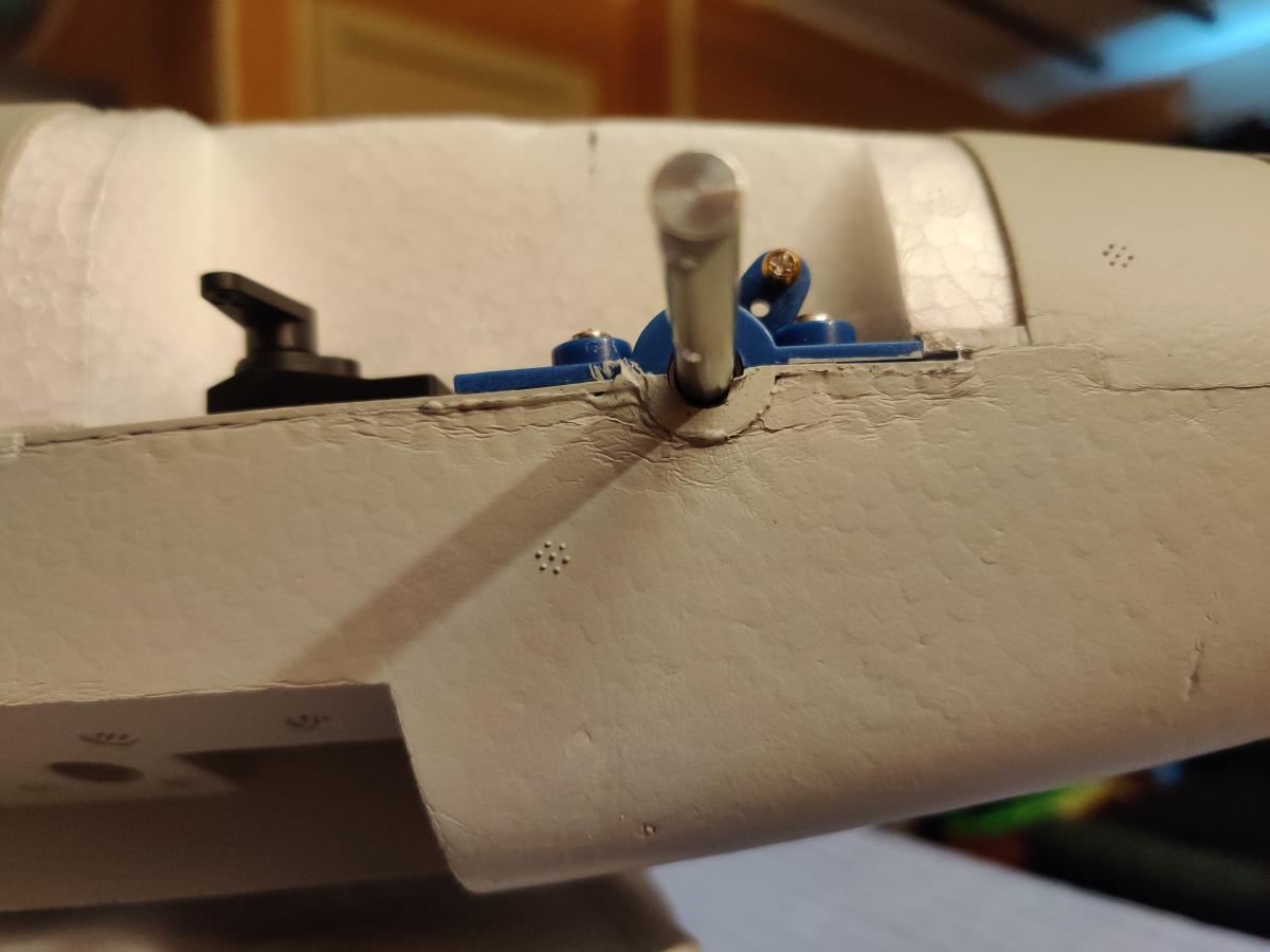

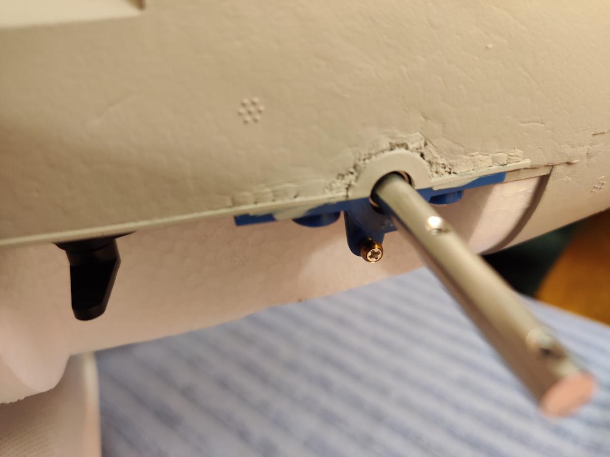

                    Well, finally got my Grey ARF+ (EU). Late to the party, but that obviously has its bonuses in this case.
                    A few observations:
                    1. Poor taileron design
                    As most know by now, the tailerons, or more precisely the mounts, leave a lot to be desired. Receiving a fairly late batch makes for some interesting observations. By now, this problem has been well known by all parties, not least FW, and my model shows fairly clear evidence of attempts to remedy matters. For better and worse. My mounts are glued in very, very well, but at the expense of 10-15 mm of foam above the plastic being compressed and squezed in the process to the point where it is soft and springy. See attached pictures.
                    Overall, a case of poor design in the first place, and attempts at mitigating issues just causing new ones. I will not return it over this though, I would more than likely get one or the other problem on a new shipment anyway. Will solve by removing the creased/soft foam and replace with a wooden insert instead. Should provide better load distribution from the tailerons anyway, and I more than likely will need some weight back there for CG anyway.
                    Almost tempted to give up a tiny bit of thrust to run a carbon tube across the fuselage to give the tailerons proper rigidity.
