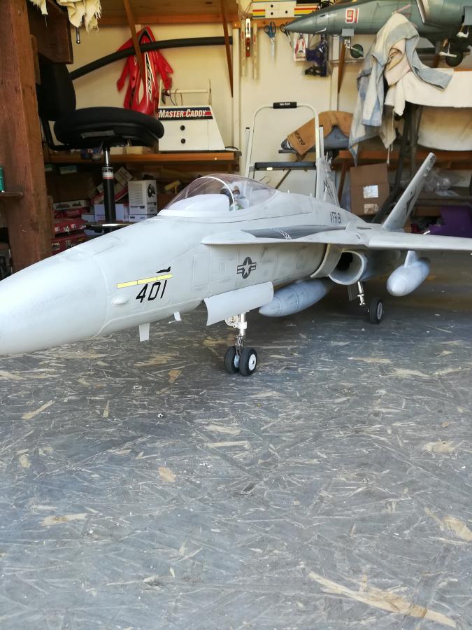

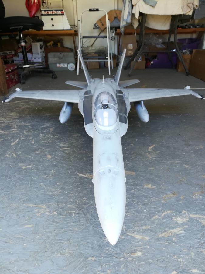

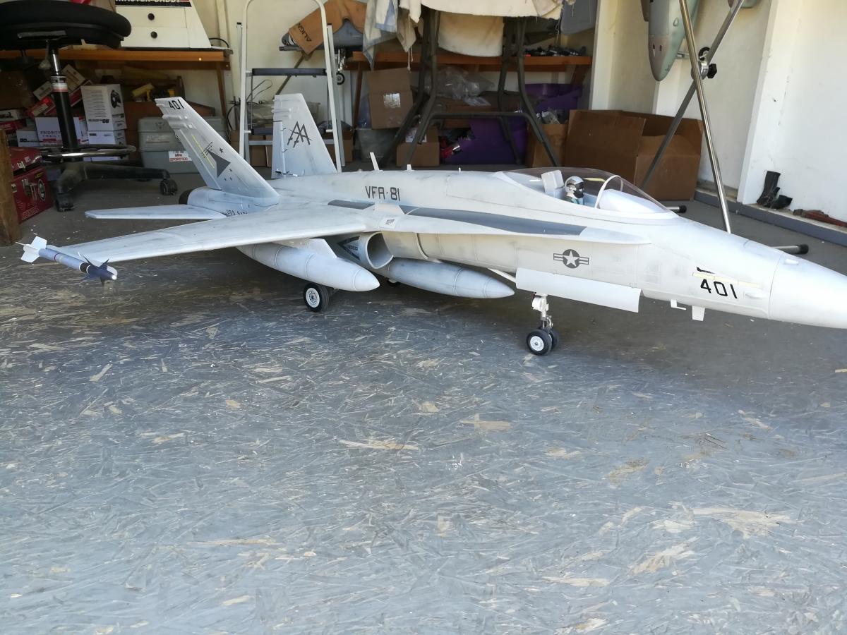

      Going to give it another try with drop tanks, finished them up today, not perfect but they look okay for me anyway, I'm not picky, going to try the centerline tank first then on to the wing tanks, see what happens, then maybe all three at the same time.......
        • 4820
        #2683
        Originally posted by DCORSAIR
        drop tanks, finished them up today, they look okay for me.
        DC. Ya done real good. She's a beauty. Best, LB
        • DCORSAIR
          • 1918
          • Selma, Ca.
          #2684
          Thank you, but it's nothing like your work though, I enjoy watching your talent at work, that F-4 you built was outstanding and I still gaze upon it every now and then, what a beauty. Have to admit though, I bought the Blue Angel version first and then the grey one, the BA is cool don't get me wrong but nothing like weathering up a grey one and hanging all the ordinace on it, thinking about selling the BA one now that I have this one done, I said maybe.
