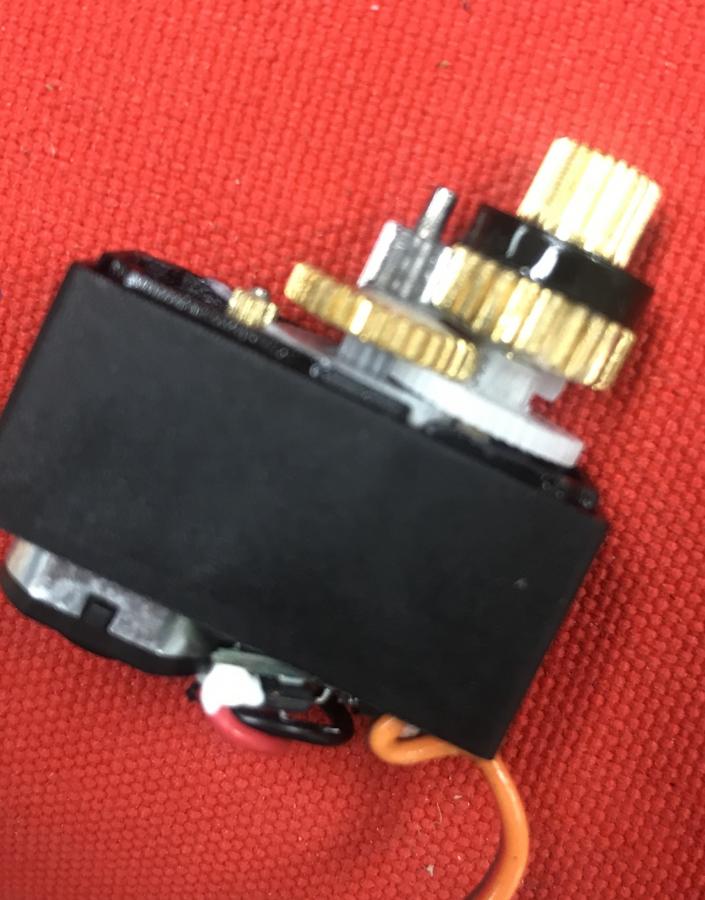

                      Another OBTW in the product. All the servos are marketed as "metal geared." However, after my crash one of the elevator servos had stripped. So I pulled it apart, and lo and behold, there's a nylon gear in there. Which stripped.
                      Weak link.
                                  Weak link.
                                  Having a plastic gear in a servo labeled as “metal gear” is perfectly normal.
                                  Here is an explanation.
                                  • curlyculp
                                    • Jun 2018
                                    • 133
                                    #2577
                                    https://www.rcgroups.com/forums/show...76&postcount=6
                                    Good info. Thanks.

                                        MRC now lists two types of metal gear servos. One says Hybrid Metal Gear and has a gold drive gear:
                                        The other is a full metal gear and has a silver drive gear:
                                        In the F-22, Freewing used the full metal gear version on the full-flying stabs, but the hybrid version on the F-18. I personally think this was a mistake and the F-18 really needs the full metal gear version. I had a pair of the full metal gear servos left over from a crashed F-22 and put them in my replacement F-18. I have not flown it yet, but I fully expect the full metal gear servos to be up to the task.
