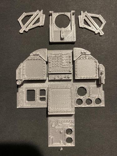

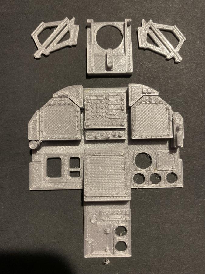

                                Hey Steve,
                                Here’s what I have for my F-18. The plan is to fly her first with the stock cockpit, Schuebeler AXI 51 HDS 1400kv on 10s 4500. Depending on the final battery location, I plan to design a complete cockpit with the floor as deep as possible. Files will be released when everything is ready.
                                My Hornet came with two faulty wing servos, replacements from MRC EU are on the way.

                                • Originally posted by Radar-Guy View Post
                                  Hey Steve,
                                  Frank, you are amazing!
                                  • Originally posted by RCjetdude View Post
                                    Thanks a lot!
