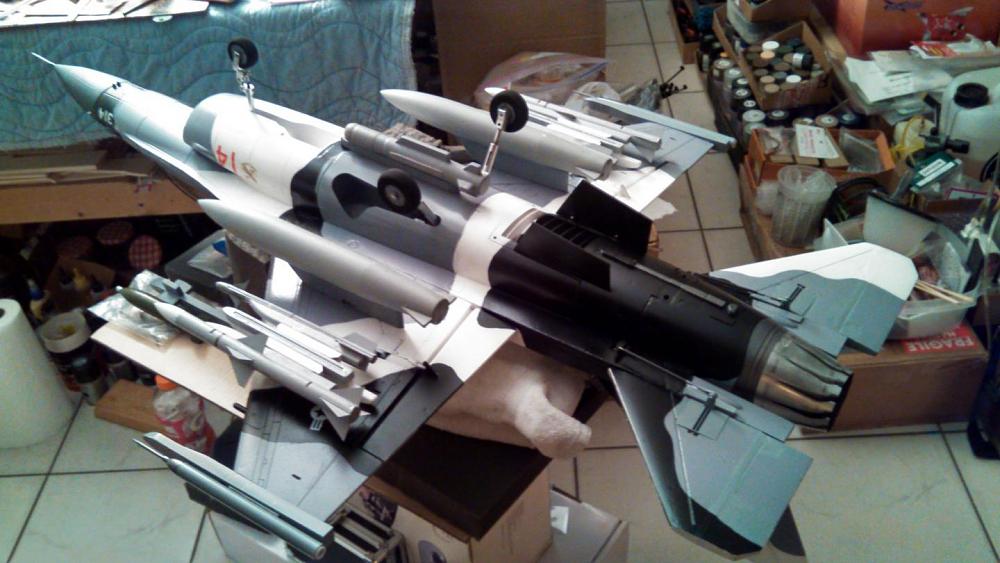

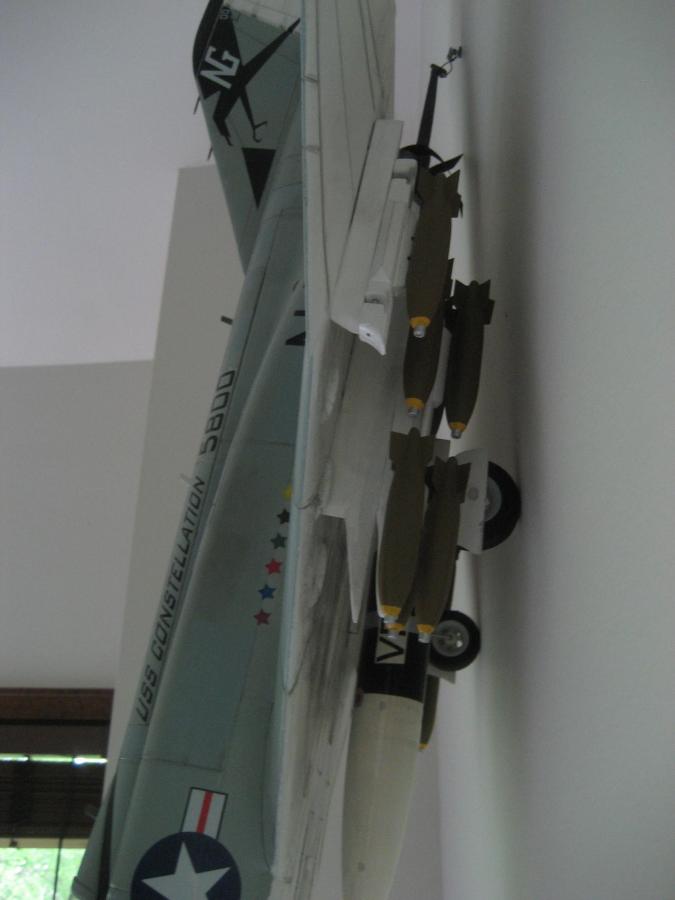

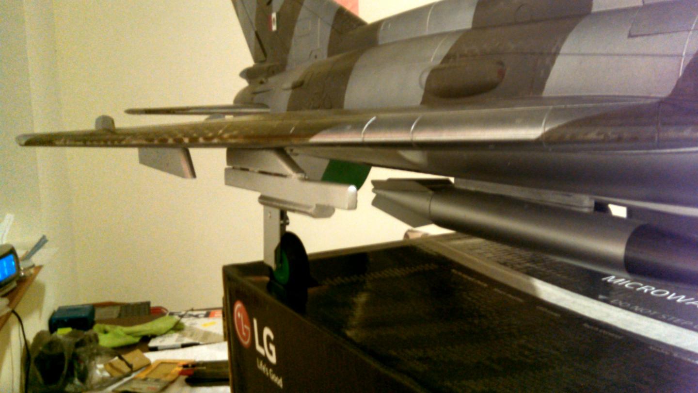

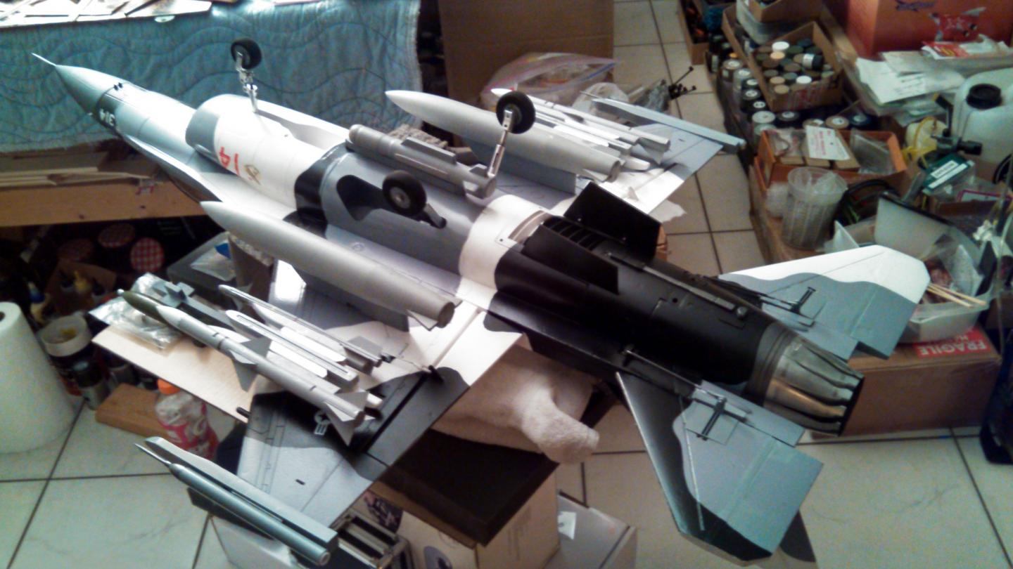

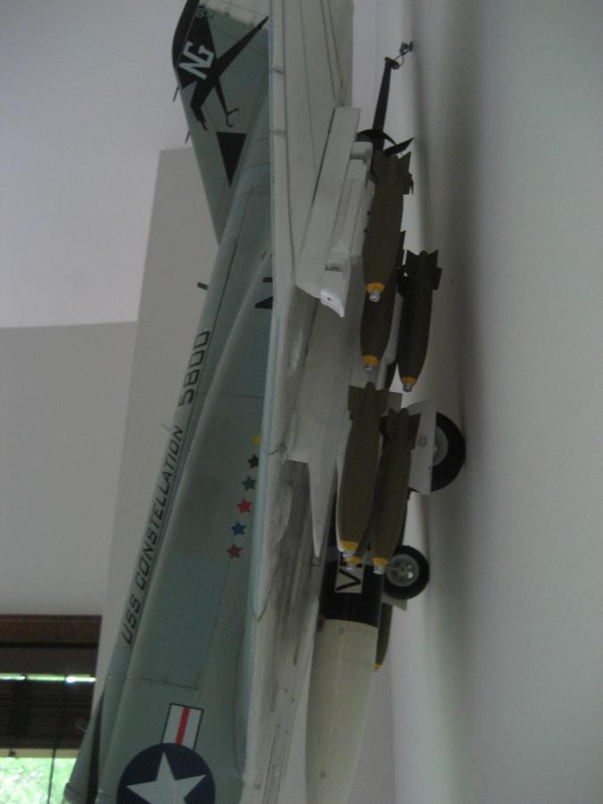

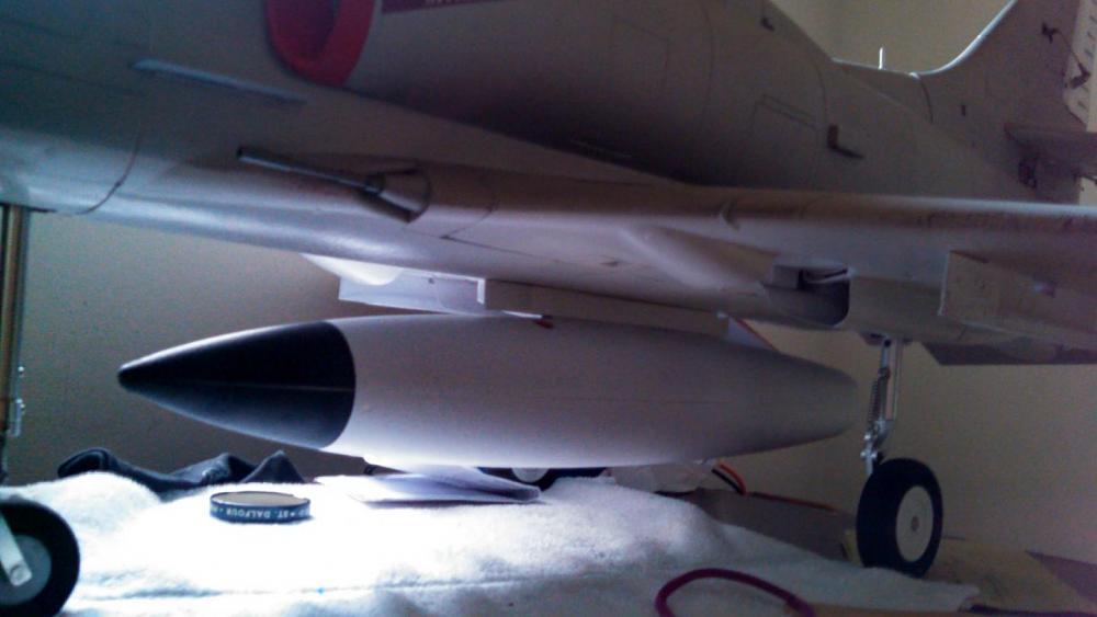

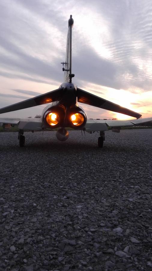

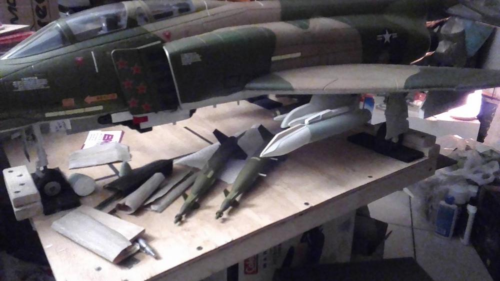

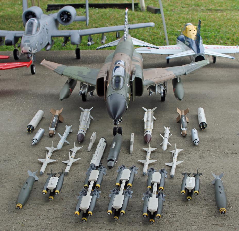

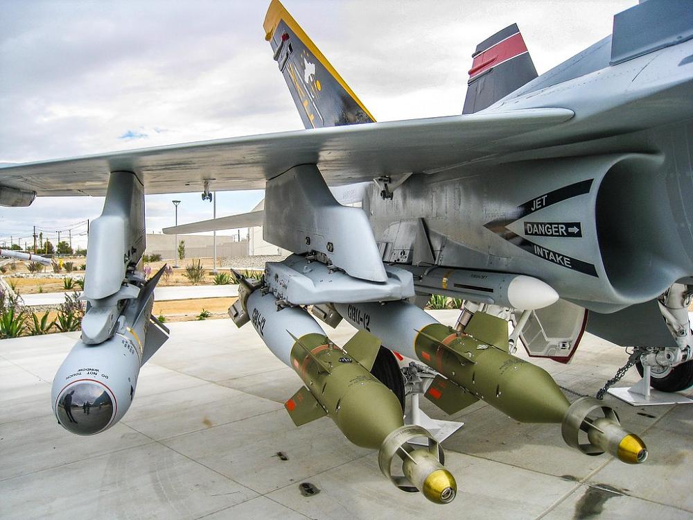

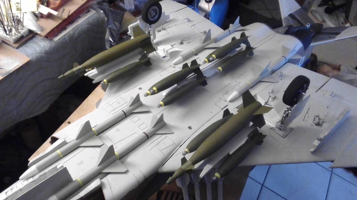

                      WellNow,.. Some of us feel that if your 'Warbird' cannot be flown like this, .... then, what's the point of it all !!! Why not just get a Avanti then, and paint it Gray ?? Hahahahaha. Might consider making them there Stores Drop-able, ya reckon !! ...in case you gotta Lose them in a hurry!
                      Heavy 'DirtyJets' fly very differently than their Clean, Demonstration Configured counterparts ... it is a Skill that must be learned, and Mastered just like everything else. GL

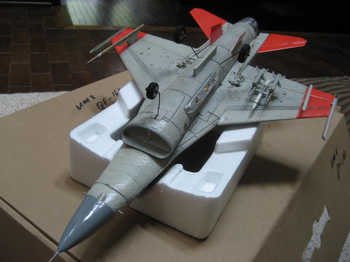

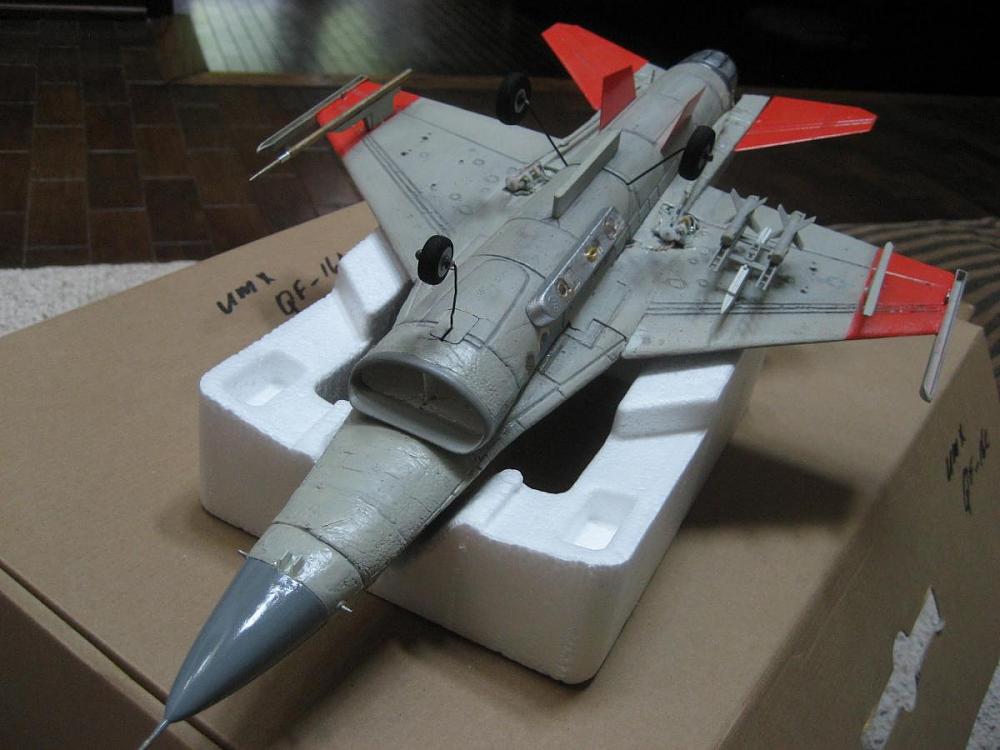

                          Ubetcha !! That's the plan... I'll even UTube it for ya !!! Hahahahaha
                          Those Stores of yours are most likely 3DP ..?? I'm guessing
                          Kinda Heavy. The CG of those things must be calculated for, as well as their incidence along the Longitudinal Axis... Mostly I use Foam for my OrdPackages,... Keeps the weight Negligible. Drag and Incidence are then the real critical factors on my stuff. Cheers !!
                          You can always Make them Drop-able !! Or just fly a 'Naked' Fleet Hornet around !!
                          Seriously though, have you got another Jet you can mount these things onto and Evaluate them. Check the flight characteristics and see how the airplane reacts to them ?? That might be a start if you're serious about solving your controllability issue. I've been flying stuff Hangin' Down off my Jets for as long as I can remember.... Soooooooooo, I guess I don't really understand what the problem is.
                          I've got stuff hanging off a E-Flite UMX F-16C here... and that thing could barely fly itself around to begin with !! So yes, I understand that there are challenges to overcome with this wing stores Business !!! Hahahahaha

                              Outstanding !!! .... Fair Enough. Hahahahaha. Incidence is probably a more Critical component then on this one !! Notice the Wedge shaped Pylons on all of my stuff. Get the Nose of your CLTank Drooped a bit below the Longitudinal CL. That'll help with the Airflow interface under there.
                              I run a CLTank on Everything.... MiG -21/A-4/F-15/F-16 and the F-4. Often only the Centerline Tank . I'd start with a CLTank on one of those. I'd recommend the F-4 as it handles many different configurations so well with very little trim changes. if..... you are feeling it !! Cheers and GL.
