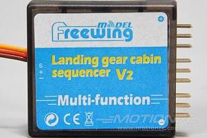

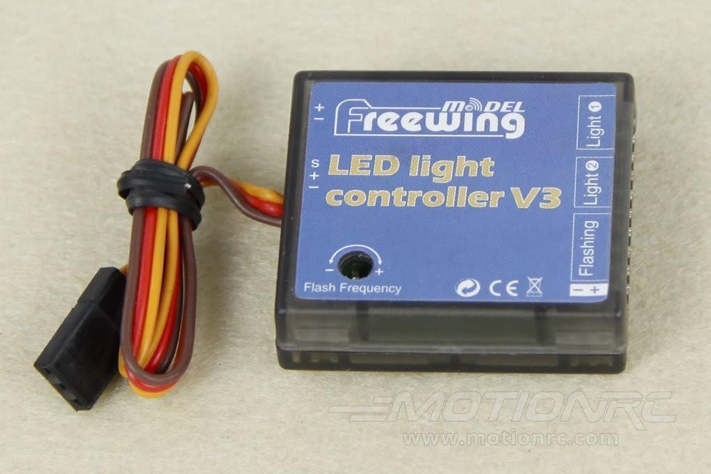

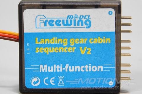

                  Got my bird yesterday and had a quick look on it. Really nice finish! However, bypassing the blue box will be a thing but according all the experiences mentioned here, it seems to be necessary.
                  Some mentioned they left the gear and the lights connected to the box, others bypassed the box completely. What is the solution for the lights in the later case?

                    If you bypass the BB which I have done you can use the Freewing Gear & led sequencer.. Definitely Gremlin proof.. Concept of the BB is great but unfortunately q/c is patchy..To quote Clint Eastwood’s famous line.. Do you feel lucky..Punk??Click image for larger version  Name:	83FB94C2-1EA8-4F8E-8A32-2B100B36DFD5.jpeg Views:	0 Size:	36.9 KB ID:	206119Click image for larger version  Name:	5D0CE211-CDC0-4801-9C78-E0D5EAB98A47.jpeg Views:	0 Size:	104.3 KB ID:	206120

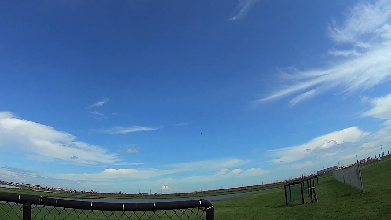

                          Here's my flight from this morning. Spektrum TX, Lemon RX, HobbyEagle gyro, stock wiring through blue box, 5000mah, 6s Admiral. Flew it twice today, both times were uneventful except that the flight I didn't get on video was the one that landed perfectly flat and didn't tip over on the bumps like the one in the vid.
                          Spectrum and LemonRX are a great combo! I have used the RX with Gyro in several of my planes and am actually going to be switching my 90mm F-16 back to it because I was able to fine tune the gains much better and had the plane flying rock solid! The A3L that I am using works great but it isn't doing exactly how I want. I know that there are higher end ones but the lemon is just far to easy... If they ever work out the issues with the blue angel I plan to get one. For now I will be getting the Kit Plus Grey one and doing a VFC-13 hornet...

                                  First of all, let me say that I value any oppinion and answer to my questions no matter who was written it.
                                  I totally agree on this one. However, I do not want to risk a 500€ jet because of an electronics item that may fail under some conditions. As long as these conditions are not known, I would like to bypass the box. Second reason for doing that is that I would like to have each servo on a seperate channel for mixing etc.
                                  Maybe, I am too cautious but I lost one of my other jets two weeks ago because the newer Spektrum receivers may (or may not) cut off after some random time during flight (I was able to confirm that, see other thread). I can live with problems that can be reproduced clearly and therefore solved. However, the kind of problems (box and voltage cutoffs) are not and I therefore tend/try to take the safest possible way.

                                    Thank you, I just ordered one.
                                      #2158
                                      OK Woody, I will step off into this fray with you!!! The blue box in discussion is this one: https://www.motionrc.com/products/freewing-multi-function-control-box-e-mcb-e. Not good reports from the Hornets that have flown, but... Unless Freewing has changed something in the mfg. processes, this is the same box used before... I verified this before typing this post. I have the L-39, the F-22, the Flightline F4-U Birdcage Corsair, and the F-18C BA. All use the same blue distribution box. The one thing I have changed on all of these is the BEC and the power distribution used. Using a CC 20 amp Pro, https://www.motionrc.com/collections/battery-eliminator-circuits/products/castle-creations-20a-bec-pro This has two power output leads. One plugs into the receiver, (I use all Spektrum) and one plugs into the blue box in an auxiliary port. That way, the power is distributed to both the blue box and the receiver... Also, cycling the gear after power up seems to be key to steering function. Make sure if you transport the bird with gear up, that the gear switch is in the up position before powering up the plane. Transmitter ALWAYS on first. Low throttle, and set the gear switch to match the planes gear position, up or down. This keeps the box from becoming "confused"... Hope this helps some folks out there, but the servo issue is another can of worms... Same servos in the other birds, but this does seem unusual with all the bad servo reports.... Good luck all!!

                                          Surely if the blue boxes are failing then freewing should send these out for free as an alternative for people who have had blue box issues.
                                          Just out of interest has anyone experienced issue running Futaba yet? Dont think I've heard any problems with Futaba so hopefully I'll be alright and be able to run it as it comes out of the box when it finally arrives that is.
