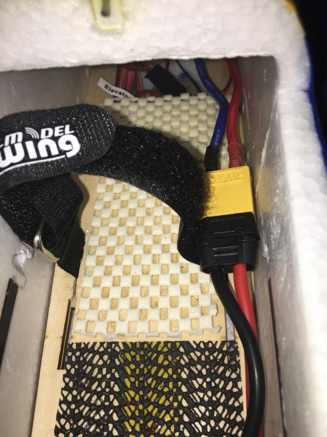

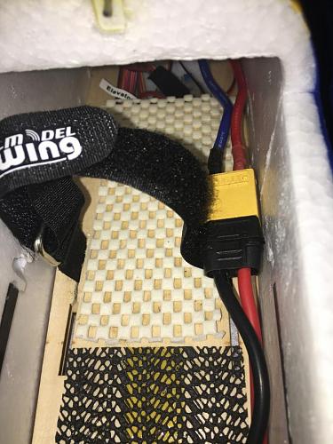

                No issue whatsoever with the 920gm battery if you bury the BB under the ply plate .. That’ll give you heaps of battery space .. My CNHL 5000mah 6s G+ 70c weigh 873gms have no issue fitting & easily CGs..No mod to Canopy to fit heavier battery .. All I did was extend battery strap by hacksawing the strap track so there’s a better purchase on the Battery.. Click image for larger version

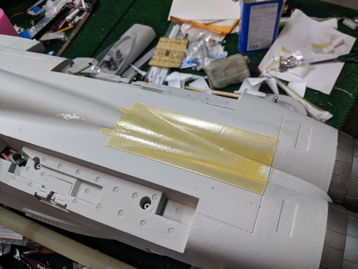

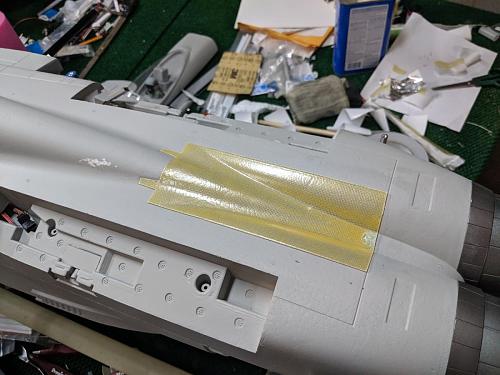

                                      Speed brake progress. Also got the exhaust ducts lined with foil tape. Trying Gooniacs CB on this one.
