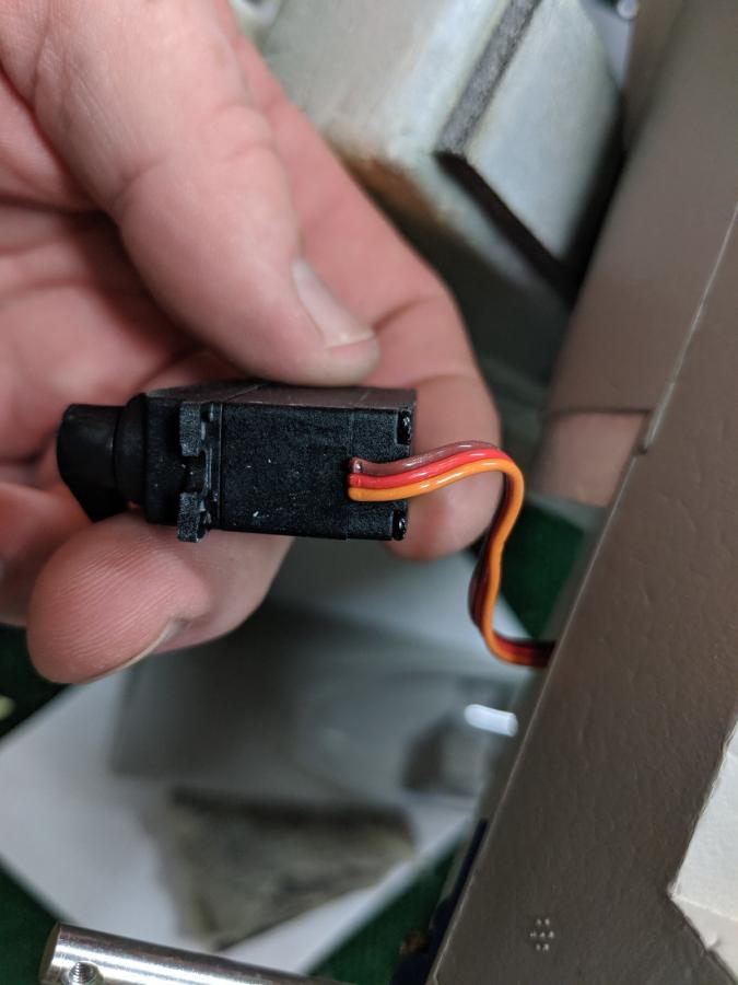

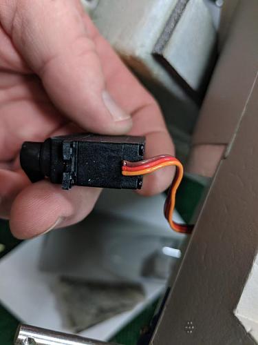

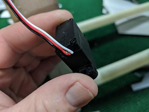

      I just removed the elevator servos from my gray F-18 that I am working on and found the insulation on the leads cut through on both servos. I will be opening a ticket with MRC customer service accordingly and checking my blue one as well. They are a snug fit in the plastic mount and I think the sharp edge of it is cutting through the insulation.
      Click image for larger version  Name:	IMG_20190707_195446.jpg Views:	0 Size:	73.3 KB ID:	204884
      Click image for larger version  Name:	IMG_20190707_195743.jpg Views:	0 Size:	46.7 KB ID:	204885
        Oh boy, close call there I would say, glad you caught that now or your grey one might have been a lawn dart.:Whew:

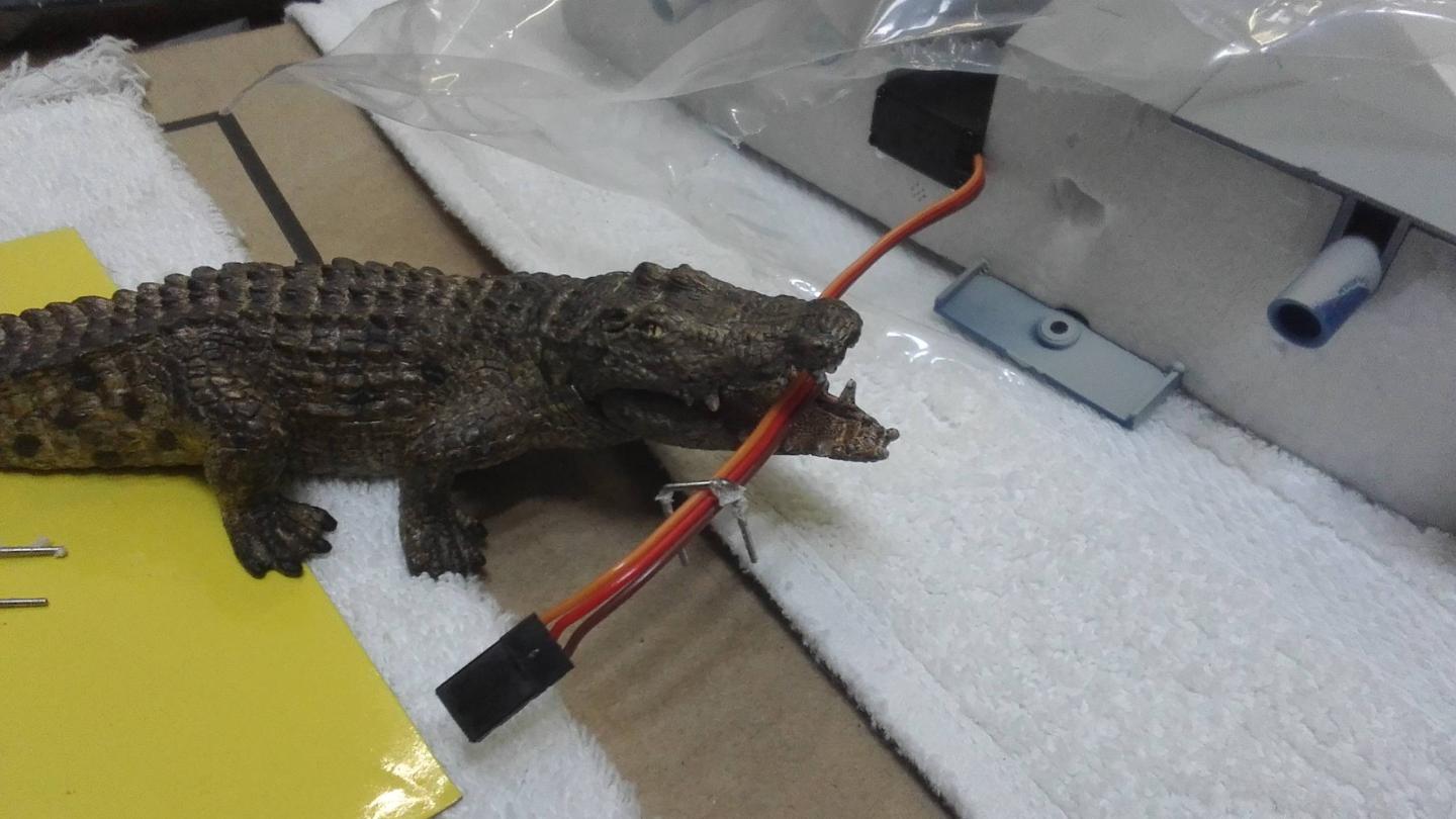

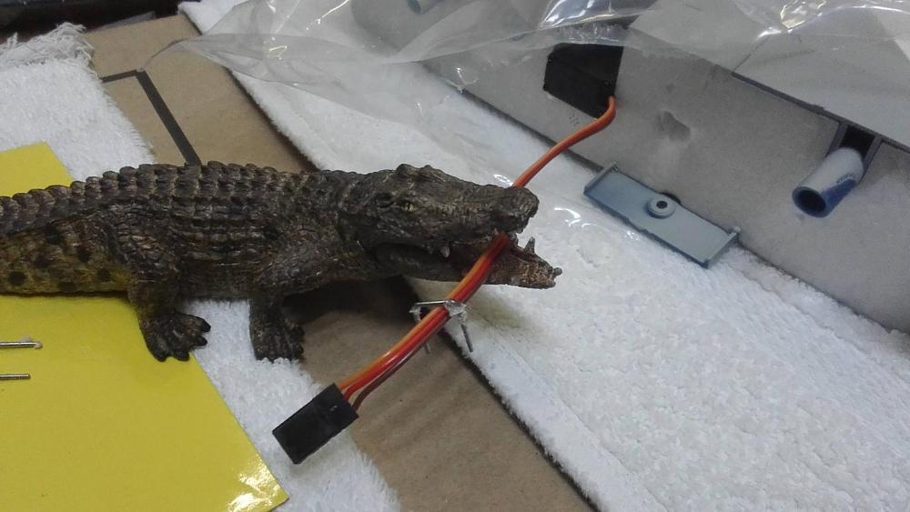

            I posted my Rudder Servo lead Staples situation somewhere. This type of Arcing/Shorting was a possibility for failure of those servos also. Click image for larger version
                I put it out here as a caution to check your birds.

                              Since it is appearing t be the insulation getting cut by the plastic insert in the foam, I'd pull and inspect.
                              This could explain some odd crashes others reported with other aircraft also. If its cutting insulation it could also be cutting wire in the insulation.

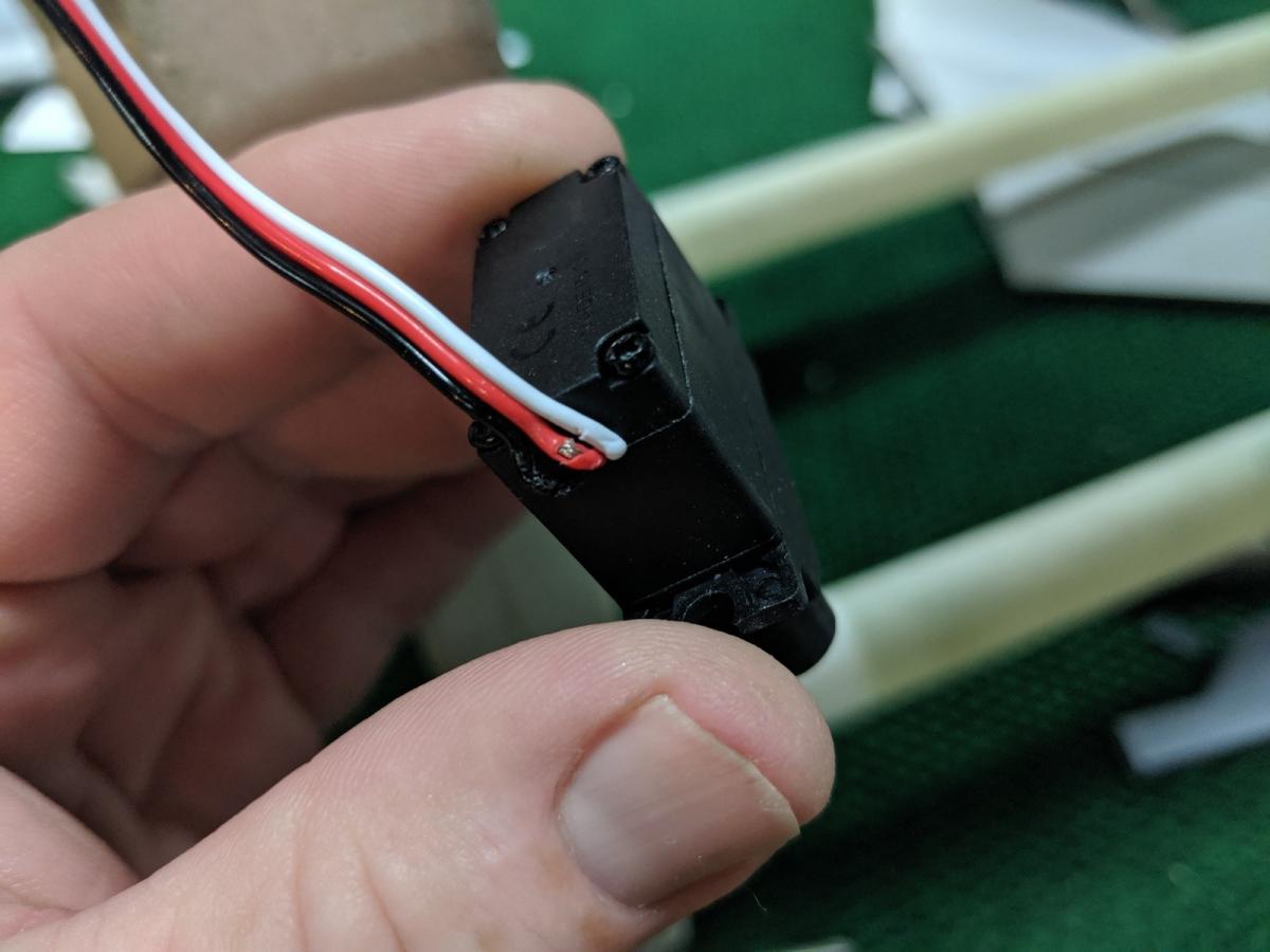

                                I'll have to check my servos, i installed new ones and saw how close it was to the wire. Took a xacto knife and shave the edge a little.

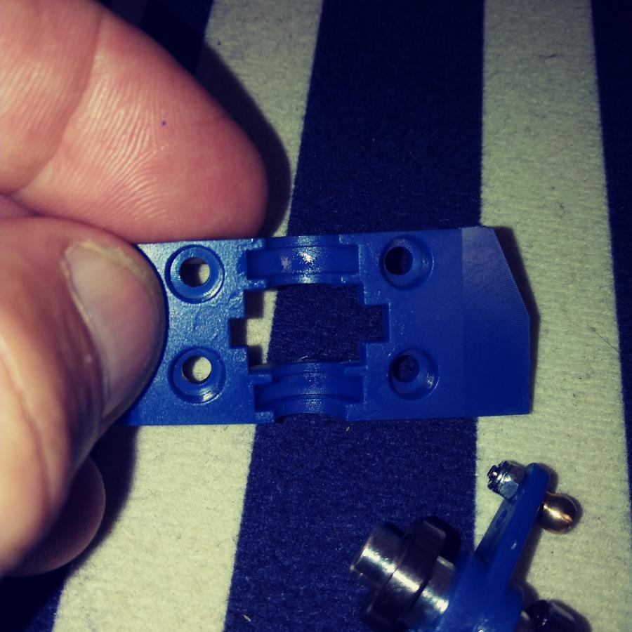

                                      My Elevator servo findings.
                                      The servo wire clashes with the servo screw mounting post on the underside of its mounting
                                      plate.
