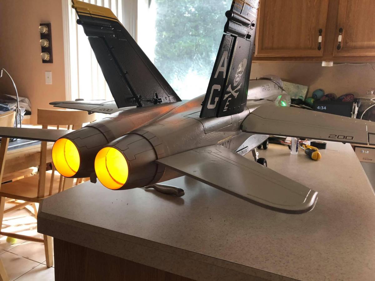

                              • Testimonials about the Lightburner will look amazing on this F-18 check out the details of the unique setup in the link provided
                                I ordered 2 different versions for my planes. One was a single 70mm f16 eflite and the other was a dual setup for my fa18. What sets this apart from...
