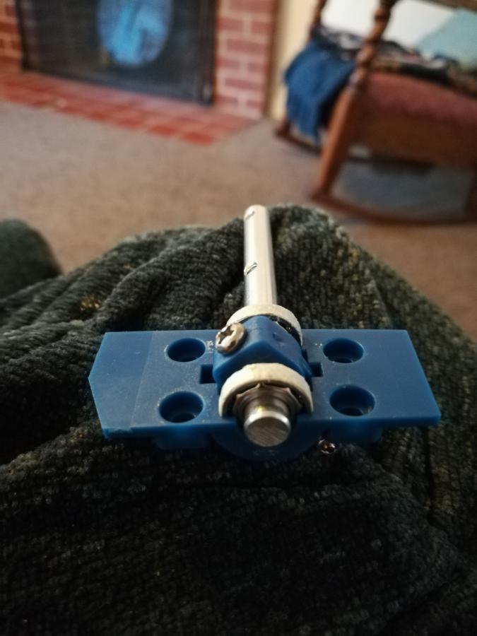

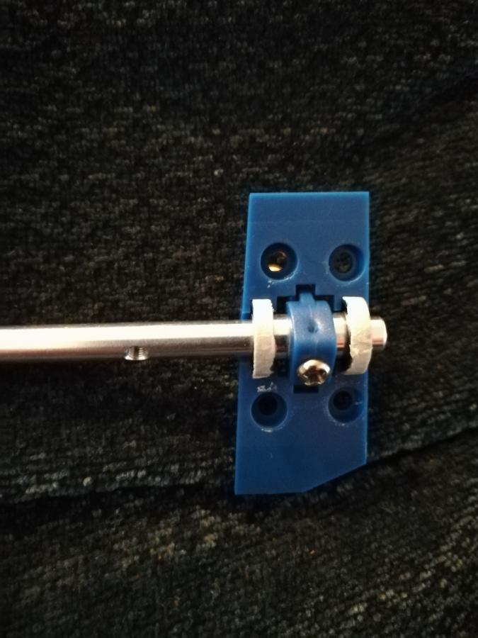

    Hey guys, wanted to share an old trick I used to do on taking the slop out of bearing play, I did this on my helicopters all the time, worked great for the bearings that were installed in the frames, you helicopter guys will know what I'm talking about, so I tried it on the F-18 elevators and it works great. Just roll the bearing up in one round of masking tape, the tan sticky masking tape works best, trim off the excess with a sharp exacto knife, say goodbye to slop and no messy glue.
          Nice trick, thanks for the tip!

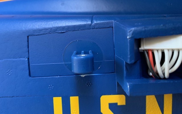

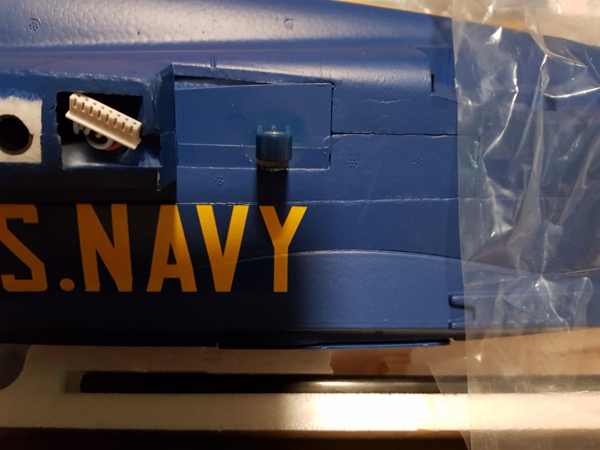

            Hey guys, got my BA yesterday. Unfortunately the mountings of the wings to the fuselage do not fit together. Did anybody have the same issue?
            Second, is there a possibility to eliminate the time delay with gear extension?
            thx

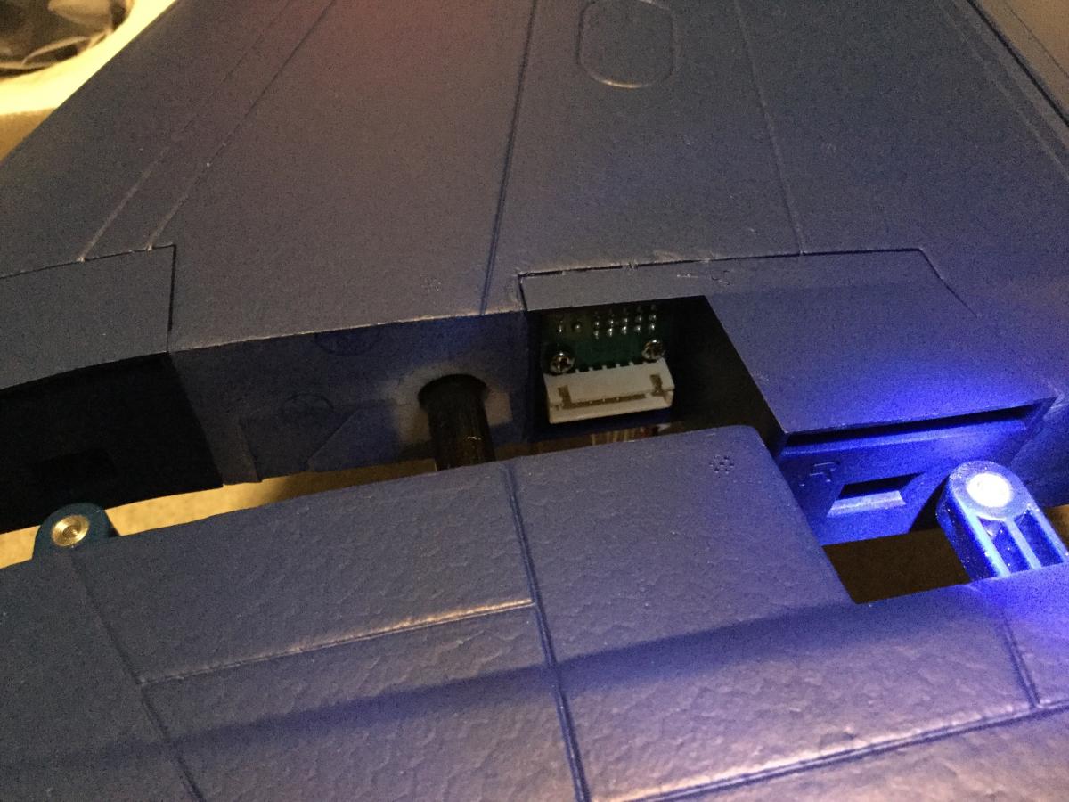

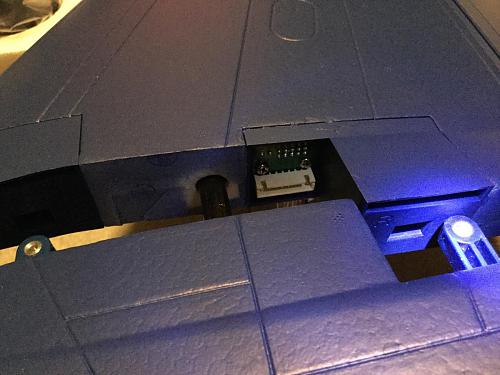

              #2186
              So I have come across something here I have not come across before and not sure if this needs to be addressed with MRC or if there is a simple solution. So everything is centered, servos travels, sub trim and D/R’s as you can see in the pics on my radio, so when I do left and the right on my ailerons one way it shows 30 something mm’s and then the other direction it shows 20 something mm’s. If I adjust travels or anything else, then I am making the other side off by the amount I am adjusting on opposite side. The only other thing I can think of is bypassing the y connection and making each aileron on its own channel that allows me to adjust each individually. I don’t feel I should have to do this, but I don’t really understand what could be causing the differences in deflection that I am seeing. Had friend look at it and he is not sure why it is different either.
              Any more suggestions other than what I have listed above, or do I need to open a ticket with MRC?

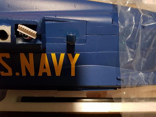

                thx
                Got mine from MRC EU on Monday. No issue here. the wrong part appears to be on the fuselage side. My connection parts on the right wing look the same.

                  #2188
                  Click image for larger version Name:	IMG_3075.jpg Views:	0 Size:	46.2 KB ID:	206324
                  Thx, we'll see.
                    #2189
                    thx
                    Click image for larger version Name:	64C382A3-6D94-4E51-B234-5148D8EFDF2D.jpeg Views:	0 Size:	132.7 KB ID:	206312
                    Did they get the wing mount in upside down in the fuse?

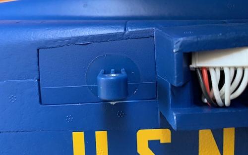

                      #2190
                      Ya, you're right. Due to the shape of the plate it should be fail safe. But they made it fitting!

                        #2191
                        Mine is the same and it flies okay like that. It's mechanical differential.
                        I'm sure the usual's will be on soon with page long explanations about how it won't work even though they don't have or fly the F-18.
                        Any my suggestions other than what I have listed above, or do I need to open a ticket with MRC?

                          Some things are inexcusable and this is one of them. Amazing!

                            #2193
                            It’s not upside down. Did they glue the rear wing mounts on the wrong sides?
                              • 5401
                              #2194
                              They put in two right hand sides...:face_with_raised_ey

                                #2195
                                thx
                                It looks like the plastic wing mount is glued on 180* out of sync with the wing. Sorry for your issue, MRC will need to replace your plane. The time delay is built into the control board of the Blue Box and cannot be turned off.
                                Rich
ID:	206343Click image for larger version
                                  • 8804
                                  #2196
                                  Where's that "face palm" emoji when you need one? Well, this one will do .................................... :poop:
                                    #2197
                                    thx
                                    I got the other one...yours has two right side mounts, mine had two left hand mounts. Just open a ticket and MRC will take care of it

                                      #2198
                                      Funny, already done. But I had to do it twice, because MRC EU is in charge, not US. This plane has a little bit of bad luck, indeed.
