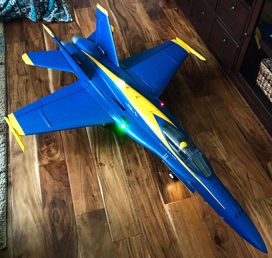

                I have never had any issues with the "BB" as you call it, but I cannot rule that out as a potential cause as well. After some gluing and still have some paint touch up to do, I cannot believe how relatively unscathed she came away from the crash. It could have - should have - been a total disaster. This one will fly again but I am going to have to wait on the new nose retract system.

                  Good job on the Repairs :Cool:The nose Retract is the same as the Avanti’s so if the strut is intact just use the Avanti’s & you're good to go..

                      Thanks! Ah, if I only had the Avanti! I sold it a while back. Oh well, I'll just have to wait for Mr. PostPerson to deliver a new unit. Shame, because all I need is the metal arm but the strut and wheel set didn't come with it.
