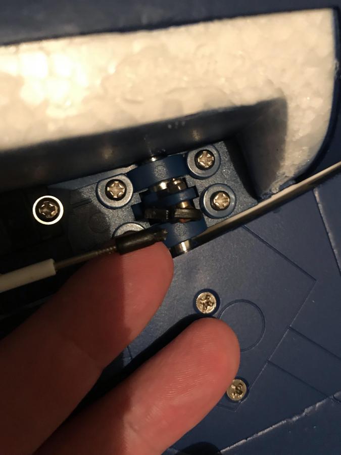

      I put a new clevis on and noticed tightening it causes a twisting torque between the shaft that screws on and the part that pops onto the ball link. That middle section gets weak quick. I am now wondering if that is what happened...When twisting them on to the pushrod during the build, did the middle piece twist a bit causing a weakness during flight? If so, snapping off would have caused the elevator to pitch straight up (or down) relative to the other which would certainly have created the type of sudden loss of control that occurred. I want to blame a brown out but I cannot rule that out as a possibility. Something for everyone during the build phase to keep an eye on. I do seem to recall some of them being harder to tighten than others but didn't think anything of it at the time.

                    Interesting, thanks for that tidbit...Very interesting indeed. It's certainly a possibility, however the quick guide and specs show an operating range between 3.45 - 8.4V. Still, I won't be putting that rx in my next PNP...I usually use the 10 channel but the F-22 and other models are using that one at the moment. As for the clevis issue I mentioned, here's a photo post crash...
                    Click image for larger version  Name:	clevisdamagepostmaidencrash.jpg Views:	0 Size:	48.9 KB ID:	201620

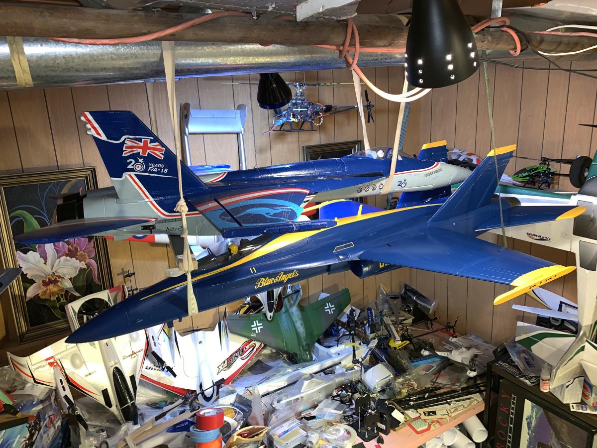

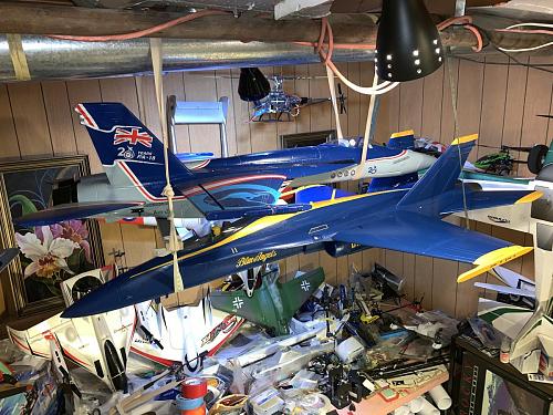

                        So, what do you do when you start to run out of space for that next new plane? You do a "double decker hanger upper".
                        Not quite finished yet but I wanted a place to store it once it's done. Weather is pretty bad and won't be able to fly it for a week, maybe more. Still got the decals to do and balance it with the batteries I plan to use. Comparing this one to my old "OZ" one, I can say right away that the new version is a lot better in quality, design and execution. All control surfaces are much nicer and those giant flaps will come in handy. Battery compartment is huge compared to the old one. The "blue box" does make for a much tidier assembly. The old one is powered by the inrunner fan/motor from the 90mm Yak 130 and it needs it, as well as the thrust vectoring to get it to rotate off grass. Foam quality is great and the gear doors are a marvel by comparison.

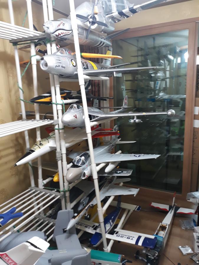

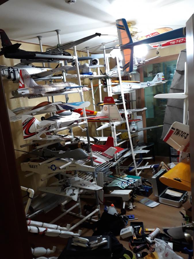

                        Xviper you and I have a similar problem, storage! Haha, I am trying to solve mine with PVC, one more rack to build and I think I'll have this mess under control!:Cool:
                          My problem is I have no floorspace. Except for the cars in the garage and my hobby tables, Floor space belongs to the wife’s stuff. Ceiling space is all mine as long as it doesn’t hit our heads when we walk through.

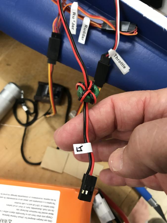

                                    Anyone know what the green donut is for?

                                        Attention Curlyculp:
                                        Yes...............;)
                                        Oh...........you want to know what it does LOL
                                        It is known as an iron ferrite core.
                                        The geometry and electromagnetic properties of coiled wire over the ferrite core result in an impedance for high-frequency signals, attenuating high-frequency EMI/RFI electronic noise. In laymans terms it is a RF noise suppressor.
