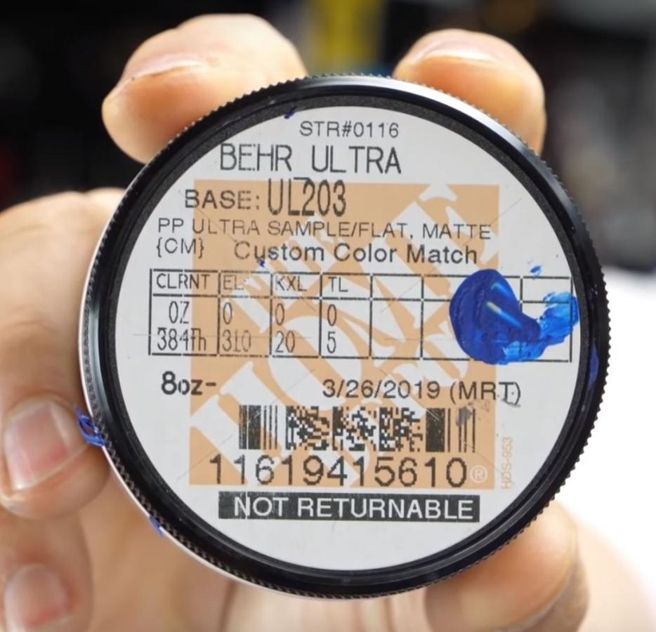

                                        Good to hear Danny and Pat! It's easy to lump all the models into those of us who have had issues but the truth is, these are isolated cases, not the norm I believe.
                                        When my next PNP arrives, I will be working on the assumption that everything will be fine unless proven otherwise. Build, test, pre-flight checks, fly!
                                        As for the paint match, can anyone offer a really close paint match? I was going off of this image that I believe James posted earlier in the thread but I am assuming it was based on his pre-production model, not the mass produced which we all have. When I painted all my scuffs and damage from my crash, I noticed it wasn't a very good match at all. This is the one I was going off of...
