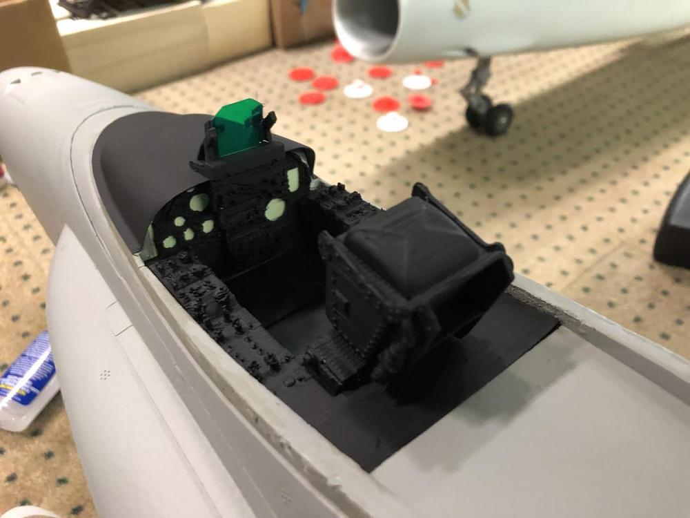

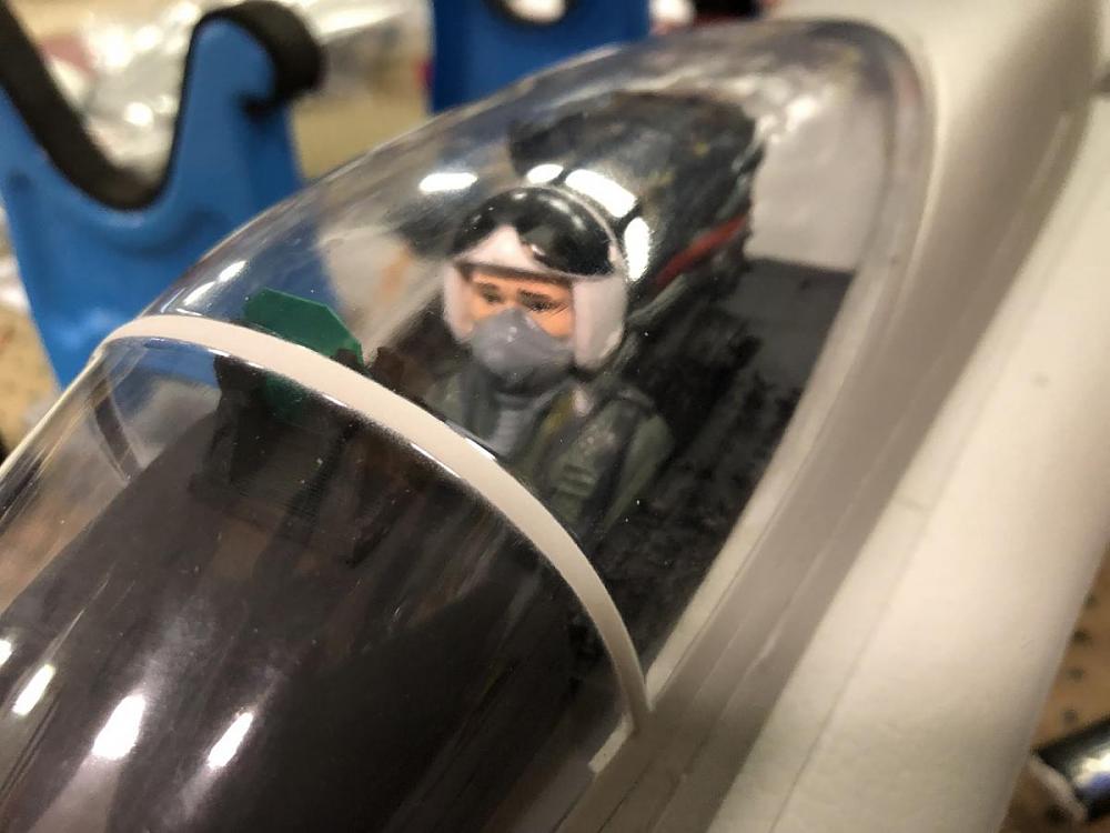

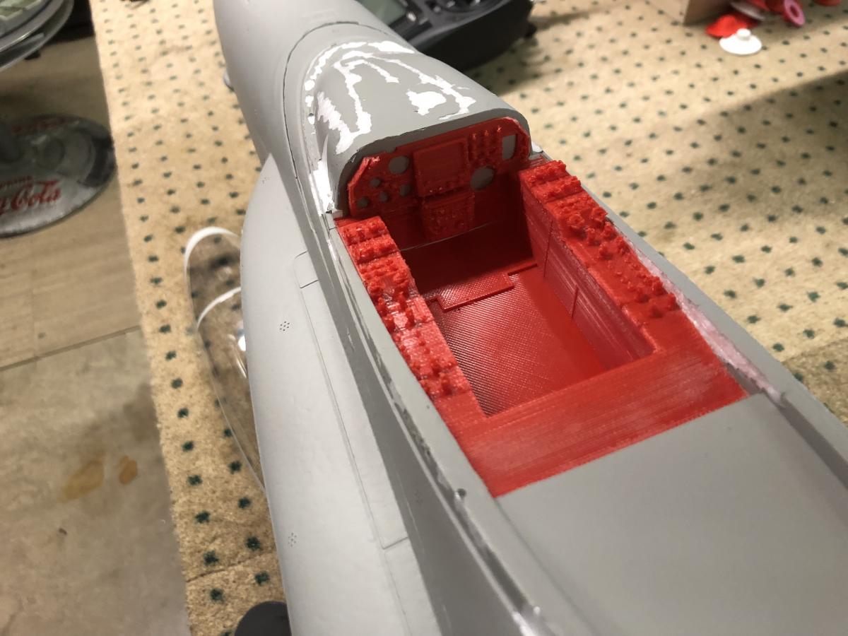

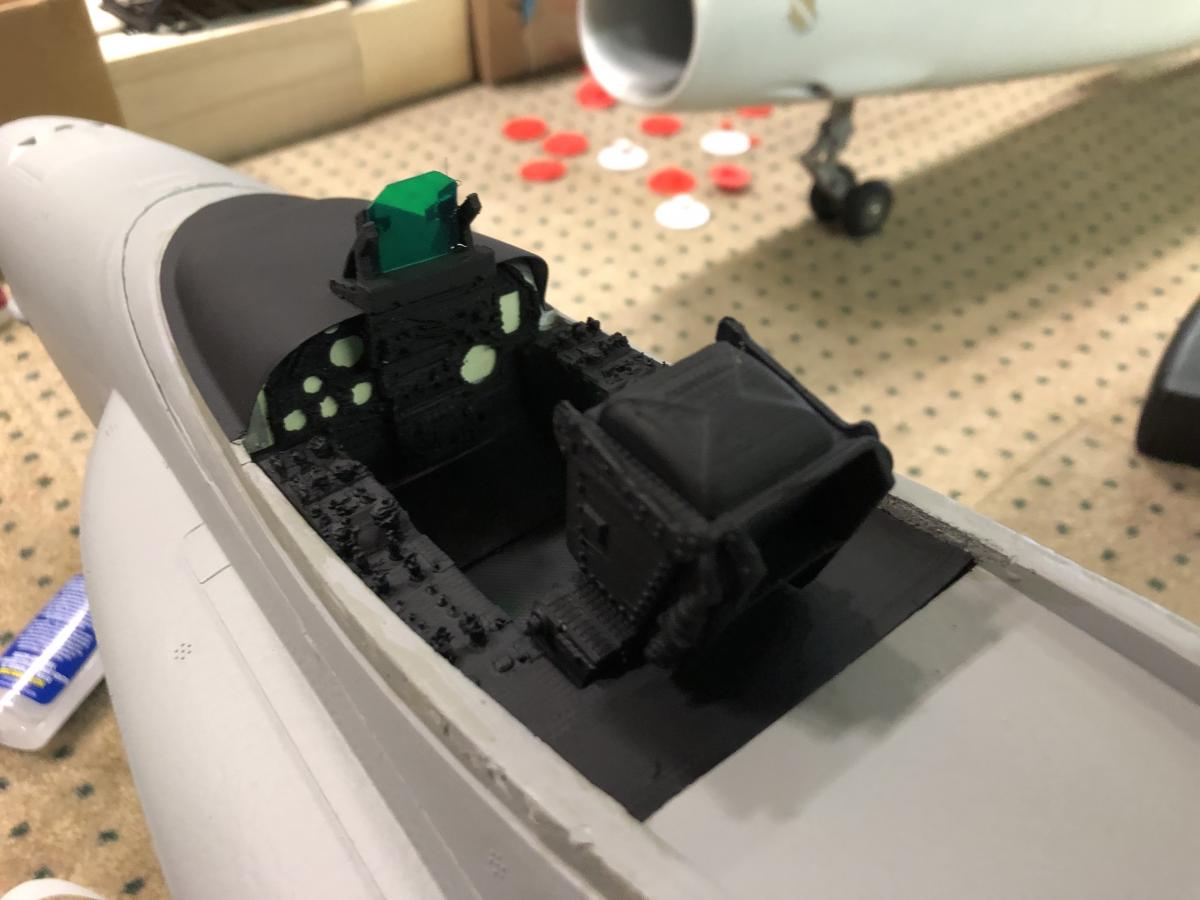

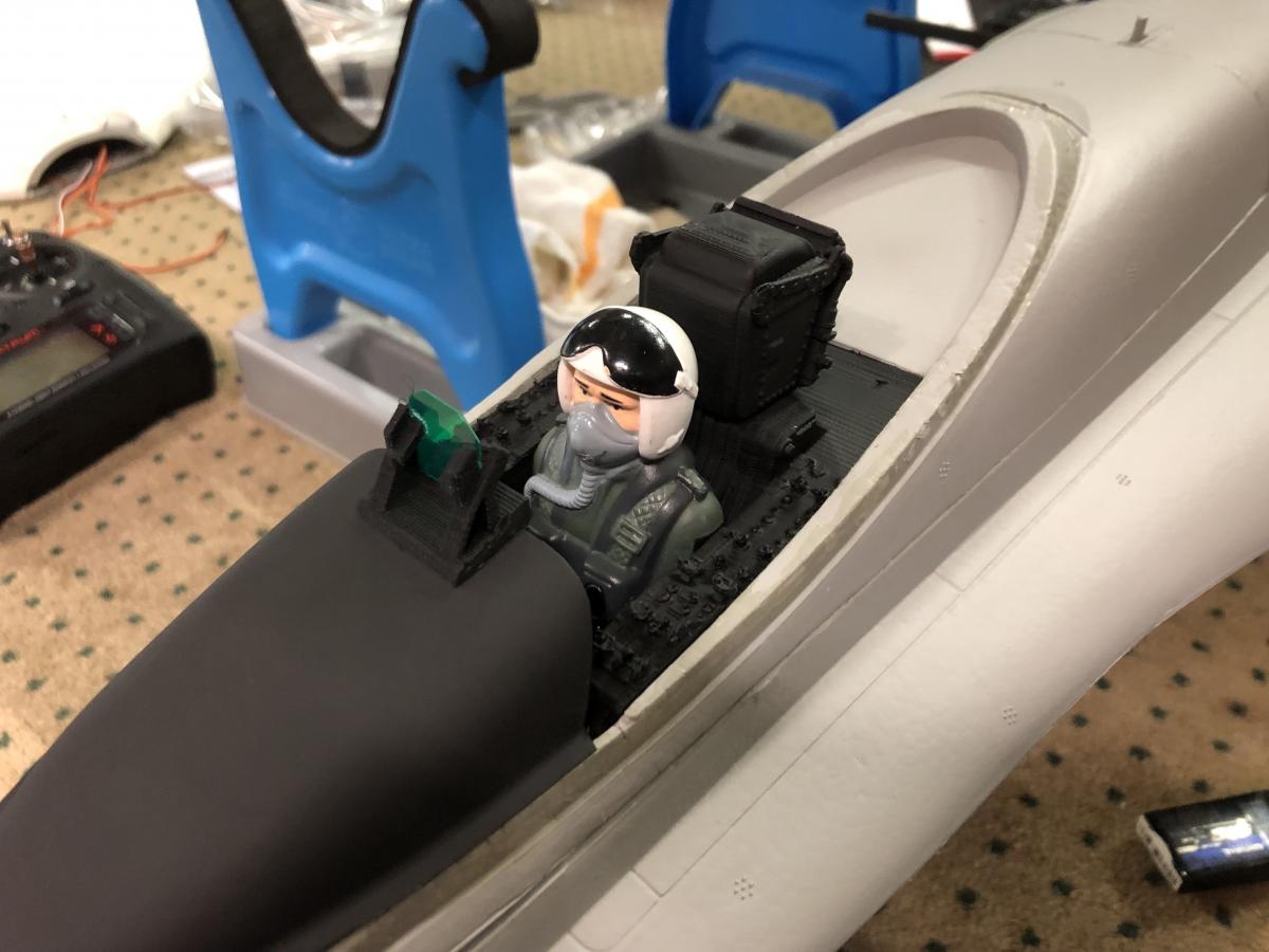

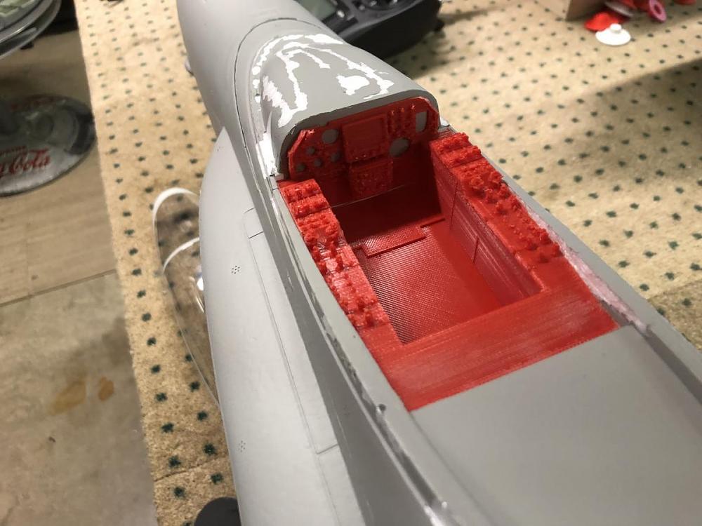

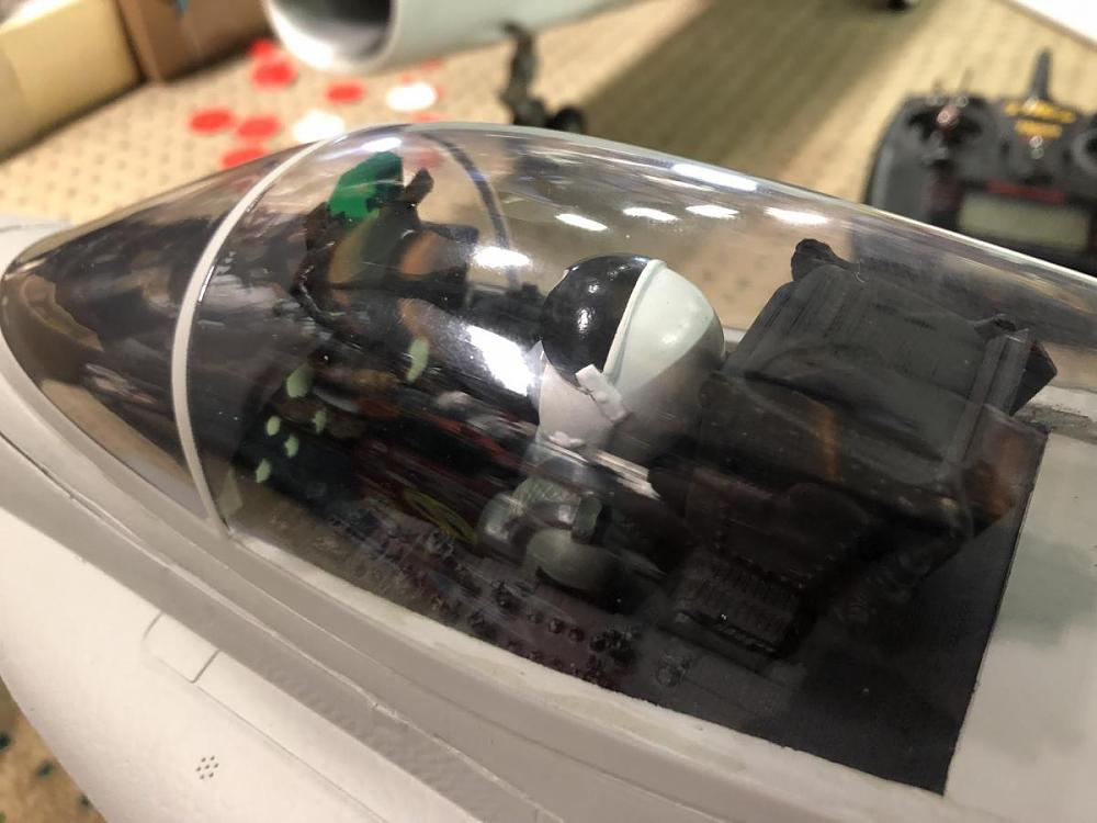

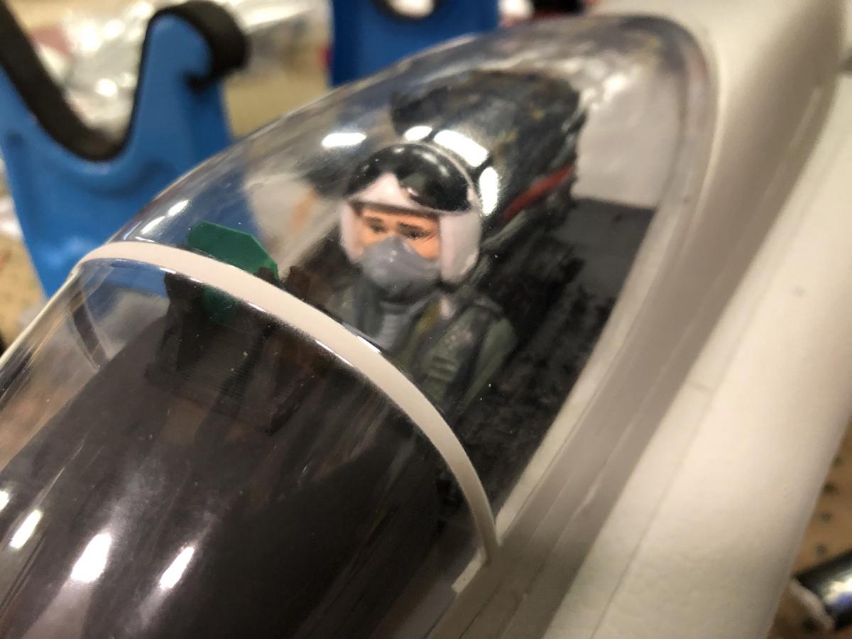

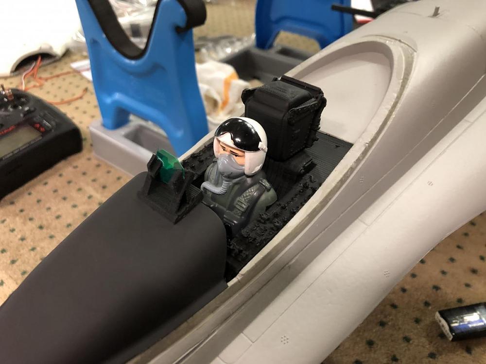

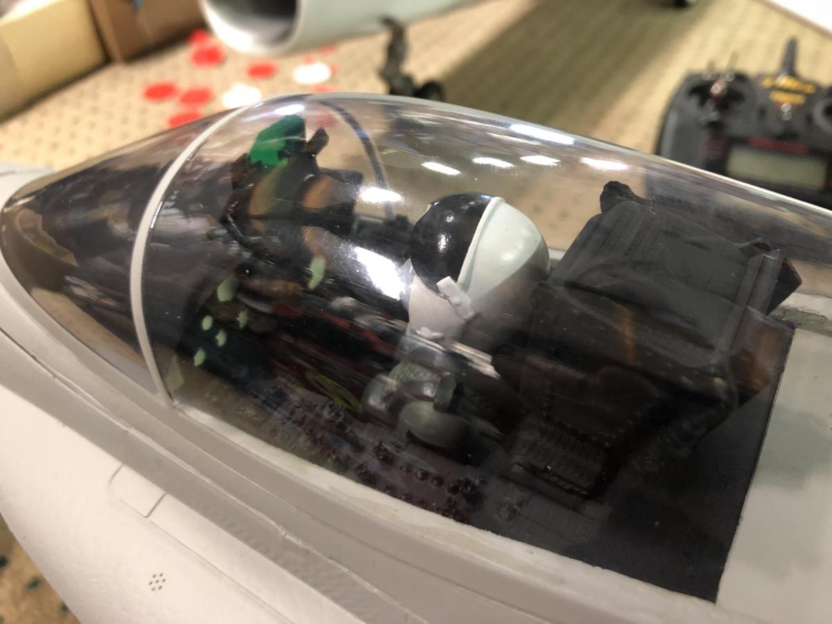

                                    #1057
                                    Originally posted by Bobaroo
                                    Working on a Nice Seat and Pilot for mine to get things up to the Proper proportions up there in the 'Office' on this one. Click image for larger version  Name:	3689433410_04f2e93d1b_z.jpg Views:	82 Size:	49.7 KB ID:	201086
                                    I used the Mirage cockpit and hacked it up some ;)
                                    Click image for larger version  Name:	20190618_182205540_iOS.jpg Views:	19 Size:	80.6 KB ID:	201134
                                    Click image for larger version  Name:	20190618_131545823_iOS.jpg Views:	20 Size:	103.7 KB ID:	201136
                                    Click image for larger version  Name:	20190618_204238083_iOS.jpg Views:	21 Size:	80.4 KB ID:	201135
                                    Click image for larger version  Name:	20190618_204428113_iOS.jpg Views:	21 Size:	89.2 KB ID:	201137
                                    Click image for larger version  Name:	20190618_204337988_iOS.jpg Views:	20 Size:	92.5 KB ID:	201138
                                    Click image for larger version  Name:	20190618_204346977_iOS.jpg Views:	20 Size:	83.1 KB ID:	201139

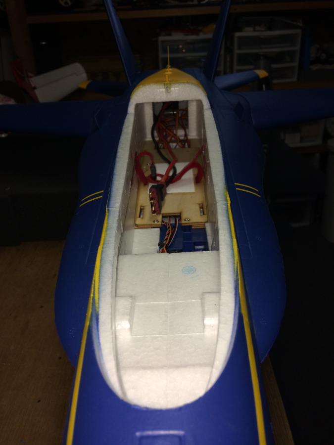

                                        #1059

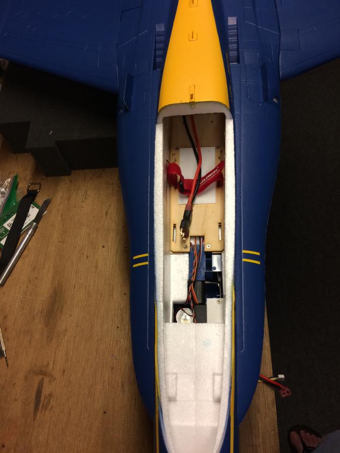

                                        The MCBE gets its power from the retracts I think. Here’s a pic of my clutter.
                                        • thisguy65
                                          • 509
                                          #1060
                                          Assuming your RX is under the plywood, this doesn’t effect the range of the rx/antenna with all the wires on top of it like that?
