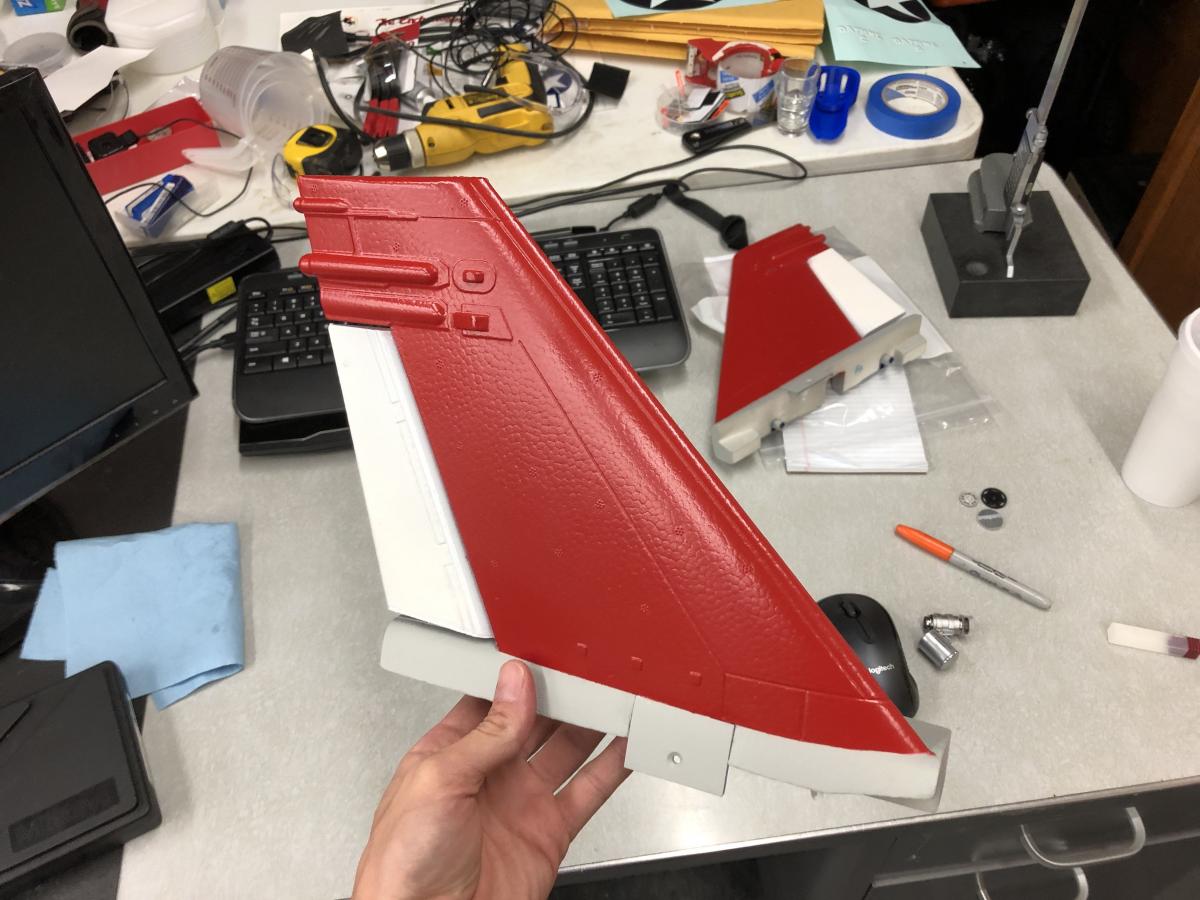

                        Still need to paint vertical stab tips yellow. Not a fan of trying to put decals around those contours.

                          #912
                          Looks nice!

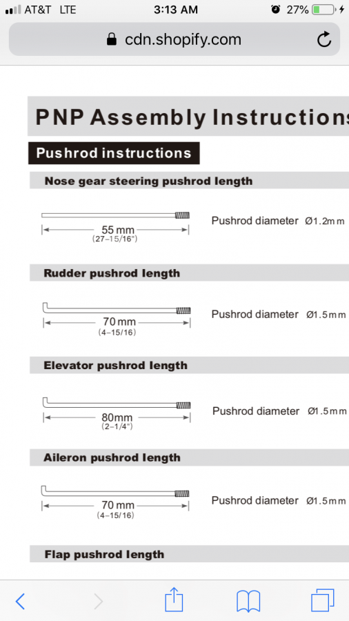

                                        Alpha,
                                        could their possibly be a Typo regard the control rod lengths? And to what control rod goes where?
                                        example, book calls out 80mm rod however the longest is 75mm. 55, 70, 75mm. Are my control rod lengths. (Measured with machinist ruler)
                                        Then the book is saying 80mm for the elevator, there’s no way a 3”+ control is going to fit in there.
