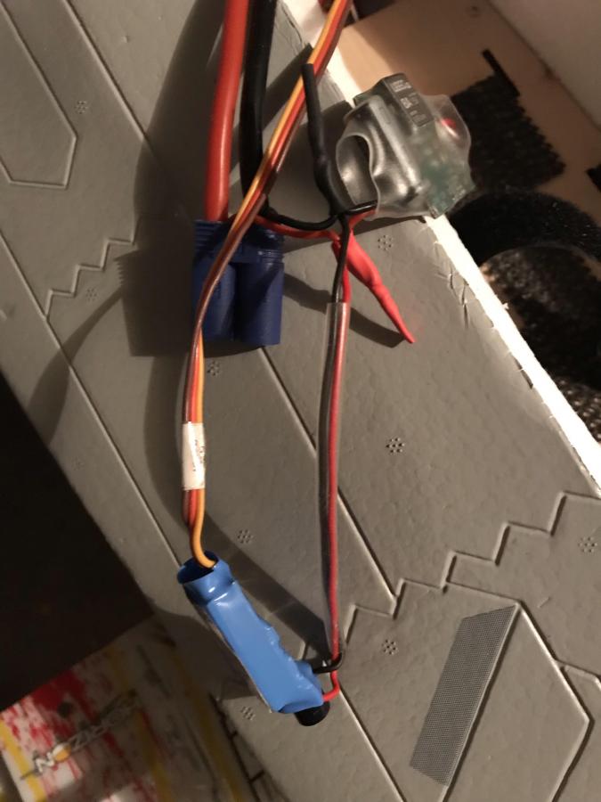

                  I used a Castle 10A I had laying around.

                  • Carlbrainiac
                              becareful that one is 10amp peak. Curious to see what the 8bec rating is.
