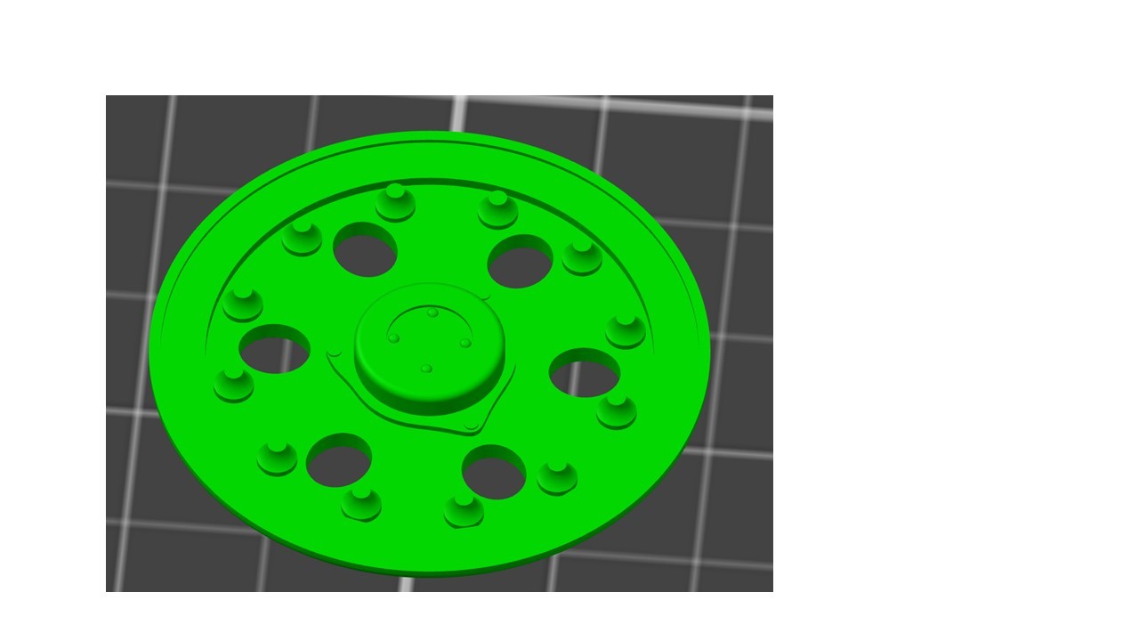

        Ooops, what a major oversight! :Scared:
        Here is the revised design. Btw, the rectangular plates between some of the outer bolts appear to be not standard. I've looked at some pics and there are none of these.

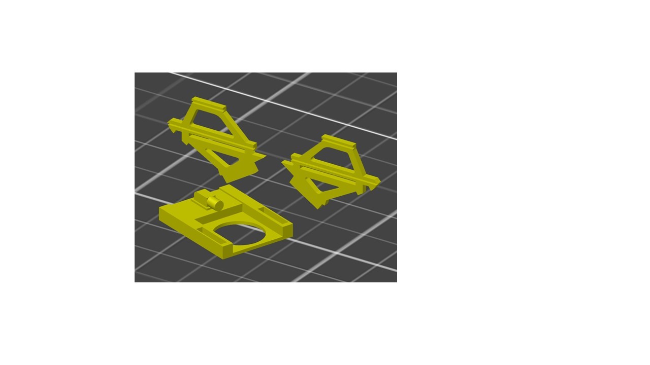

        HUD parts are prepared as well.
        @ Steve (RCjetdude): I assume you will be getting your hands on your F-18 sooner than me (ETA late June over here). Would you volunteer as tester for the hub caps?
        Click image for larger version  Name:	F-18 Hub Cap Design.jpg Views:	0 Size:	63.5 KB ID:	193896
        Click image for larger version  Name:	F-18 HUD Design.jpg Views:	0 Size:	53.2 KB ID:	193897

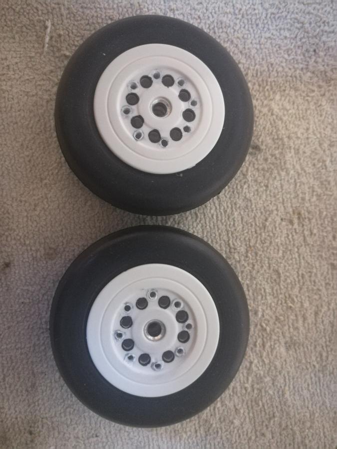

            Well shoot, after looking at the real wheels you posted, I drilled to many holes in mine, these are 90mm F-16 mains, I drilled 8 holes instead of 6. They will have to do for now. :Sweating::)

                Well, keep ‘em spinning and no one will notice;)

                  Yeah your right, no one will notice as long as I keep it rolling.LOL

                        Hey Radar, I'm 3-4 hours from Steve. I'll be willing to test them out. If I can be of help please shoot me a pm.

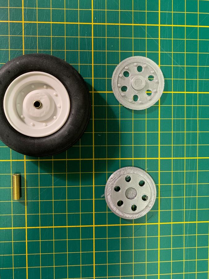

                          OK guys, here is the file for the hub cap. I used 0,15mm layer height, 20% infill and supports. I assume, that the F-18 will come with the same wheels as the F-22 90mm. I think, those were originally designed as nose wheels for the A-10 80mm, 4mm axle. The wheel needs a bit of surgery. On one side you need to grind off some material from the center (see pic blw). As the wheel I used came without bushing I inserted some 5mm OD brass tubing.
