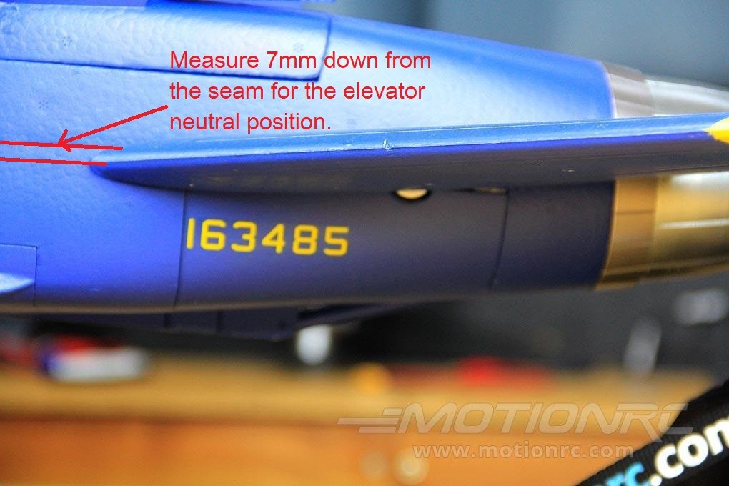

      Hi Alpha.. Just a query to confirm that the Elevator neutral is 7mm Down .. The illustration on the manual is tiny & could easily be overlooked .. It should have been larger.. Correct Elevator neutral could save Pilots from Diaper purchases on MaidenLOL

              You should be very clear about what you mean by "down". The picture in the manual is quite vague and is hard to visualize. On my Freewing V1 F-18, it's UP elevator that is the neutral. That means the front edge of the elevator next to the fuse points DOWN from the plane's mid-line. I'm pretty sure it's the same way with this one. It's also the case with the full flying elevator on the SU-35 and other similar planes. It's UP elevator for neutral trim.

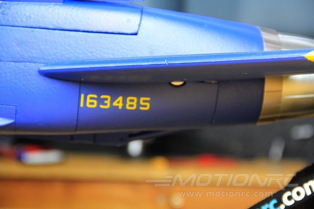

                So I pulled a pic off MRC and looked at the manual, and here's what I figure. I also posted the unedited pic so you can see the seam line.

                  Yup, that's much more clear and makes perfect sense. So, it's UP elevator but DOWN from the seam line (with the front point of the elevator).

                        Thanks Pat.. Those pics definitely takes the confusion right out..:Cool:

                                  How come the neutral position of the elevator needs to be a little up?

                                    Look up chapter ‘incidence and decalage’

                                      Surely if the model needs up elevator to fly straight and level then the wing incidence must be wrong..

                                        Define up elevator? Referencing the leading edge of the elevator from a seam for neutral does not necessarily mean up.

                                          Oh fair enough. If the seem line isn't the centre line or thrust line then cool. Just the way everyone was describing it as up.
