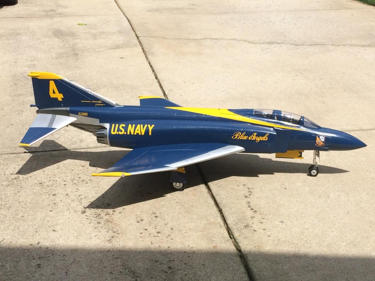

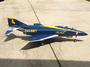

              #606
ID:	196564 Rattle can

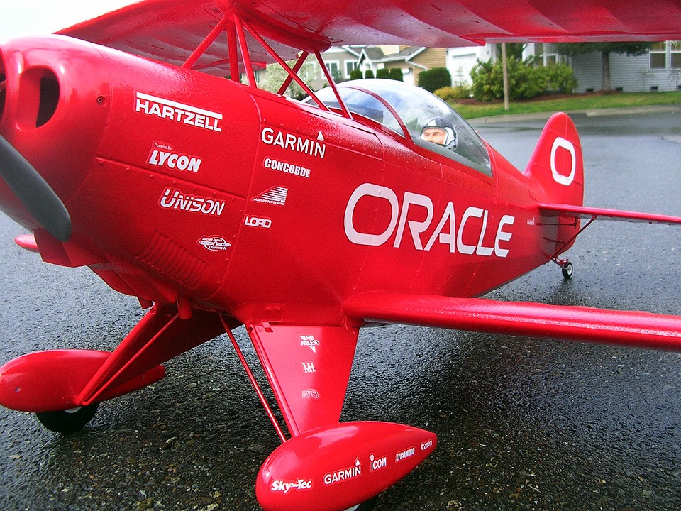

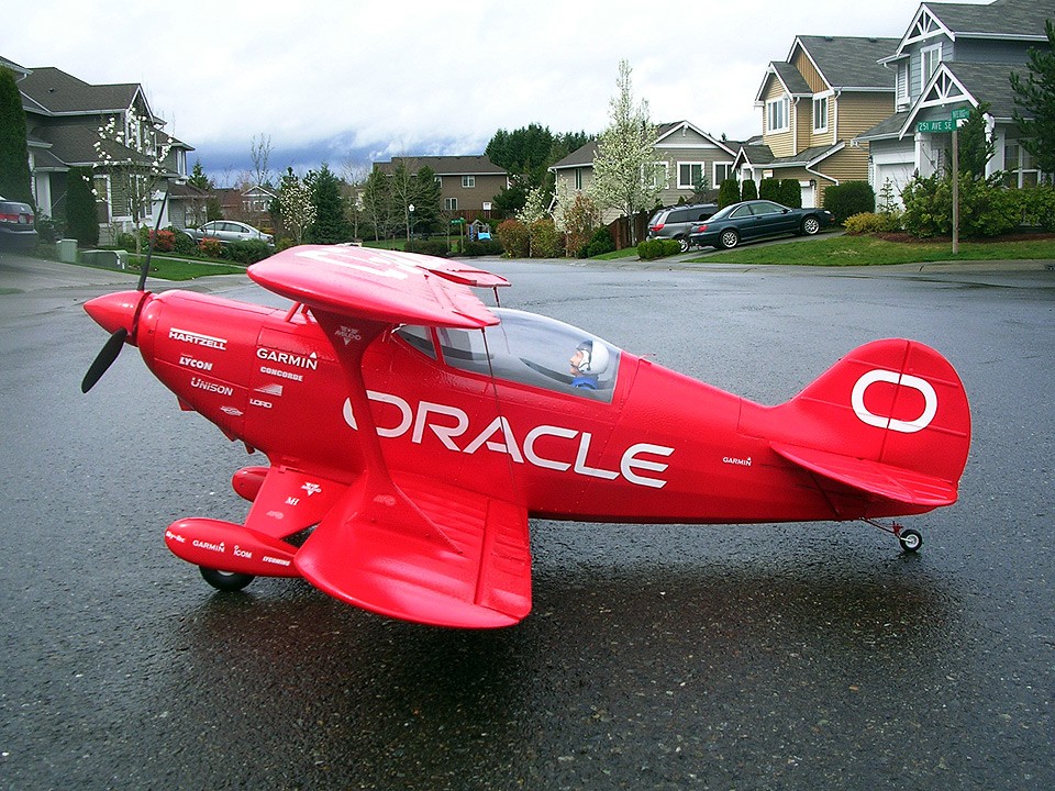

                      I have never once sanded or primed my foam models. Just wipe it down so there's no dust/residue, and that's it. Here's a great example. I painted my FMS 1400 Pitts which was white, this...
