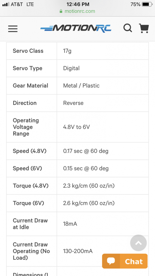

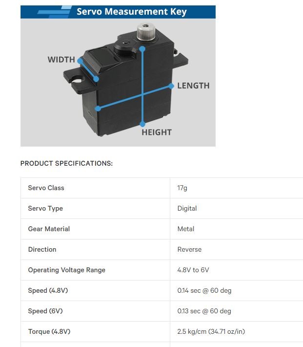

              Don't know if you know this but the factory Freewing 17g Servos make 60oz/in *4.8 volts. While the Hitechs 85mg only make 40oz/in.
              The 17G servo data on our website is WRONG on some of the various wire lengths. The 17G all metal gear servos make 35oz/in at 4.8V NOT 60oz/in. it makes 42oz/in at 6V but I would not use 6V so as not to upset the Blue Box. The Hitec HS-85MG's make 42oz/in at 4.8V and feel great in the elevators!

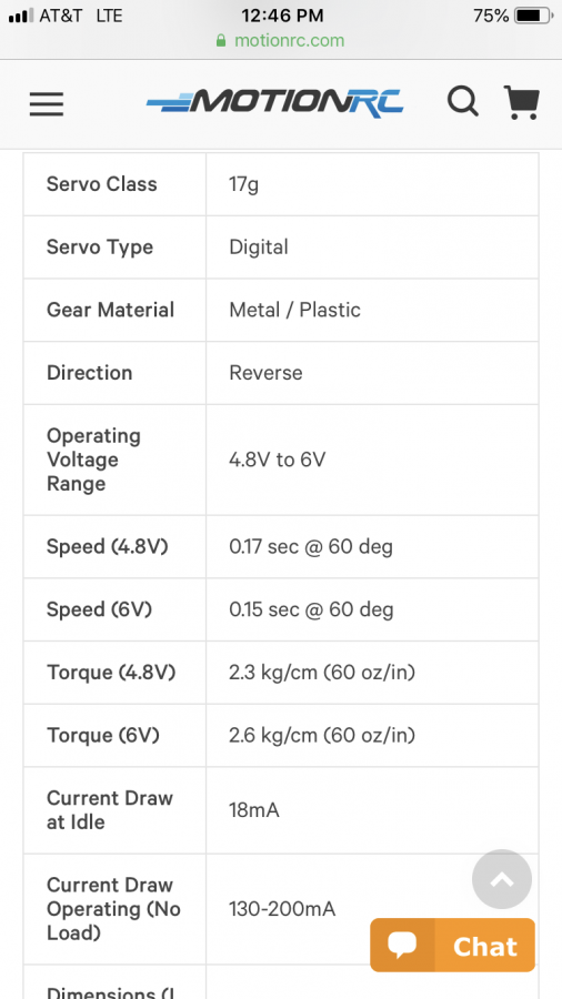

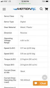

                Click image for larger version Name:	17G.JPG Views:	0 Size:	50.7 KB ID:	209054
                Guess the first servo I click on had wrong info then. Lol. I typically buy servos with longest wire as I can make them shorter if/when need be
