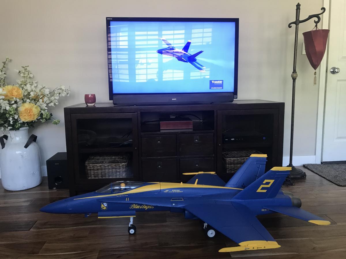

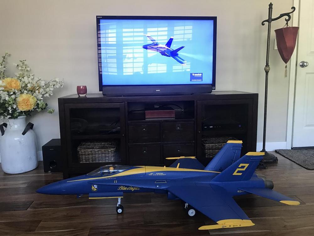

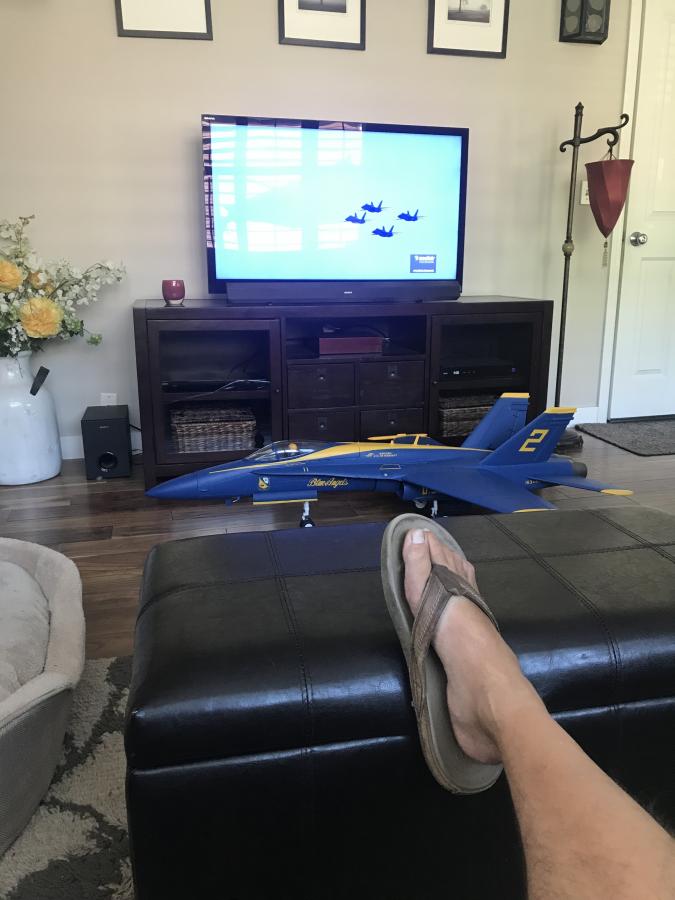

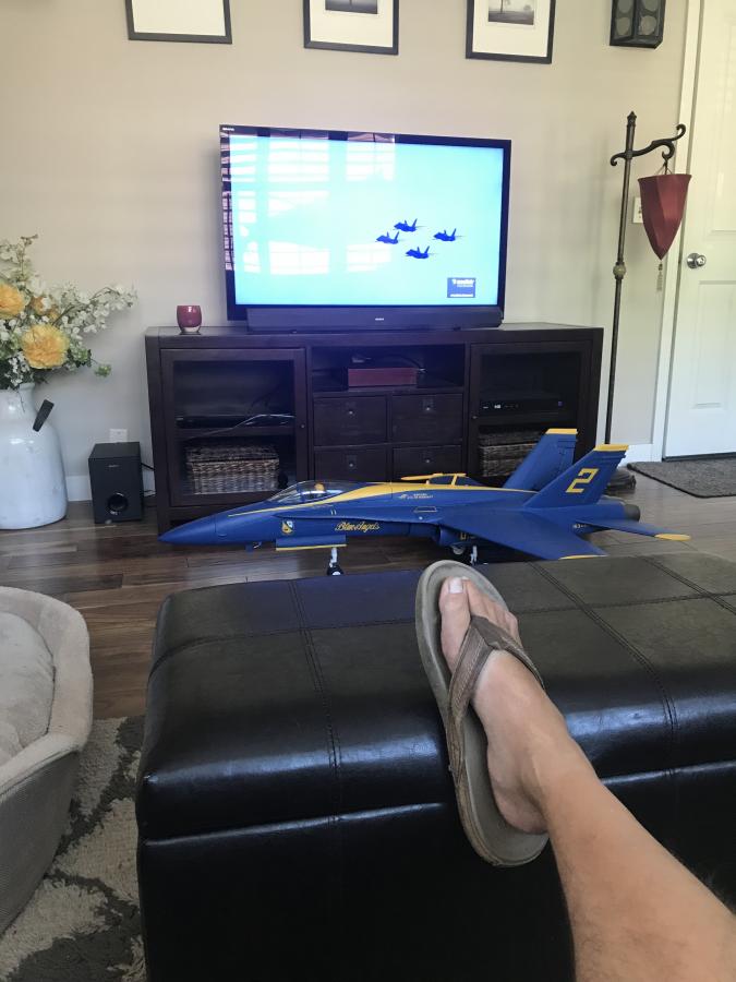

ID:	208944 Watching Seafair an annual tradition in Seattle for 70 years. Unlimited hydro racing with the stars of the show being the Blue Angels airshow. NERD ALERT: The only thing cooler than watching the Blues on TV is my Blue Angel as the center piece!
                    My my wife is not impressed LOL
