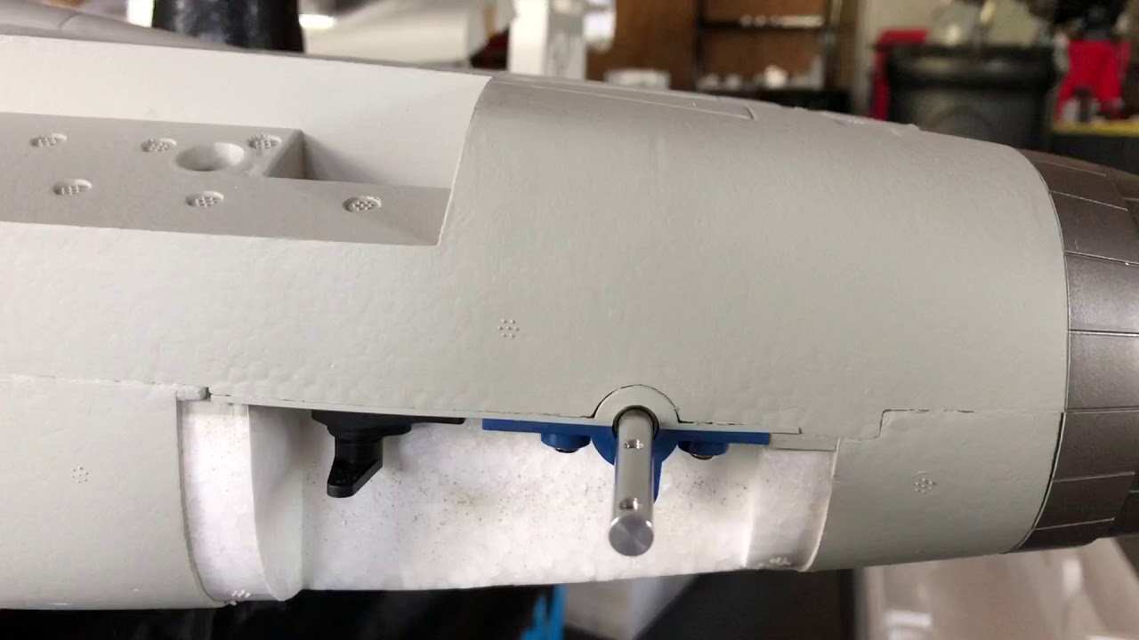

    Guys, Freewing warranty the first F-18. Got the new one Friday, just started to mess with it together. Comparing the bulletin pictures, this doesn't seem bad. While it's not good, I did take a small ca applicator tip and push as much foam tac as I could until it oozed out. After words, I though "why not use epxoy dummy.." Thoughts? Foam tac is still setting up.

      TG65, I have found that sometimes the "Foam-Tac" will soften some plastic parts if those are not exposed to air to evaporate the solvent. It takes as much as a couple of hours before it sets and I have no clue how long before it cures. Epoxy will attach itself to the foam, no doubt, though will it stay attached to the 'smooth' plastic under load? I think "Foam-Tac" is the call here and will use that if I have the same issue with the elevator mounts. Best, LB

        I used epoxy for mine and so far so good...But as LB says Foam-Tac would work well too.

          I've really been sold on Hysol (Loctite 9460) lately for major repairs or for areas where I need a very strong bond. Works just like epoxy but has a long working time. It takes 24 hours to cure, but it works wonders and sticks to anything.

            We sell a version of this but from Master Builder. Masonry guys here on the east cost use it to fill concrete/mortar joints and achor down wedge bolts. Great stuff.
            Figure the biggest paint in the butt is removing the old glue, I rather not take bracket out. This is, if the foam tac doesn't firm up like I want it/need it to.

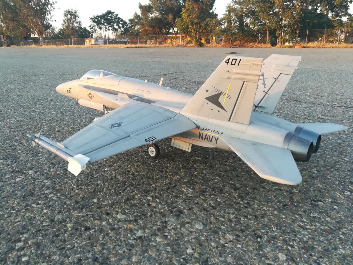

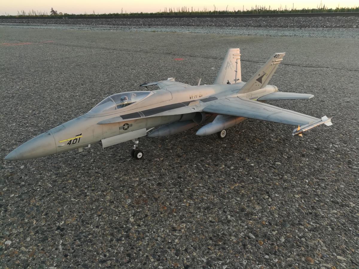

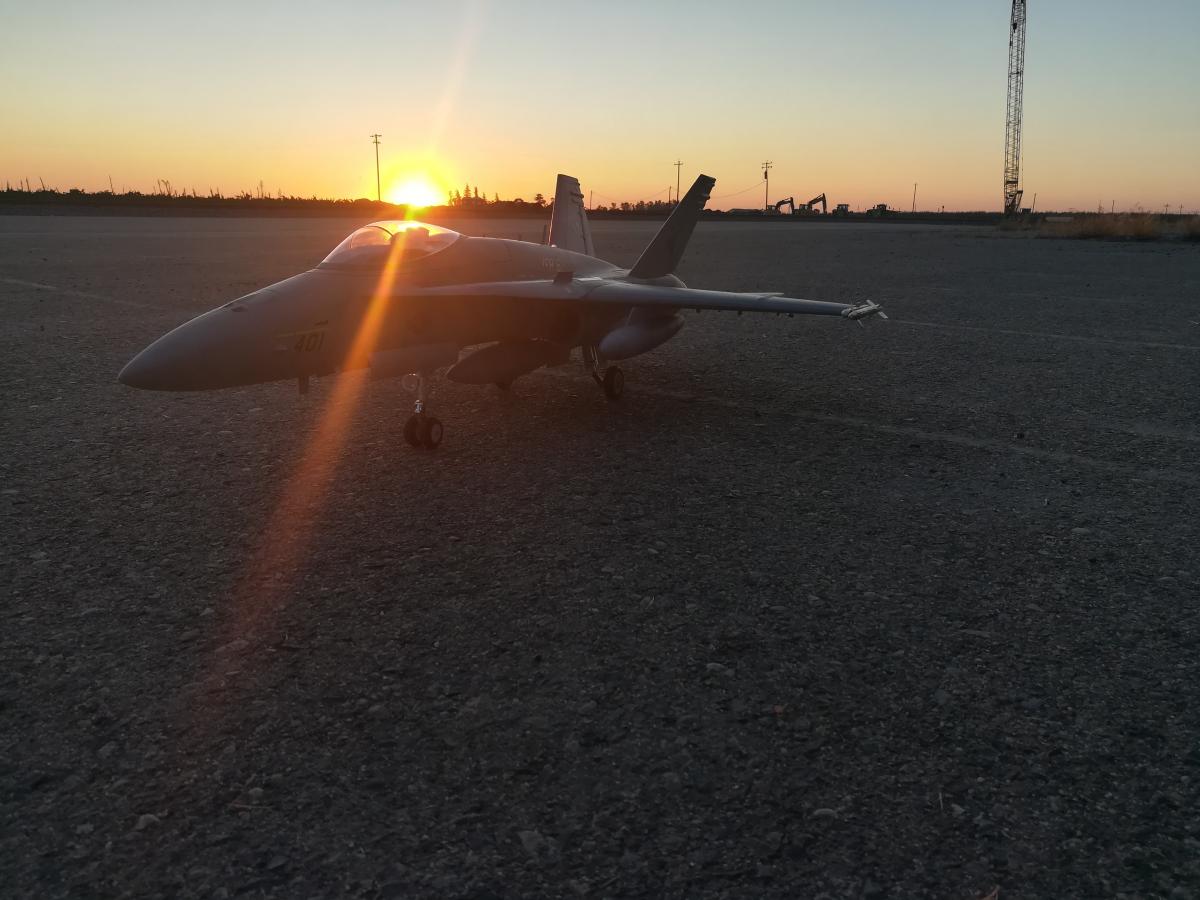

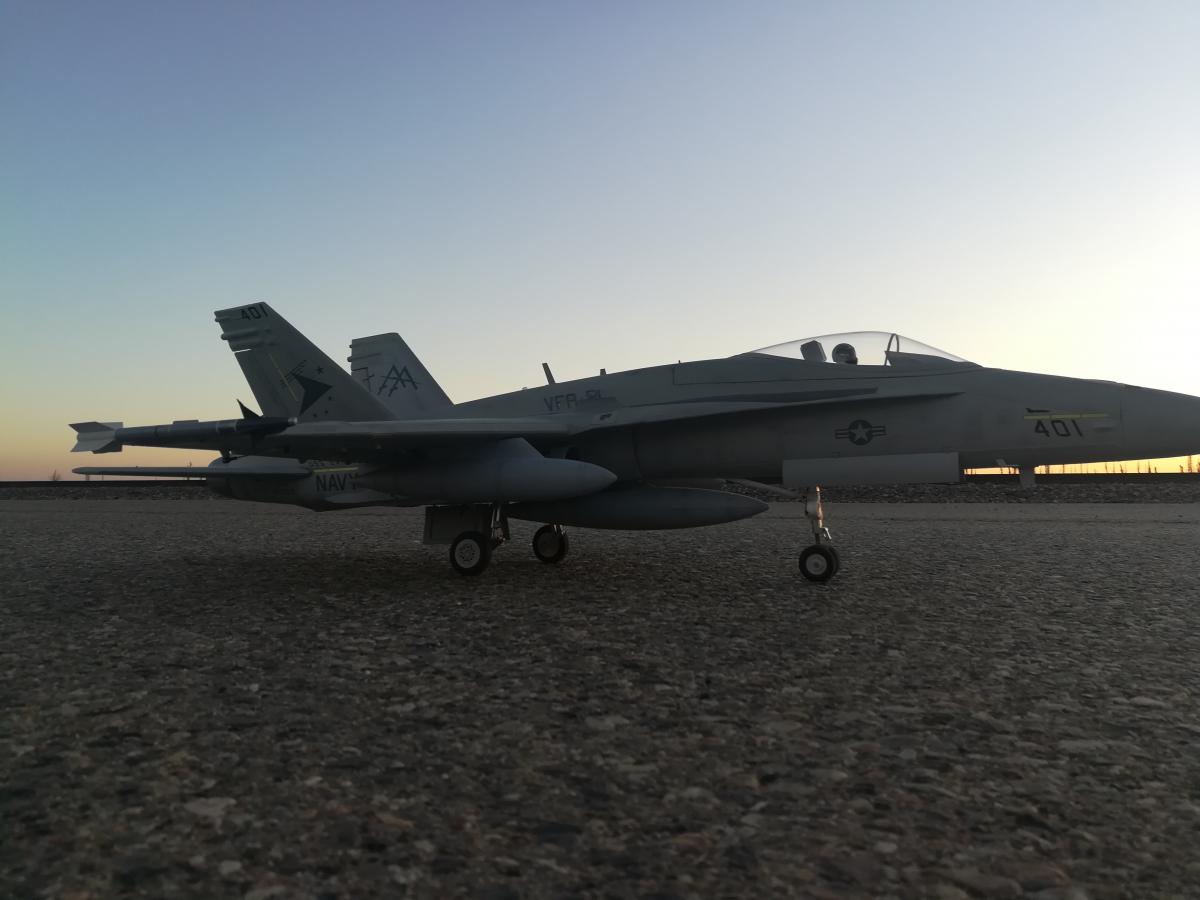

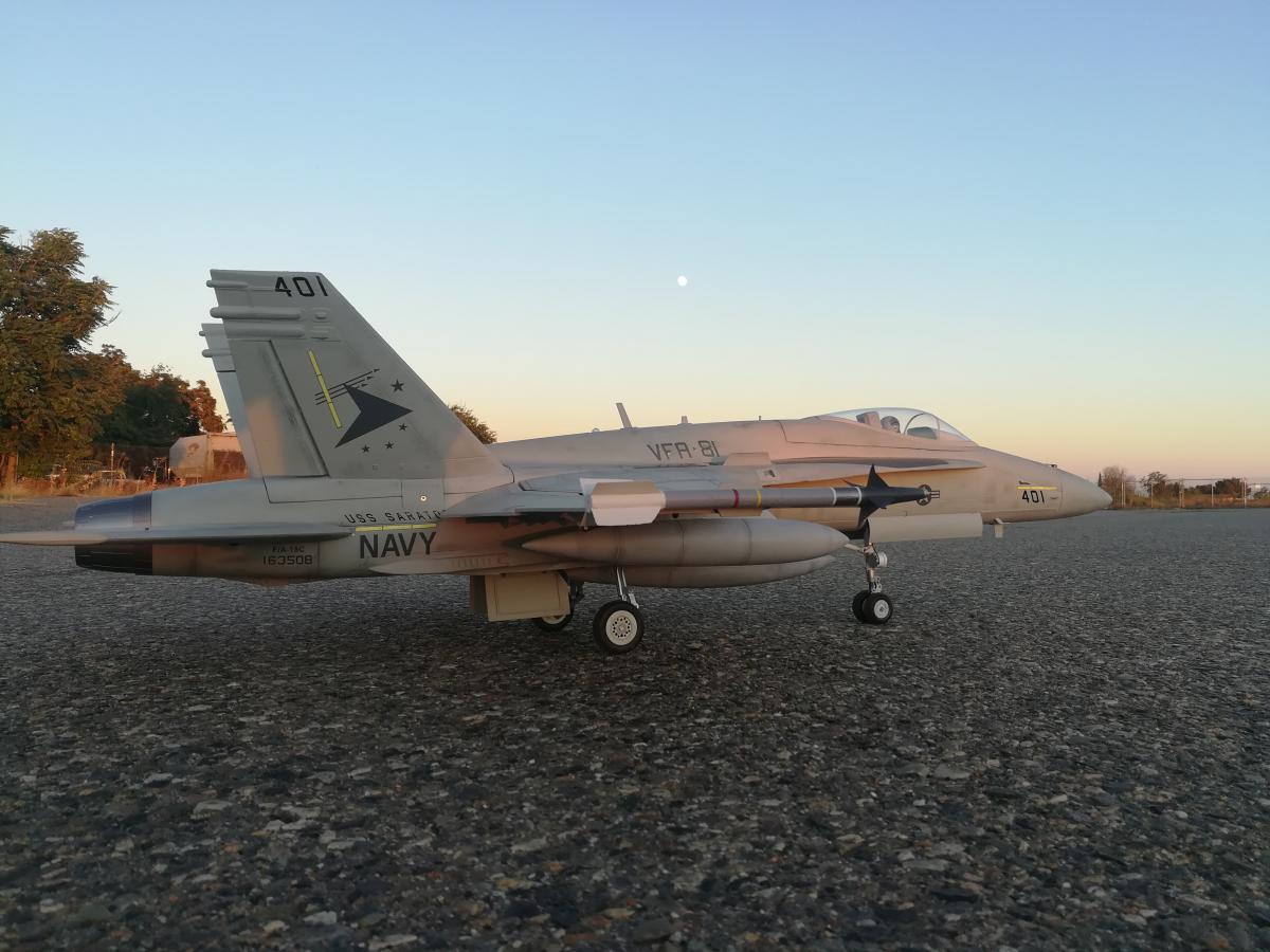

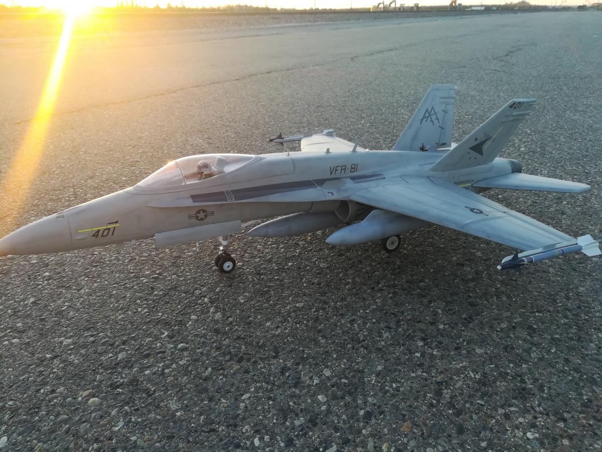

              Got some cool shots tonight as the sun was setting, just phone pics but you can see its light at first, then as the sun was setting, now the only thing left to do is paint my struts and maybe something about the blah cockpit.

                    DC, Great Pics! Wow. Thanks. Best, LB

                                        Just slowly putting my 2nd one together. Foam tac are holding the brackets in very well. Now just need to replace the servos and put it all together. Not going to paint it or put the stickers on it until it has a few flights.
