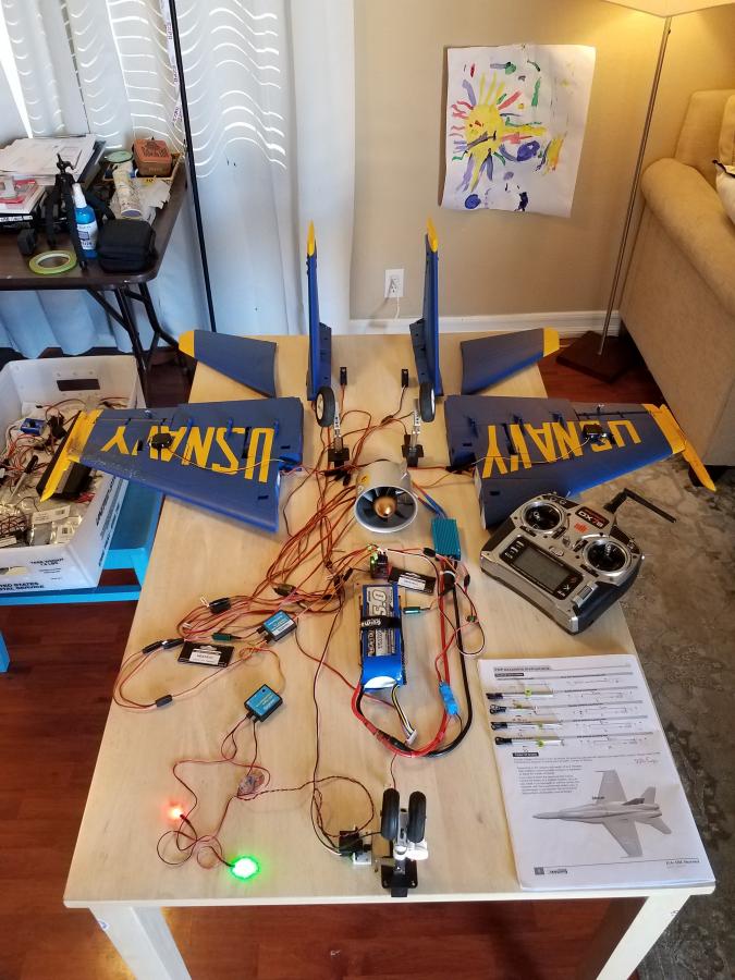

                • Hey guys,
                  I am working on my bird and I am going to bypass the blue box - not because I do not trust it (although it is hard) but to be able to control each servo separately.
                  I was wondering on how you did the bypass for the wings? Did you completely get rid of the wing connectors? I am thinking about keeping the cables and soldering servo plugs on it. Any tips/advices?

                          Jens,
                          The ribbon cables from the wing share a common ground, so you will need to remove it (and the connector board in the wing) completely and run servo extensions to all plugs and run them direct to your receiver.

                            I just removed those and used regular extensions... Plenty of room for the to go through when you remove the plug from the wing. Just regular servo plugs on the back side of the ribbon cable plug
                            • As others have said I removed the interconnection boards and their interconnection wires and ran individual extensions. Each servo got plugged into a separate receiver slot on a 12ch receiver.

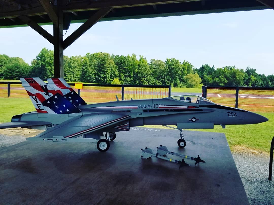

                                      • Got to redeem my pilot error maiden on my customer base gray F-18 yesterday. Was so happy to finally this beautiful VMFA-115 Silver Eagles scheme in the air! I recently bought a scale and weighed all the 3d printed ordnance I had created for that unsuccessful maiden and all totaled I had an extra 493g of weight and never CG'd it!
                                        Oh well, past is past, excited to keep flying this gorgeous bird!
