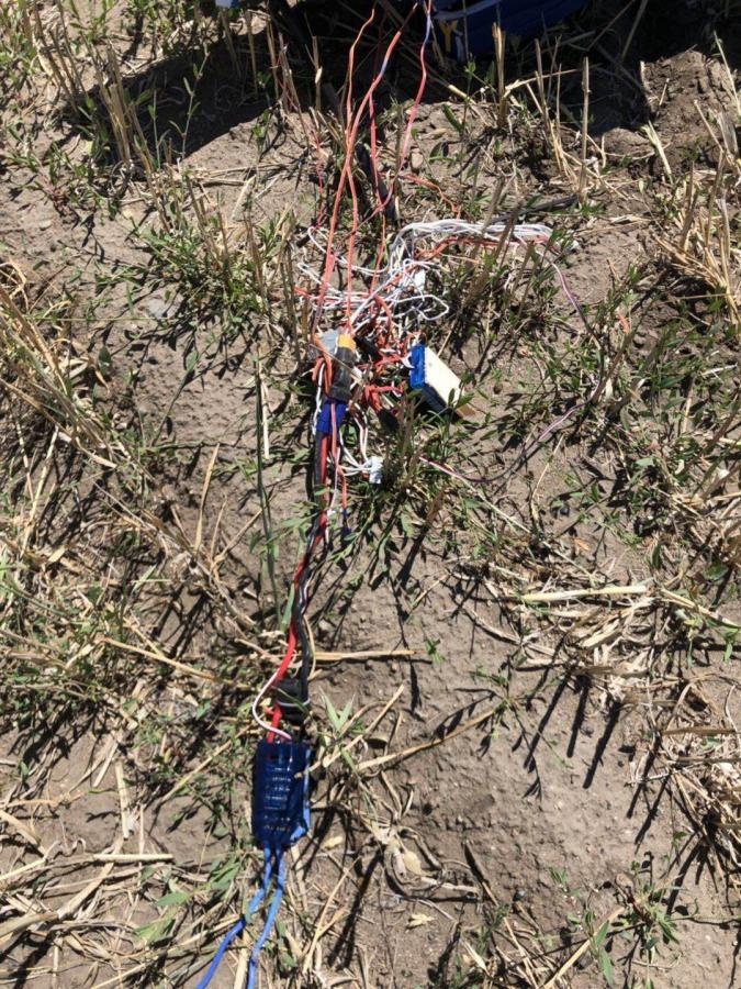

                      Mine is (was) 100% stock out of the box. So here ya go...

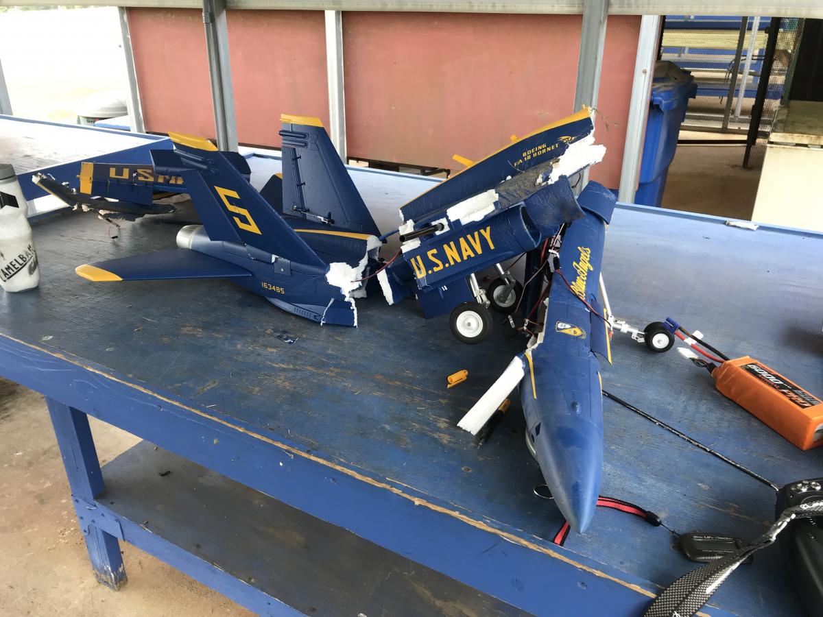

                              My Buddies.
                              100 percent stock. Spiraled in after maiden
                              Take off.

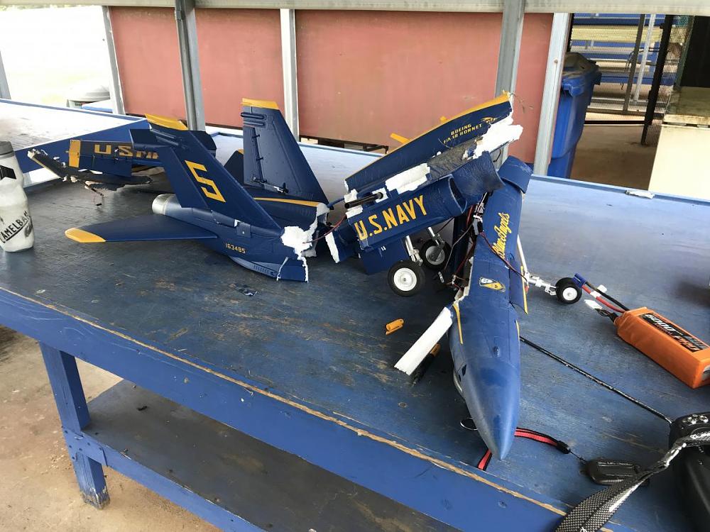

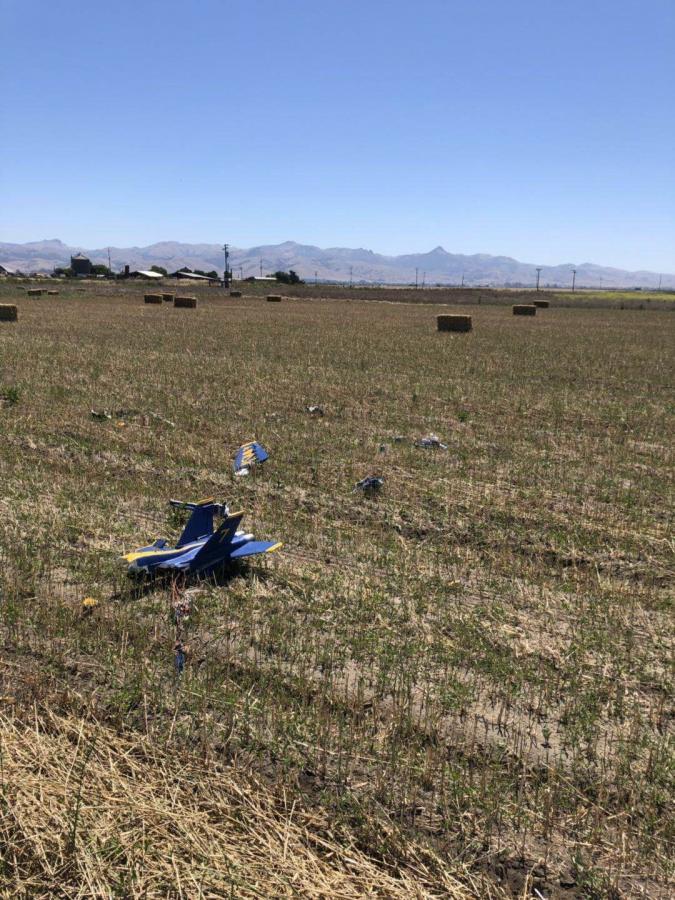

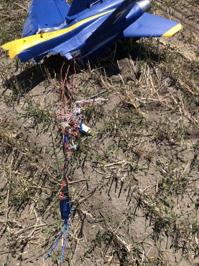

                                        Can’t return that one as new... what happened Curly?
                                        Like others that have been reported. At the 90 in a landing approach, about 45 degrees angle of bank, maybe 10 degrees nose low, just froze up and stopped responding. Drove right into the ground.
                                        Reading all the threads about the blue box, wondering why something as simple as flight controls are routed through it? I may buy another, but I'll bypass the box and go direct from receiver to Elevator, Aileron, flaps, Rudder.
                                        But if the blue box fails will it cut power to the receiver??
                                          • 5401
                                          #2520
                                          Good question... I could easily see a shorted retract affecting things connected to the MCBe. So you are thinking a blue box issue, not servos, BEC or receiver shading by the battery or other reception possibilities?
