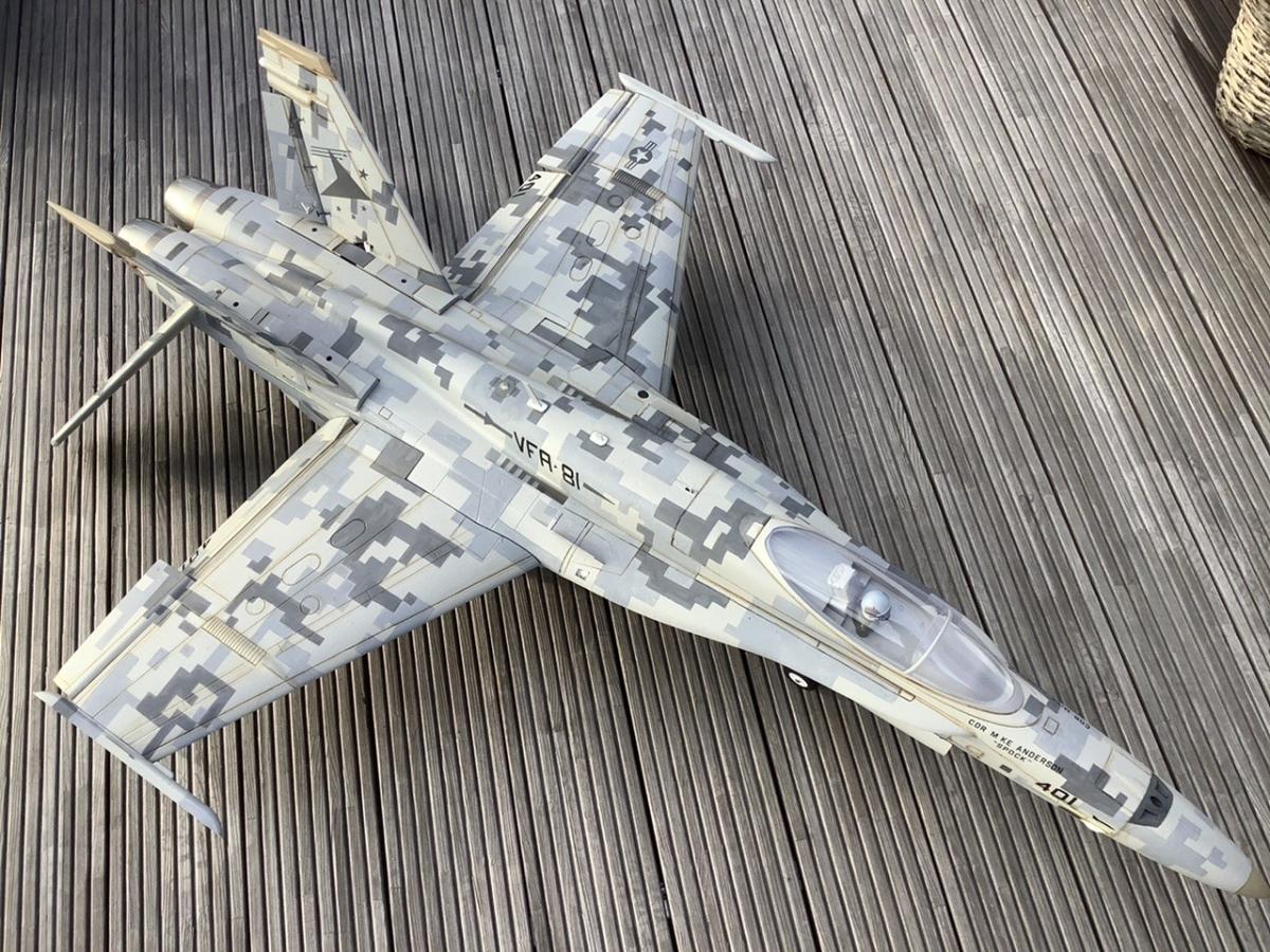

        Hi, the gloss looks very fine. You no longer expect a foam plane :)
        Here is mine. Today I started the first weathering effects.
        Looks awesome! I can see where time and patience is certainly needed!

          • Originally posted by Polyphren View Post
            That's so dope!
            Probably top 3 custom-livery favourite Hornets seen to date (personal opinion).
            I'm really missing the black cockpit though...
