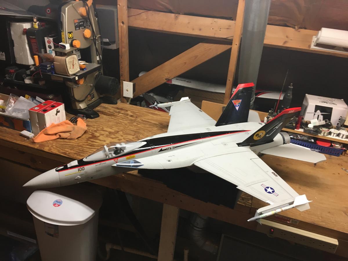

    Hello Hornet Howners, got my VFA-41 Black Aces F-18C on her feet for the first time. I could not resist dry fitting everything just to have a look, and I like it. Now it's on to fill-in/touch up paint, placing the remaining nomenclature and markings, attaching final 3DP bits, clear coats and 'weathering'. Best, LB
    OMG, that is THE SINGLE most outstanding re-do I've ever seen. All your mods are incredible, including the operating arresting hook, LED lighting, cockpit, and on and on. Even the details on the INSIDE of the gear doors. Can't wait for your flight report with that 12 blade 1835 Kv inrunner, I think you'll love it. Were you able to get the CG where you want it without adding any lead? You keep setting the bar so high that the rest of us need binoculars just to see it!

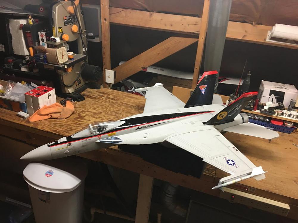

            Bravo ZULU , Sir
            fantastic job. Cockpit look beautiful.
                  Hugh, I don't have any clue on CG yet. I had to throw a couple TX packs into the battery bay to keep her from sitting on her nozzles for the pictures. So that's encouraging, I think. The 12 blade Inrunner is heavier than the OEM EDF by 5 ounces if memory serves. I want to try and route most of the wiring beneath the battery tray and hope that might give me better options on battery placement without adding the dreaded lead. We will see. First check flight will be interesting. Hugh, thank you for the compliment, means a lot. Best to you and yours, Steve

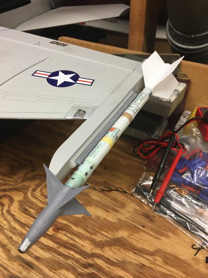

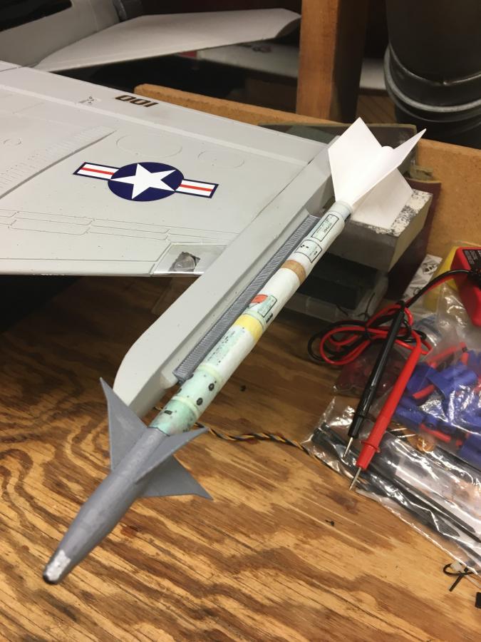

                                    • I'm not sure how many of you also had the earlier F/A-18E with thrust vectoring, either the V1 or 2 (the second had upgraded landing gear, flaps and bolt on wings).
                                      I got a lead on an older V1 nib and this is it ready to maiden. The old 6b outrunner that made 1580W was pulled out and the 9B, ESC and BEC out of the current F-18C put in (2500W) put in. I also swapped in the V2's better gear, stabs and stab mounting also with the more current FW ball links and swapped the old 9g servos with newer FW digital mg's. And Suko’s sidewinders.
                                      End product is 920g lighter than the F-18C, two POUNDs.
                                      And TV's! Click image for larger version

                                        ED, Very Cool Indeed. Best, LB
