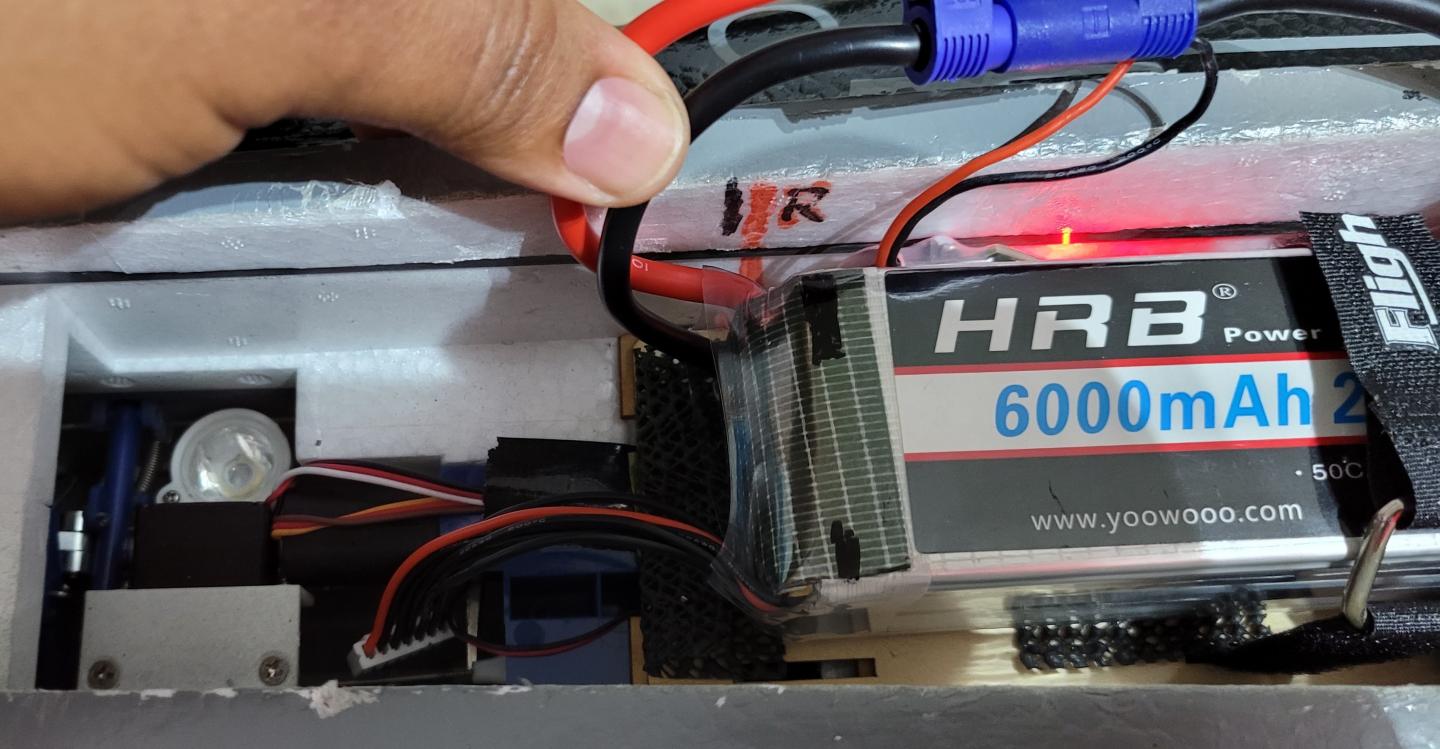

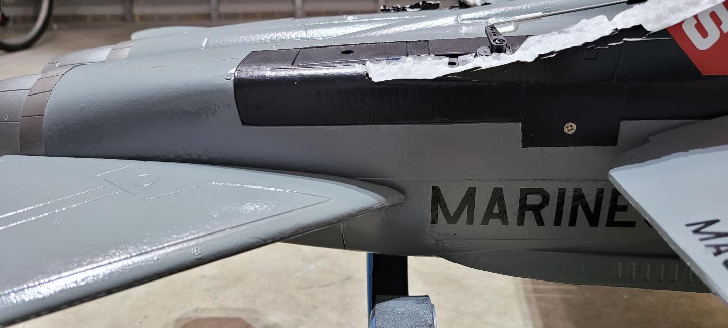

              #4366
              Here are the photos of the battery on it's CG position and the elevator at neutral.

                  Is the leading edge of the elevator at the 2mm below the fuse line as shown in the instructions? Mechanical positive deflection of the elevator is a must. I did the maiden on the 90mm HD Blue Angels and no issues with taking off with 100' run no flaps. Flew well. My battery is set back 1" back from the front of the nose gear motor casing, cg at 98mm.

                                Well, from the photo it's almost certain that you're nose heavy. That battery is too heavy to be that far forward unless your aircraft is unique.
                                Your elevator deflection at rest doesn't look terrible in that position with a more neutral CG, but you could use some additional up elevator dialed in vs. what you have there being very nose heavy. I have about that much "up" elevator dialed in on mine at a CG of ~105mm and mine's not quite neutrally balanced (i.e. still a touch nose heavy).
                                My expectation is that with your current battery and it's length, unless you've relocated the blue box you could basically push it all the way back until it hits the MCB and still be a bit nose heavy for CG. I'm guessing the best you'll be able to do for CG with the MCB in the stock location is something in the mid-90mm range at that battery length and weight.
                                You've painted the plane, obviously. Did you weigh and balance the plane after painting? It sometimes can add a lot of weight and will change your balance as well. House paint (i.e. latex) is very heavy, for instance.
                                One thing I'll say is that this plane should take off very easily, even on grass, unless your cheater or fan is plugged. Mine rotates in the shortest distance of my two 90mms and does so very easily, especially if the nose gets bouncing (higher AoA). Granted, I'm using takeoff flaps, but even clean it gets off the ground quickly and easily with very little back pressure on the stick required.

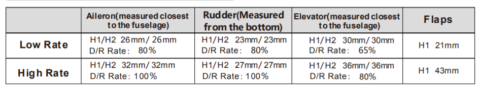

                                        This is a picture of my high rates. Plane doesn't need this to take off or land. I usually use mid rates or even low.
                                        I've never measured them, but sometimes a picture is worth 1000 words. Apologies in advance for the bad lighting.
                                          I'm using everything based on the book! Can you post a picture of you battery placement?
