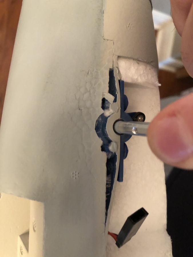

    Make sure you check the elevator servos. The right one crapped out as evidence by the video. Only one flight as I just finished it. Send me a link for the scale cockpit. Thanks
          https://photos.app.goo.gl/J1CseiG7kVRk4k3L9
          I had the same issue with mine a few flights in where it would twitch like that on one of my elevator servos. Motion sent me replacement for them quickly.
          When I checked my servos, the one that was doing it had some significant cuts in the servo wires and both had some cuts. Might be coincidental, but was good that it caused me to pull them and check. Might want to pull yours out and check them, it's a tight squeeze to get them in there with some sharp corners that aren't kind on the servo wire insulation if you try to force them into the hole.
          Also, while you're in there look for any separation in the glue joint around the elevator pivot arms and hold down bracket if you've flown it a few times. Something like this will only get worse and cause a crash if not repaired. It's hard to see this joint if you have the elevator half installed.

            Really pushed on mine and are solid. It would be very difficult to have it separate on mine. Since mine is newer I believe they fixed that problem.
              Mine is about 2 weeks old...
              I pushed on mine pretty good before flying it too. Pretty hard to measure 5-6 lbs. of force, but I wasn't gentle.
              I had similar servo issues as you also. If you pull them and find cuts in the wires too, while it might be purely coincidental, I'd keep and eye on these.
              One odd flight behavior I saw was that the nose was slightly delayed in rotating in maneuvers, then caught up and "snapped" through. If you start seeing something similar, look to these.

                I just built one a week and a half ago and it was fine, both the stab mount and wires. That said you may have received it two weeks (or whatever) ago but you have no idea of when the factory put it together.
                  No, I don't know for sure. I do have the 1900kv motor, so I'd suspect it was assembled "recently" given that motor wasn't available on earlier production runs.
                  What you say might be true, could be "new old stock" but in my line of work, we'd pull any items with an issue like this one and correct them before shipping them out. In the end, it would be less expensive.
