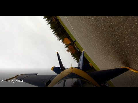

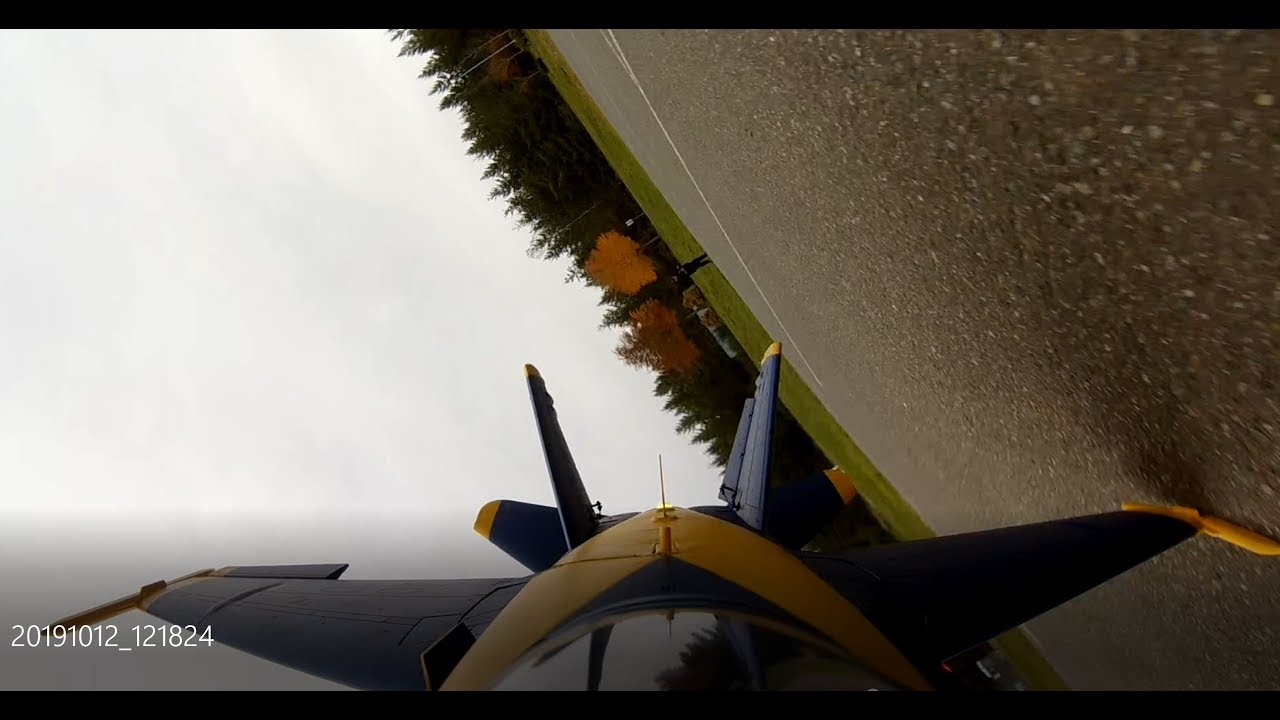

        • Dagnabbin' son-of-a-flubbin' dirty crosswind-havin'....
          • Any real damage? Looks like you almost had her landed.
            • Just cosmetic thankfully. Both tops of the VStabs took the brunt of the impact so I will probably just replace those. Canopy is scratched pretty good so might replace that too...Other than that some knicks on the nose and front of the fuse that can easily be painted over. Definitely better than having the gear get destroyed that's for sure.
              • Mine did the exact same on like the third flight. A perfect bounce. flip, three point landing... inverted.

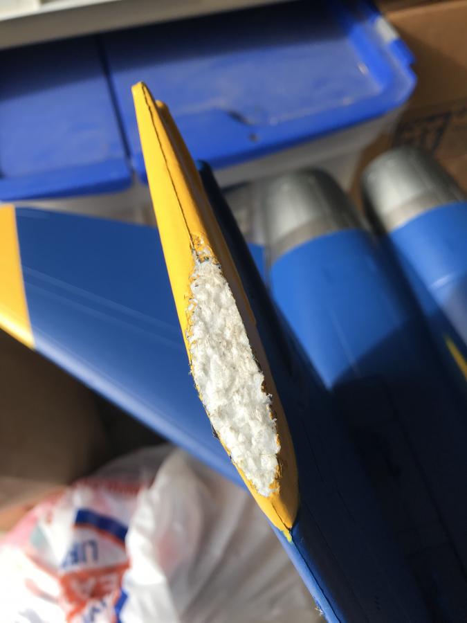

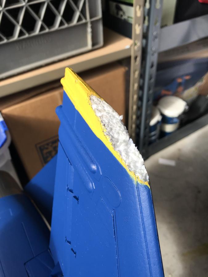

                  • So after my flip over it really took a substantial amount out of the top LE of the Vstabs thanks to the pavement. I am trying to think the best route to go as far as repairs. Would love to hear anyone’s thoughts. I am thinking adding foam and sculpting, sanding and painting...Any ideas?
                    • Perhaps something along the lines of "caps" - sculpt or 3-D print the forward corners of the vertical tails, then vacuum-mold plastic sheet for something to ablate before taking out the foam. But that would be a longer-term solution.
                      For an immediate fix, could make a plastic former (like they do with concrete) fitted along the forward corners, then fill with foam filler or epoxy mixed with micro beads, smoothing out the top before it sets. Then sand, apply filler, sand again, then paint.
                      • Originally posted by Aros View Post
                        Awe man, sorry to hear about the flip. The good thing is it looks like the damage is really minimal.
                        If it were me, I'd use a piece of sandable foam (not EPO, ha-ha) glued in place (after I slice just a bit below the frayed damaged foam with a new hobby knife to ensure a clean and non-frayed foam surface to work from), reshape it to fit via sanding, then use balsa filler and sand to shape, and finish it with a repaint. Some steps sometimes require repeating. More balsa filler brands and types has sanded better for me than most spackle type fillers. Many lightweight spackles (even the non latex ones) I find sand only decent, and the texture isn't quite as smooth as I like. That's just one opinion though, and it's likely worth less than 2 cents.
                        • Thanks for the info gents! Some good stuff here!
                          • I just bought new stabs...

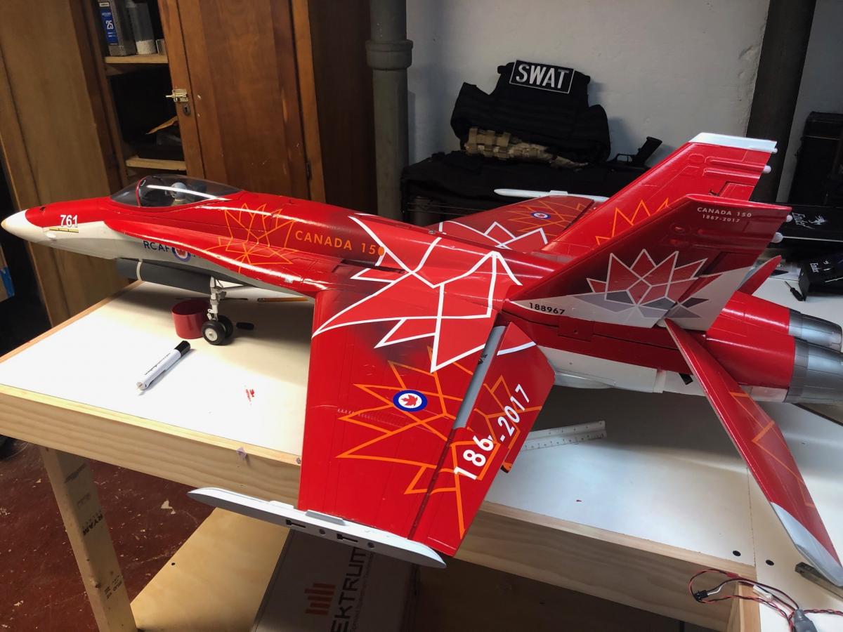

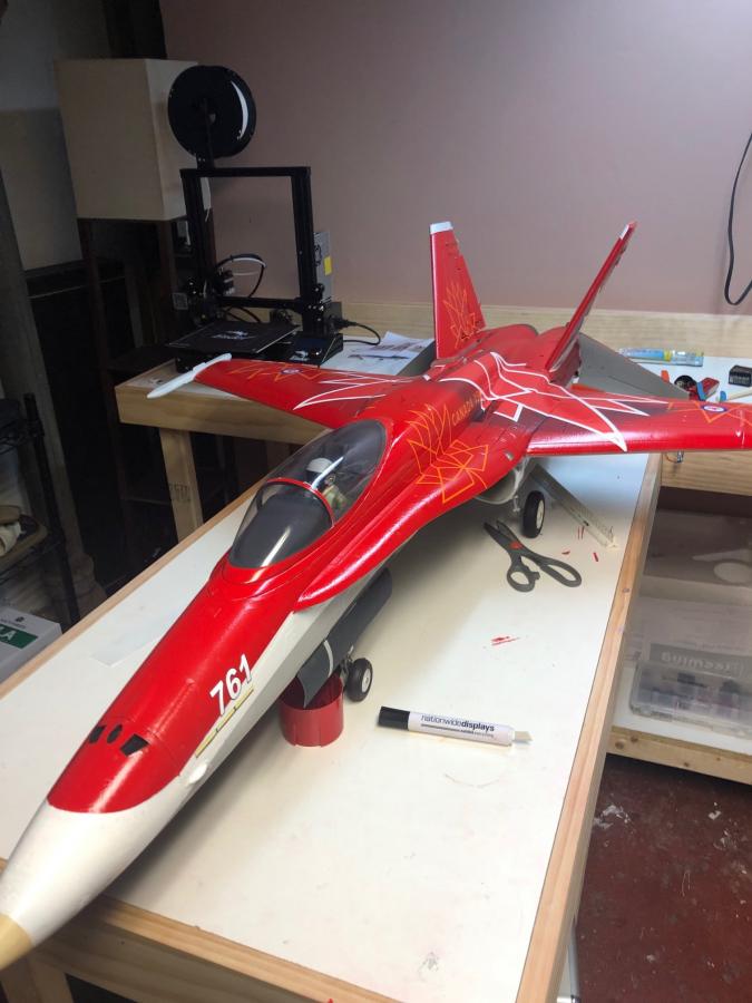

                                • Almost done! - I screwed up the large graphic on the top of the plane.. (it stuck down before I was ready, got committed on placement) - Looks pretty nice tho.. now onto the wiring and final assembly!Click image for larger version
                                  • That looks nice!
                                    Freewing A10, F4, F22, Sebart Avanti S mini
                                    • Originally posted by rcSpanky View Post
                                      Almost done!]
                                      RCS, Lookin' good. Truly nice work. Bravo Zulu, Sir. Best, LB
