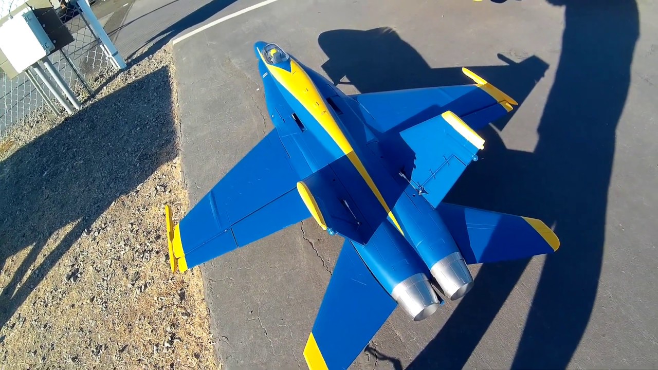

                    Anyone record thier top speed? I got 81mph so far. Heres a quick hatcam vid with carrier landing.

                      81mph seems pretty low for this one!

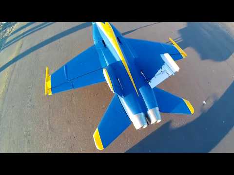

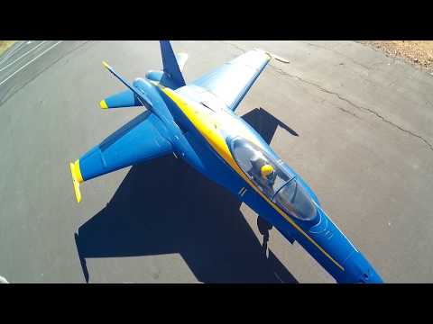

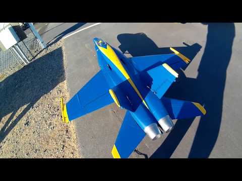

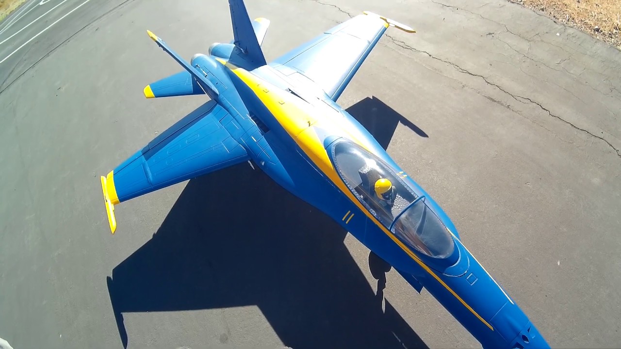

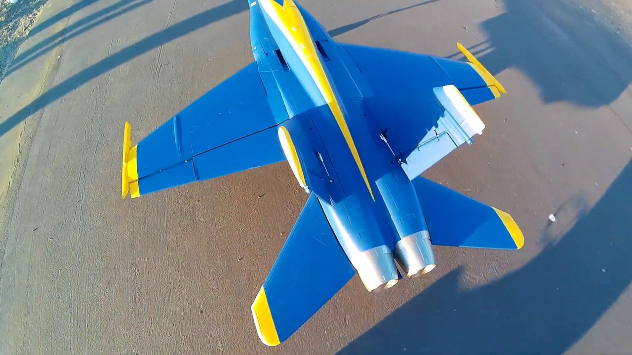

                          hat cam video haters... look away... but here are my flights from sunday...

                              145mph but I’m on 8s
